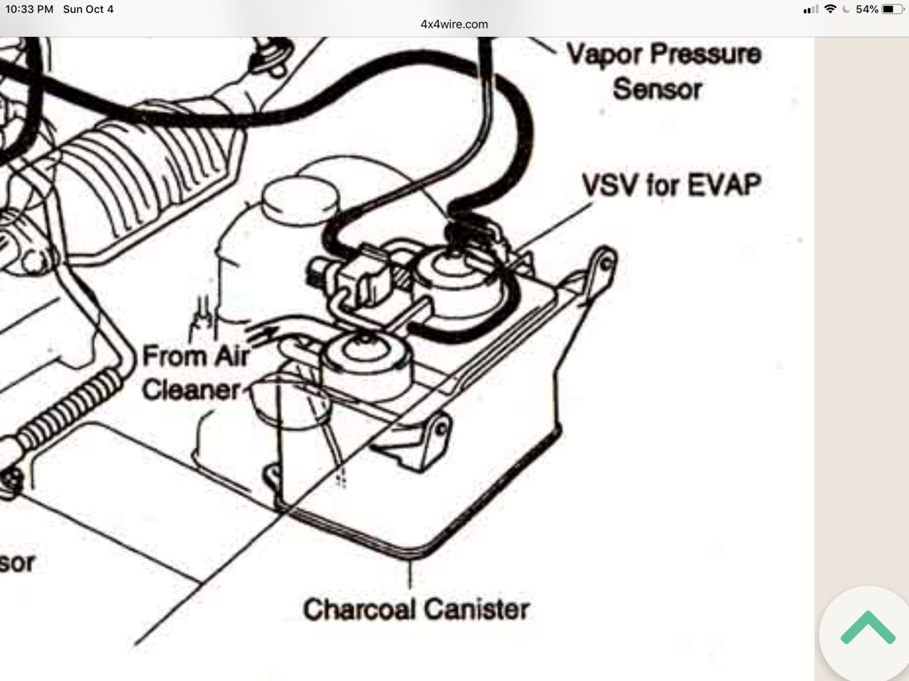

    Hey i have a question about vacuum hose routing with the 1st gen (gray) supercharger. How did you guys plumb in the VSV that goes to the power steering? I have another VSV that was previously mounted on the back (towards the cab) on the upper plenum? And then there is a vacuum connection on the charger right after the throttle body? Pics would appreciated! @1997tacomav6 Ill tag you since i know you have a 1st gen charger and a ton of knowledge on this stuff :)

    I will check tomorrow, BUT I have an EGR setup so mine might be different.
    Is this the valve you are talking about by the canister

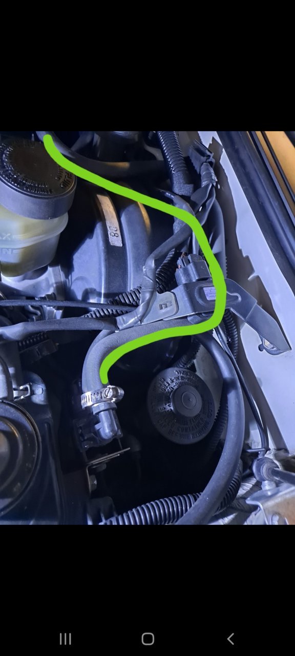

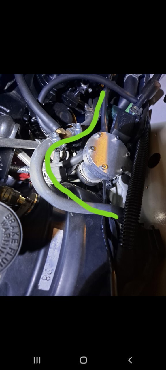

    Here is the vsv hose to the supercharger.
    There are two metal tube in the back of the supercharger.
    One goes as shown from the VSV to the one metal tube facing the VSV.

    Is that an FMU?

    Yes,
    ITS the fuel regulator that came with the supercharger originally
