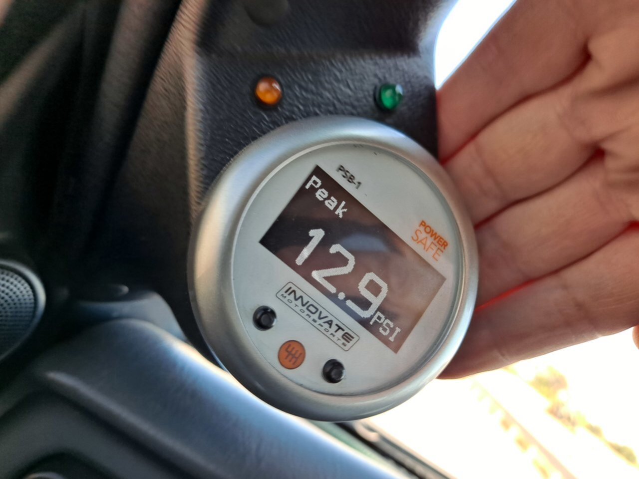

  6. Nov 15, 2020 at 2:59 PM
    #2646
    btu44
    btu44 Well-Known Member
    Sep 7, 2016
    #196732
    330
    Long Beach area, Ca
    04 Tacoma Double Cab, 4WD, TRD Off-Road
    SC with 7th injector. ICON 2.5 shocks and coil overs, SPC UCA, EMU Dakar rear springs. FrontRunner bed rack. ICOM IC7100 amateur transceiver
    A few question for the long term supercharger users.
    What kind of life are you getting from your nose seal? I bought a new supercharger with 7th injector from URD. I'm still using the stock 2.37" pulley. The OEM seal started leaking and flinging oil on to the hood at 1970 miles. I replaced the seal with a Vitron seal. Now the Vitron seal has 7000 miles on it and is weeping oil but not flinging. This doesn't seem right???
    Should I carry a spare supercharger belt? Or are they as reliable as the other belts?
    I would like install a mechanical boost gauge temporarily. Should I tap into the vac/press line before or after the 7th injectors MAP tube restictor?
    As a side note.
    I have a pretty good 7th injector tune that eliminates almost all of the low rev ping.
    For anyone who is interested in trying it PM me.
    Specs of the tune:
    2004 5VZ-FE with auto. tranny. 2nd gen S/C with 2.37 pulley.
    Tuned for Cali 91 octane at sea level.
    Only small changes to the Fuel Map (B). Increased fuel slightly at the upper revs/boost range.
    Changes to Ignition Map A at 2000 - 3000 RPM and boost from 2 - 3.5 PSI. This is were all my pinging was located. After 3.5 PSI of boost the tranny down shifts and out of the ping range. For this reason this may not be a good tune for a manual transmission.
    1997tacomav6 likes this.
  7. Nov 15, 2020 at 4:58 PM
    #2647
    1997tacomav6
    1997tacomav6 V6 5sp,RegCab,TVS1320 Supercharger,Haltech, 800k
    Oct 5, 2013
    #113940
    10,390
    John
    Denver
    97 reg cab, v6 5sp 300hp supercharged, Methonal Injection, 800,001 plus miles, Original Owner
    V6 5sp,RegCab,TVS1320 Supercharger, 56mm pulley, methanol injected Haltech ECU, AC Tvs1320 supercharger,(MUST DO) every 125,000- 150,000 needs rebuild Projector headlights HID 5 speed manual Amsoil for all drive train Smaller 56mm custom pulley, (MUST DO) 2004 DESNO fuel injectors, zero ping ping, 2004 side door mirrors Dick Cepek Rims, Michelin tires LTX, ATM Pathfinders Dynopro ATM ( that last 100,000 miles) Now running Dynopro ATM mud and snow tires KN cold air intake Cat back dual exhaust with ss exhaust tip, Raised exhaust tail pipe to 2" below body line Optima*dry cell battery,red top Alpine sirius radio, 200 watt amp, focal is165 split door pod speakers Focal door speakers Subwoffer behind seat Viper alarm, Electric Locks Dark tinted windows, bucket seats corbeau lg1 Tacoma Rubber floor mats TRD fender extenders, Bilstien shocks, King shocks JBA UCA trailer iv hitch, electric brake control, Drilled slotted brakes, High carbon steel (MUST DO) EBS green stuff 7000 series pads(MUST DO) TRD engine oil cap TRD stick shift, Marlin crawl shift kit. Rear sliding window 2002 4Runner functional hood scoop cut into Tacoma hood, 4Runner dual overhead map light Gentex Auto dim + Compass + Temp, garage,rearview mirror Snow Methonal kit stage 2 Custom 3 core aluminum radiator Linex bed liner Haltech stand alone ECU, Intake supercharger gauge. Stainless steel brake lines, Custom leather wrapped steering wheel, Haltech stand-alone ECU,
    The nose seal should last 100,000,
    For it to go out 2 times with that few miles there might be a problem with the snout.
    If it’s under warranty I would get a completely new snout setup
    btu44[QUOTED] likes this.

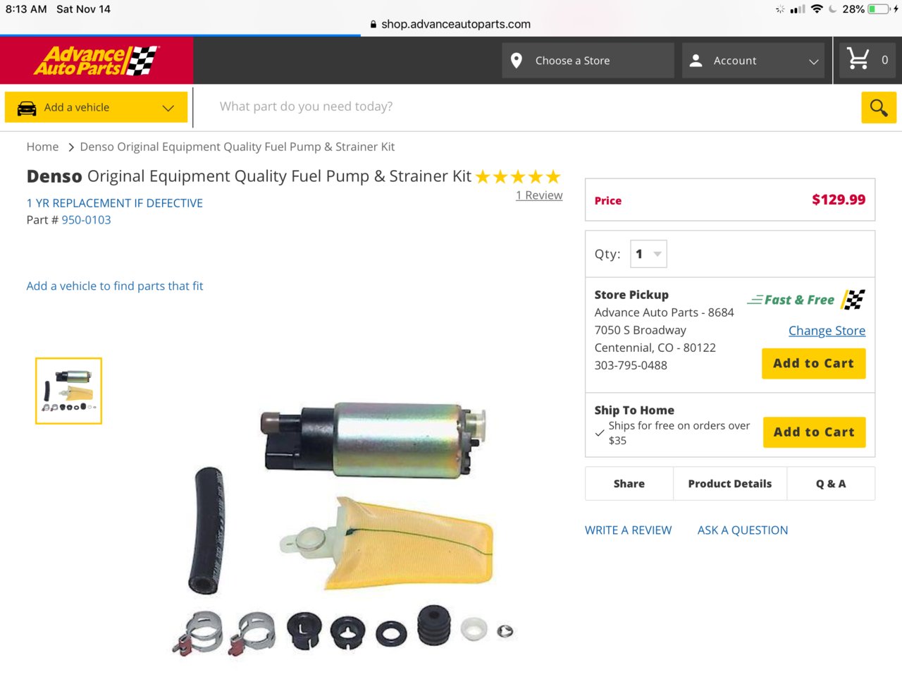

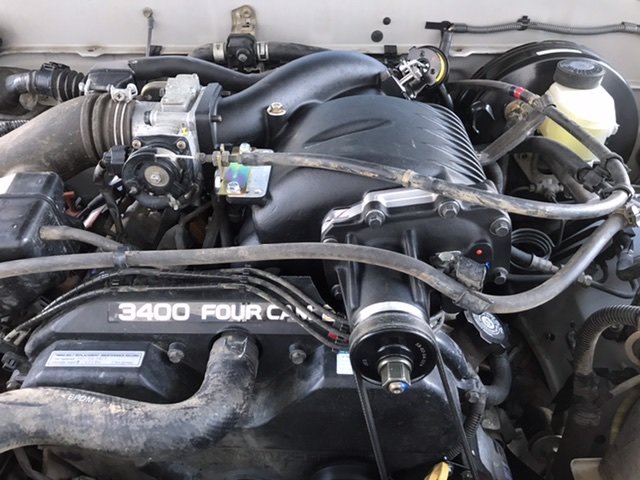

    What is everyone's preference for fuel pumps? I'm currently getting everything lined up for installing a SC and will be replacing my fuel pump, I'm currently planning to use the Deatschwerks DW100 (9-101-1000). I really want to avoid Walbro since everyone says it noisy but have seen some recommendations to stick with the OEM Denso pump. I'm not planning to install a 7th injector currently but will if needed.

    This is what I’m running,Stock DESNO

    Will it support the 7th injector if I find that I need to install it? My only concern with going the Denso route is having to do it twice if I do need the 7th injector.
    1997tacomav6[QUOTED] likes this.

    I run 10 low side 13 high pounds of boost, the methonal route, NOT 7th injector side
    Bigal90[QUOTED] likes this.

    With the 7th it's recommended to run a higher flow pump. But I agree to avoid the Walboro that the URD comes with, mine screams like a stuck pig when it's hot. Has since it was new 3+ years ago, Walboro apparently just claims it's a characteristic of the design. But it's irritating lol.
    I would look at the Aeromotive or Deuschworks (sp?) options

    DW100 is perfect for a 7th setup with 165lph capability.
    I went with the DW200 to replace my walbro. It's not stock quiet but way better than the walbro on warm days.
    digitalferg likes this.

    Thanks! Any issues with running the DW100 and not using a 7th injector?

    Nope, it's a return style system so any unused fuel is sent back to the tank. The 100 is engineered as a stock replacement.
