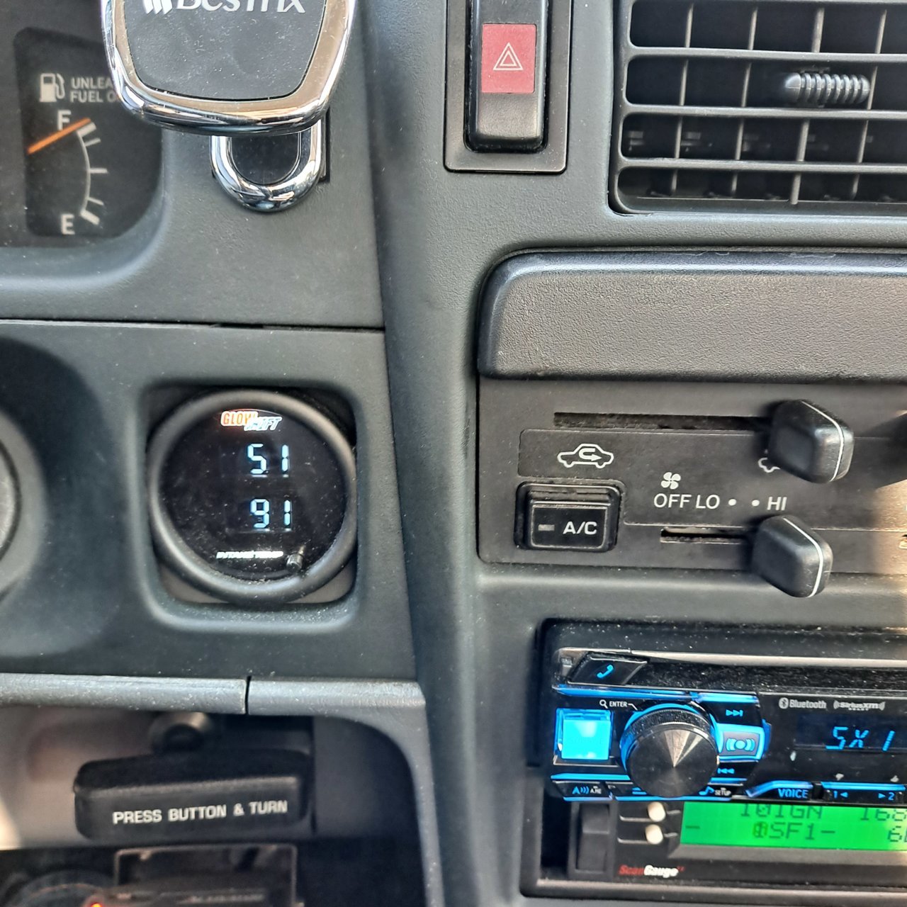

    Input supercharger temperature would be much more useful info,
    Input before supercharger and after the supercharger going into intake
    Summer temperatures, 100-130
    Winter temperatures more like 80-90
