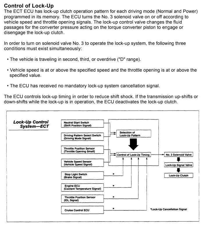

    Look in my sig link for
    Toyota ECT (Transmission Operation).pdf
