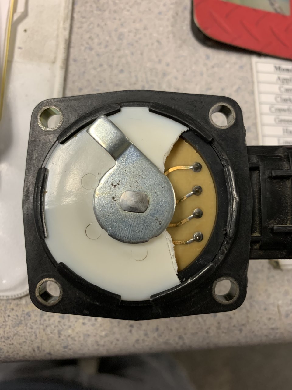

    Nope. No codes when it happens. If it’s lazy and I come to a full stop it comes back and is much more responsive.
    Digging back into the past on other forums fair amount of guys have had it happen after they put the supercharger on. Seems like a new TB fixed it for them.
    But for me it’s doing it again. And it’s so annoying. Ive had the throttle drop out pulling out in front of traffic and while I’m just cruising. Could potentially be dangerous. With warm weather seems to happen more frequently.

    hAVE YOU TRIED TAKING apps OFF AND SQUIRTING SOME ELEC contact cleaner in the hole. sorry about caps

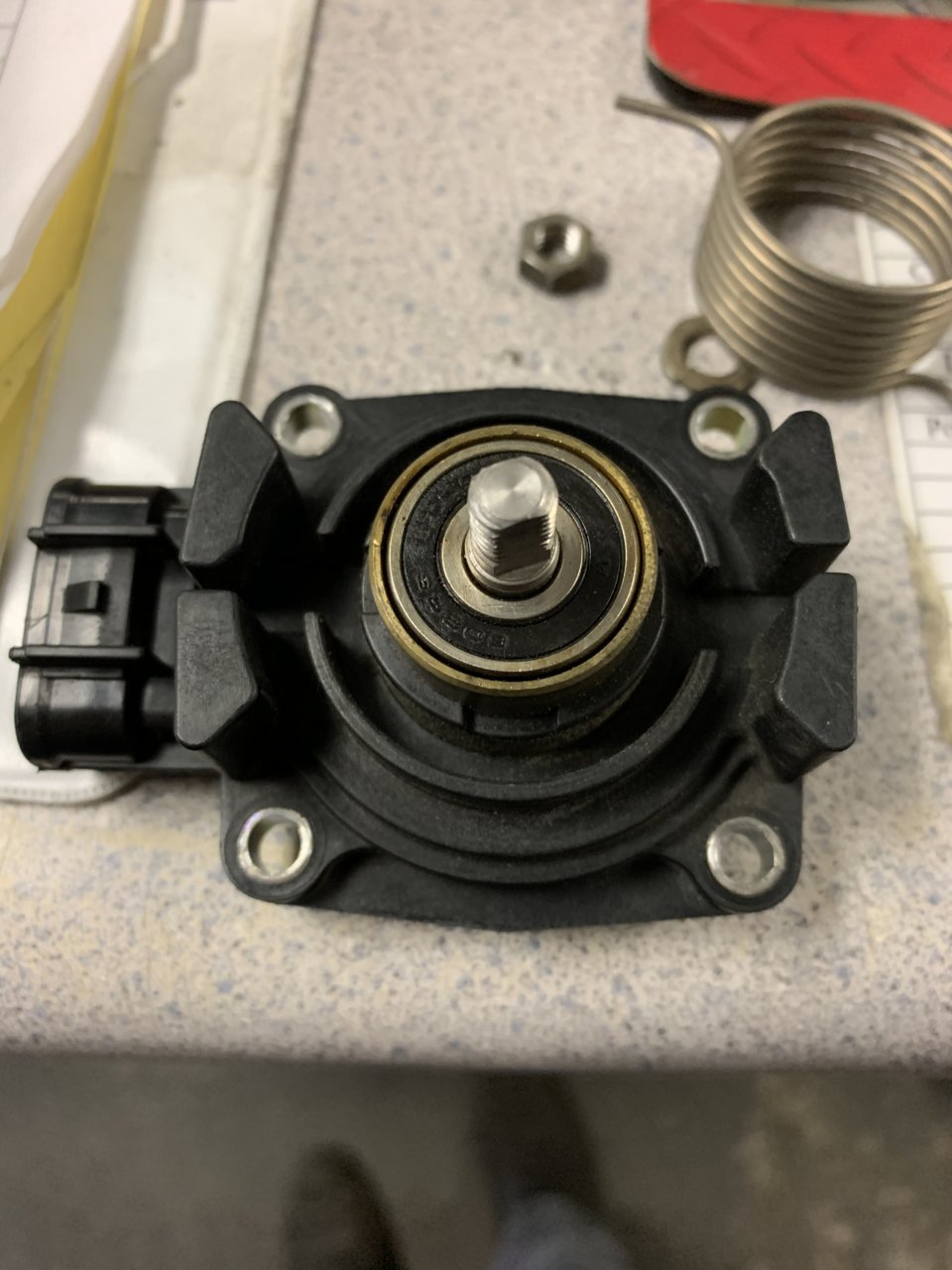

    Which hole? Ive taken the old APPS apart and there’s no access to the potentiometer. It’s sealed up.
    also, don’t potentiometers have grease on the contacts? Last thing I want to do is degrade/remove that.

    There's a small hole in the white back plate. I guess regular elec. cleaner wouldn't be good to use. but a product like this could be used.

    Dam killed that idea. Is that your old one?

    Yessir. Would be nice if you get a Hall effect sensor and soldier it in there. There’s a good reason Toyota went to HALL sensors in their APPS.

    That one looks like it might have 2 broken solder joints. Top and bottom pin.
