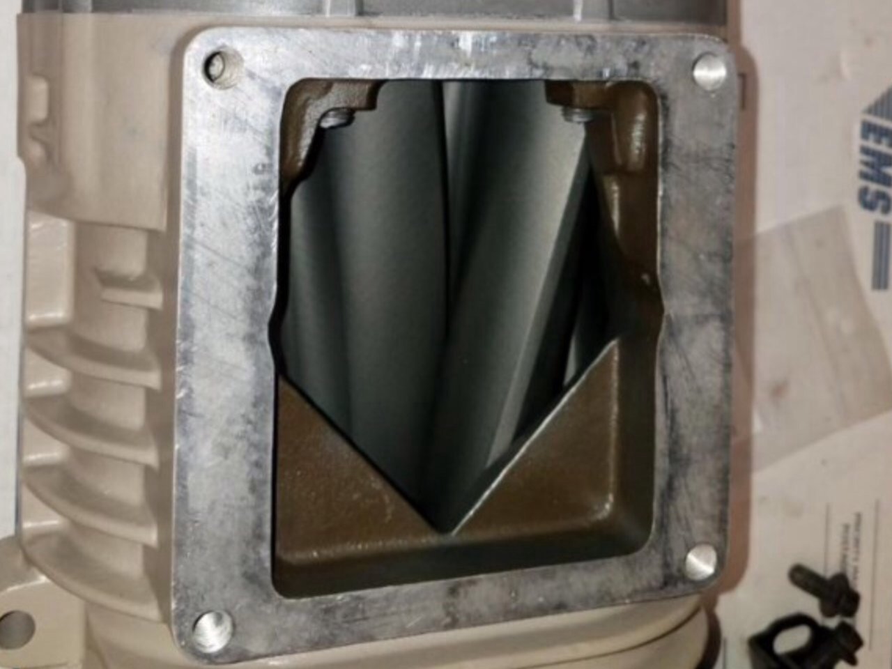

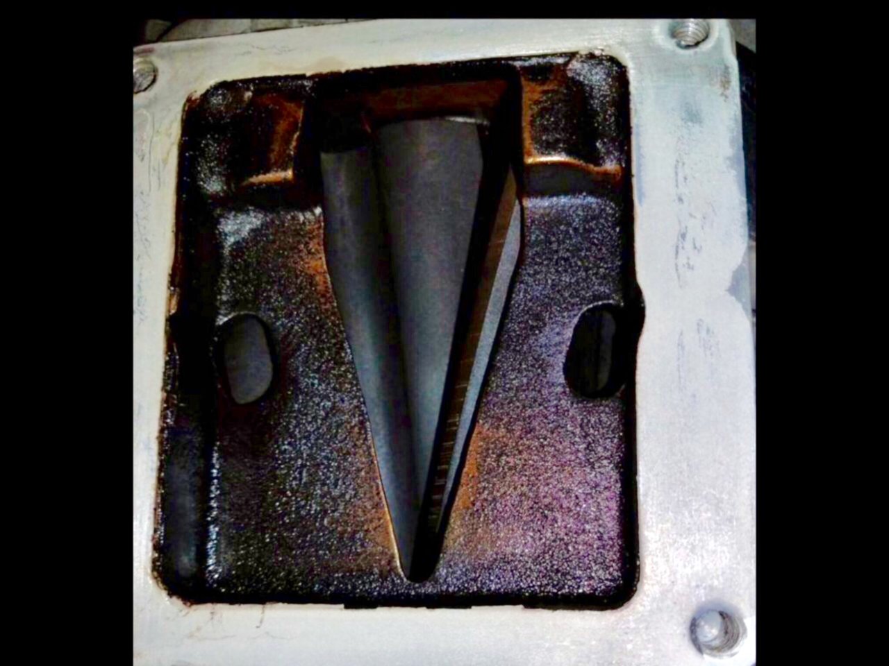

    The early TRD superchargers can be ported internally and you can get more power more air flow.
    The one piece superchargers can not be ported inside.
    BUT, they don’t sell replacement parts for the early version anymore IF you needed a part like a nose snout etc.
    This is mine ported
