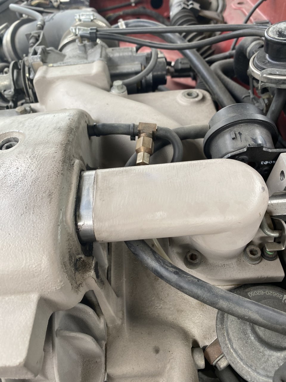

    Newbie question does this look right? C9FCF418-E4F0-476E-B55F-9C9DAF019D8A.jpg

    Yes, that section is correct,
    It does look to be leaking a little tho,
    There is an O ring that goes around the insert piece that’s probably leaking now

    Just the design of the 1st gen, it cant be pulled out because it’s bolted on the other end,
    If you remove the bolts then it pulls out

    Nothing, it’s aluminum, no rust, doesn’t matter if it gets dirty. This one has oil, carbon, blow by ,,pushing through the O ring and that’s why it is dirty, oil mixed with dirt
