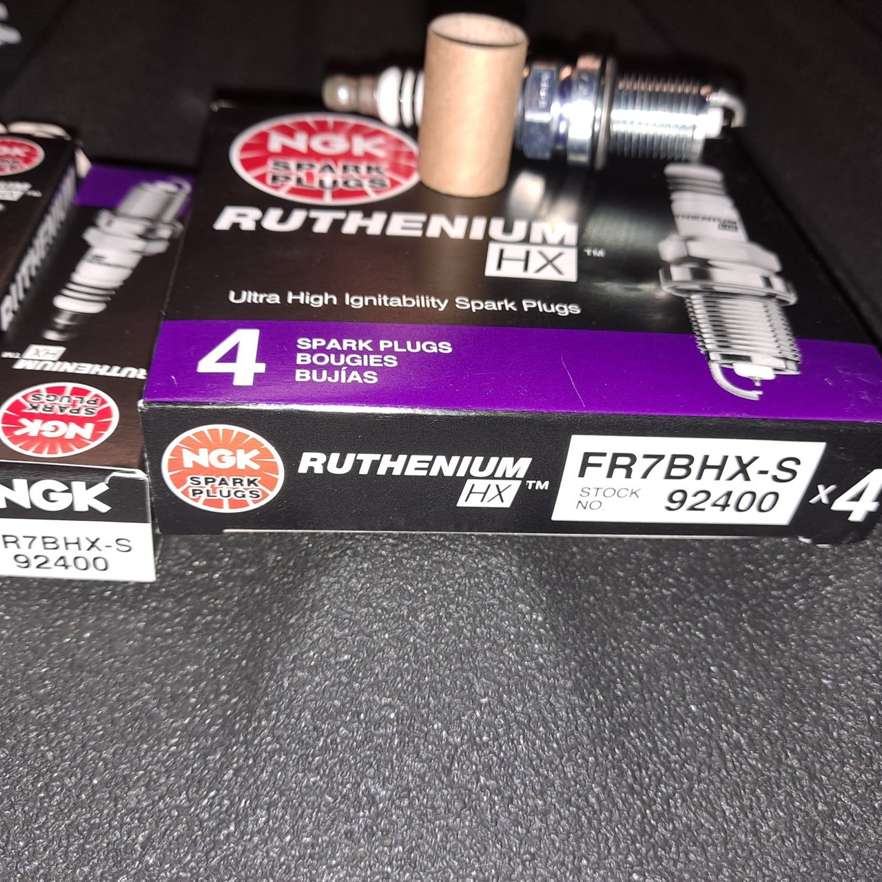

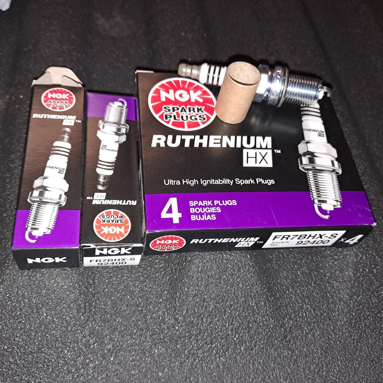

    Yeah, every 75-100 horses you should step down a plug range. You want the coldest plugs that dont foul possible. 1-2 is normally good for us
    1997tacomav6[QUOTED] likes this.

    Got the 2 step cooler plugs and they are installed ,
    Better to be safe,
    These are what you want if your wanting two step cooler plugs,
    Heat range is a “7”
    TacoBike[QUOTED] likes this.
