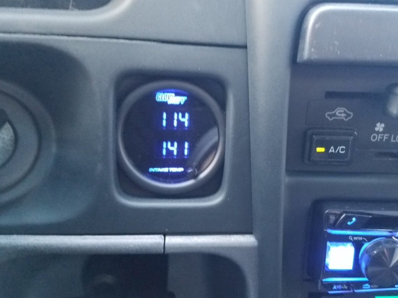

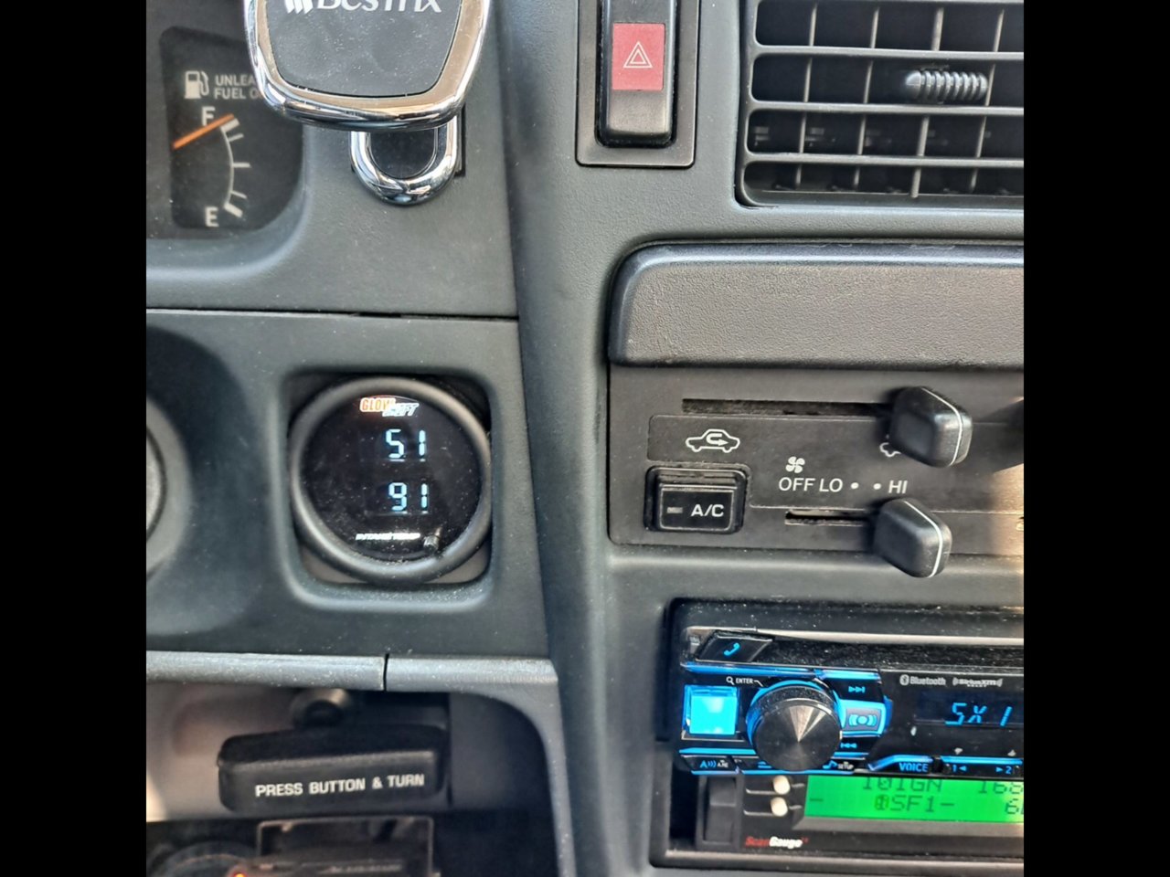

    I push the limit and so far I’m ok,
    A smaller pulley will create lots more heat to the bearings etc,
    That’s why I run a #5 nozzle methonal,
    I swear even after 3 hard back to back pulls on the Dyno the supercharger you can still place your hand on and is relatively cool and my Dyno numbers were all in the same target area with no drop from heat soaking. I’m sure with out the methonal for cooling the bearings would burn up quick.
    My intake supercharger temperatures after the compressed air Full boost have been 175 degrees on a hot day, normally around 125-145
    A regular supercharger without methonal will way exceed that 200 plus,
    Here are intake before and after hot numbers, 90 degrees outside
    And a cool day outside
