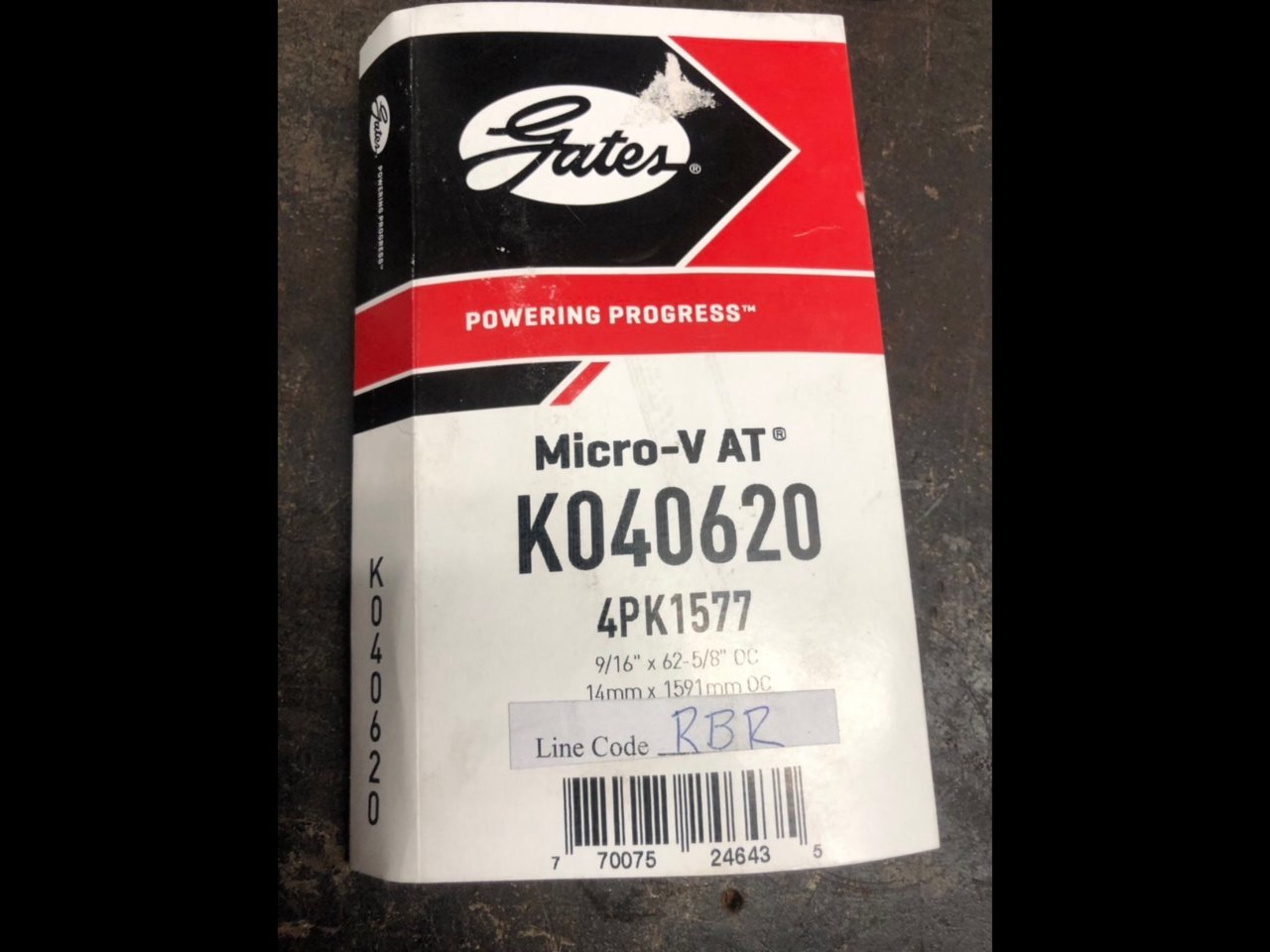

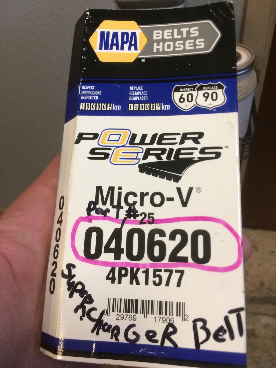

    Maybe it’s rebranded , not sure,

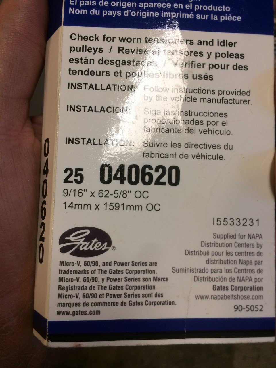

    1997tacomav6[QUOTED] likes this.
