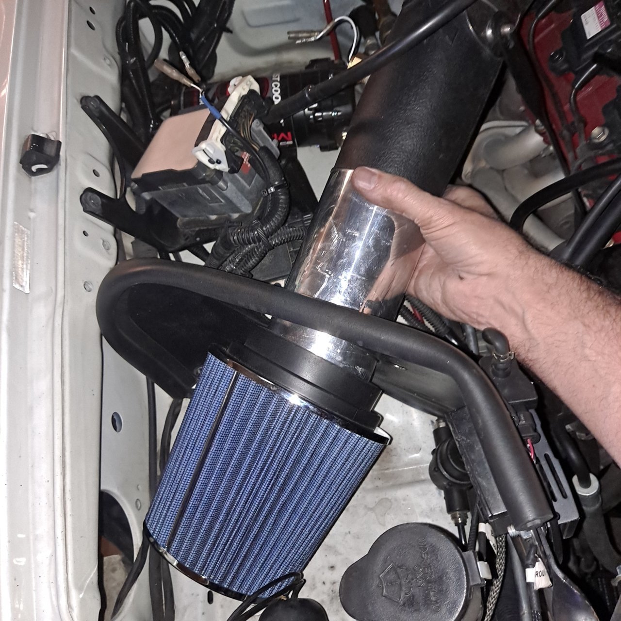

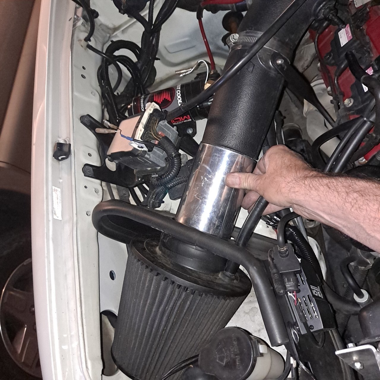

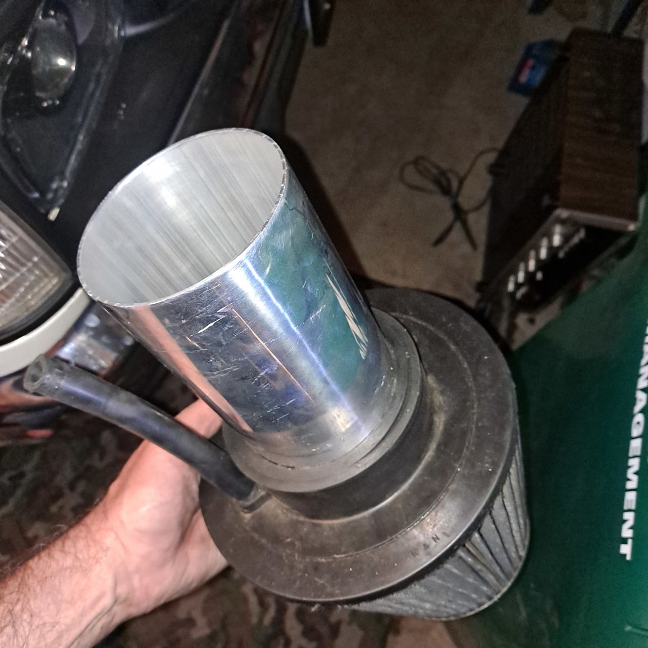

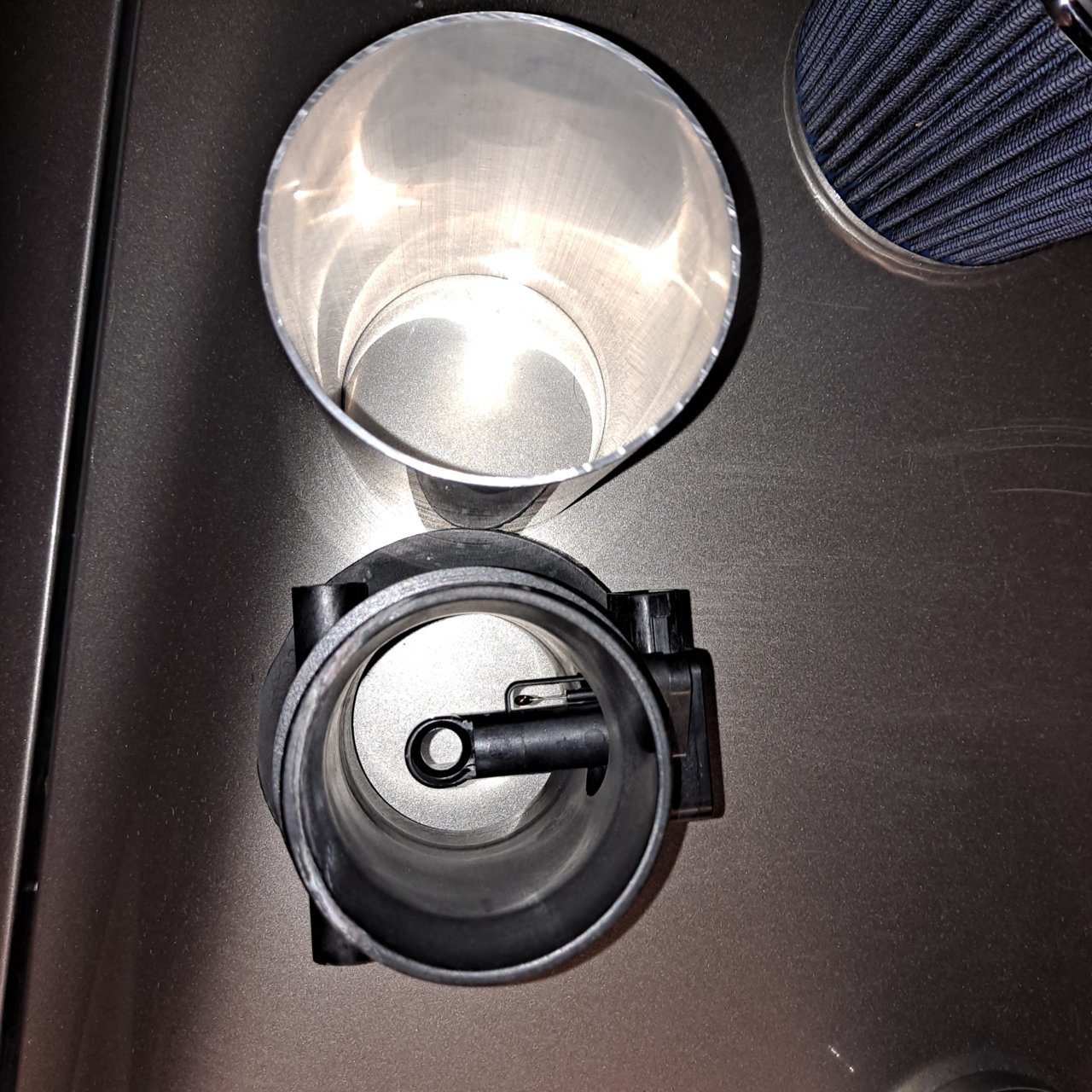

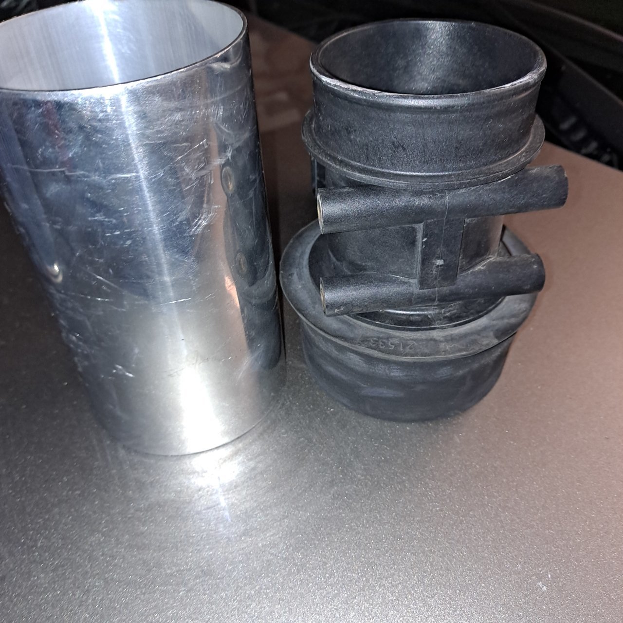

    spectre 3" MAF intake replacement section arrived today to replace the stock 2.5" MAF section.
    Doing a test fit, The new haltech ECU that's on order doesn't use a MAF sensor.
    Larger intake should = to a little more power.
    Hopefully getting it all tuned and installed in 4 weeks

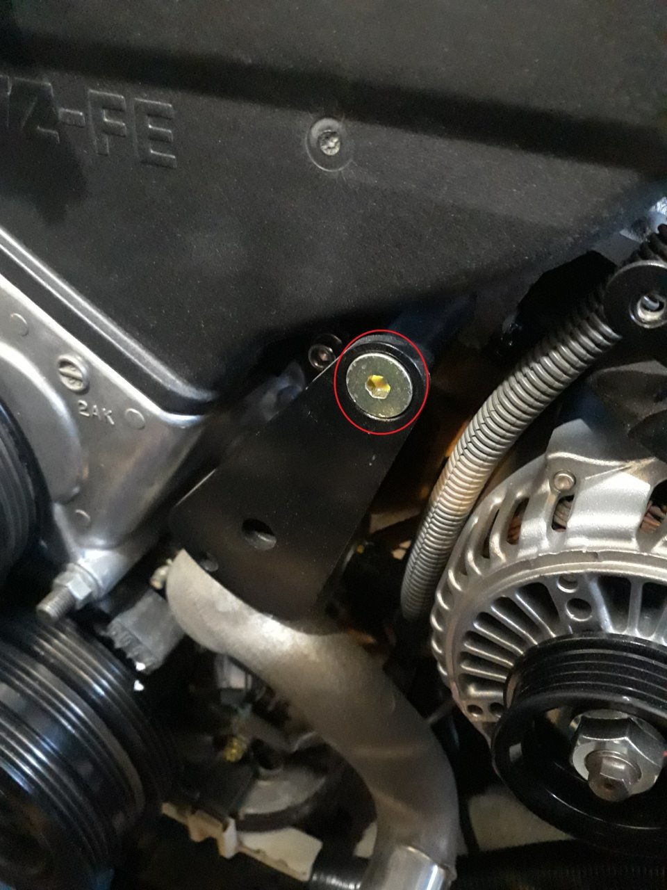

    Does anyone know the torque spec for these two bolts circled in red? Both hold the S/C pulley bracket on. I was thinking around 32 ft lbs but wanted to check with you guys first. Doing the water pump and timing belt reassembly. 20180414_203223.jpg 20210704_145722.jpg

    I used a little bit of blue lock tight on the allen head bolt that holds the bracket on like the write up suggested. Did you have a bad experience doing that?

    No. I just don’t like the idea of using thread locker on a bolt in the head like that. Toyota does this with the exhaust studs but I trust that they know what they’re doing, its engineered and they’re using the right stuff for the job. All my studs came out without much issue.
    Just sounds like a bad idea to me. Also, you can’t go by color as many people believe. I think the stuff Magnuson is red red. If you use the red stuff from one or more of the manufacturers it’s high strength and the only way it’s meant to be broken is with 300 degrees of heat. There a guy out there somewhere that used the red permanent stuff and had a bad day when he needed to get to the thermostat.

    I know what you mean. I have it pretty well back together or I would reconsider taking the bolt out. And I dont want to retorque into the aluminum head if I can help it. If I put red lock tight I would be taking it out for sure. I will just roll the dice and see in about 100K miles. Thanks for your advice.

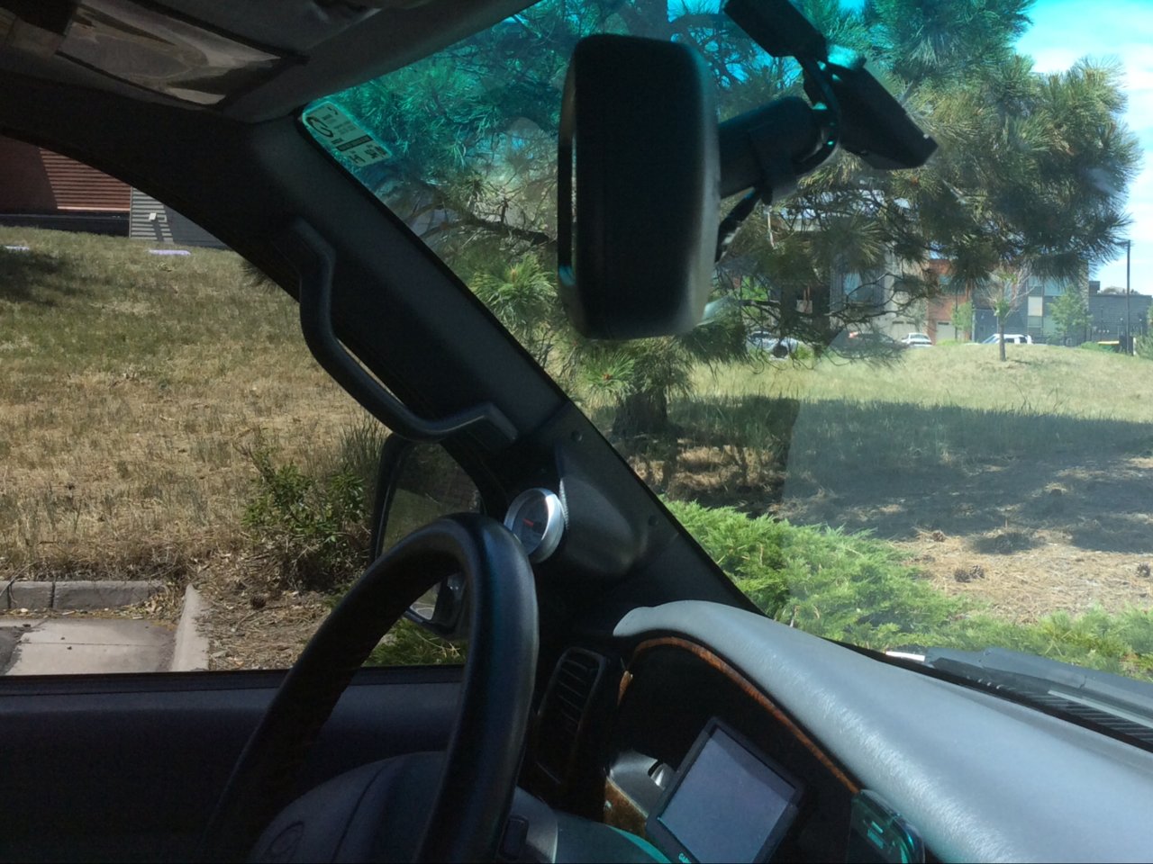

    How to you guys have your Innovate PSB-1s installed?
    This thing has some seriously thick wires so my the current location will not work.

    Yes there are,
    Up through the pillar frame,
    You have to muscle the wires to get them in, tho
