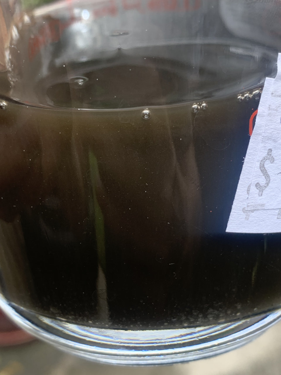

    So I don’t know if anyone has pulled new oil out of their supercharger after only a few tanks of gas but this is what I got after the nose cone rebuild.
    Im not sure if this is normal. Smells more like diff oil than anything else.
  8. Jul 13, 2021 at 8:29 AM
    #3168
    eon_blue
    Mar 4, 2016
    #180213
    69,742
    Azusa, CA
    I would assume normal. Most oils start looking pretty dirty right away after you put a few miles on them. And supercharger oil never smells good even when new, stuff is rank.
    I haven't checked mine with just a few hundred miles on it before though. But I would think it's normal

    Yeah I’m just a little paranoid. With the seal leaking I’m wondering what else was done wrong.
    But I got the seal replaced and went for a drive. So far no apparent leaks.
