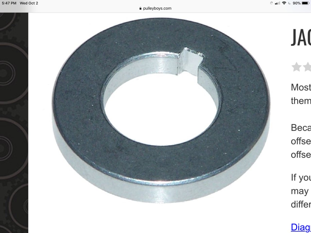

    Essentially it’s a big washer with the key cut out and slips over the shaft when the pulley is off and it pushes the pulley out about the 1/8” of an inch so the pulley doesn’t hit the snout.
    Back spacing

    I don’t see anything on backspacer. Is there a part number or webpage? Here’s what I got. 06385F00-251F-4786-AC8C-AC1732DD7880.jpg

    I thought URD made one of these, maybe with the URD pulleys you don’t, can’t remember,
    Maybe call URD and ask if one is needed

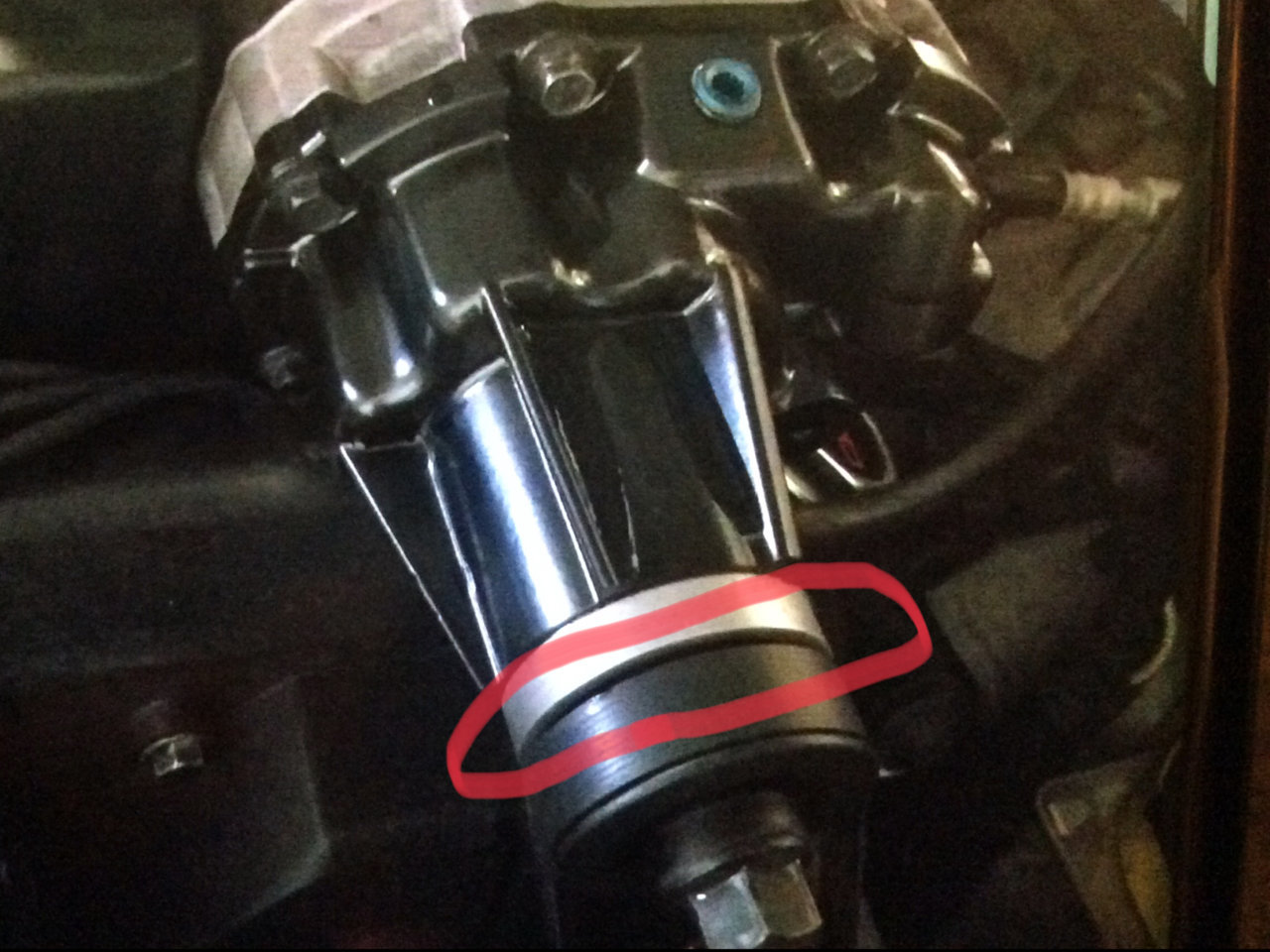

    The spacer if needed pushes the pulley out so it doesn’t hit the snout.
    Mine is pretty dam close

    ill give em a call and see.
