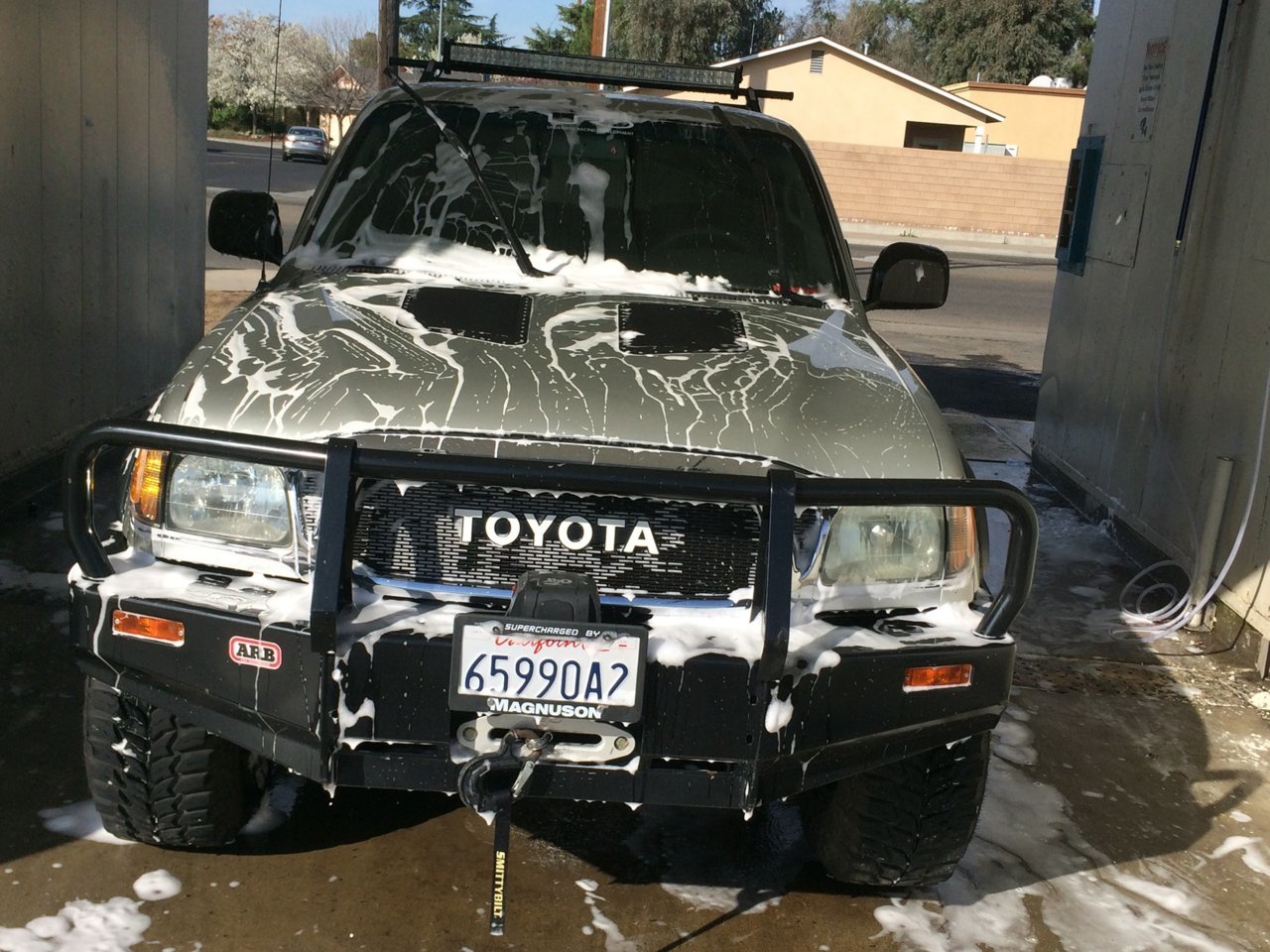

    You don’t worry about water hitting EVERYTHING? I wouldn’t want water getting on any electrical stuff and bolts greatly increasing the chances for corrosion.
    If I do this it’s going to be right over and behind the fan shroud and because its the most effective place to pull air while at speed and for hot air to be pushed out by the fan.

    not much water gets in unless you intentionally spray it in. louvers are pointed backwards. I chose to put them where I did because I felt It looked good and the air would come in the grill and out pulling air across the supercharger before going out

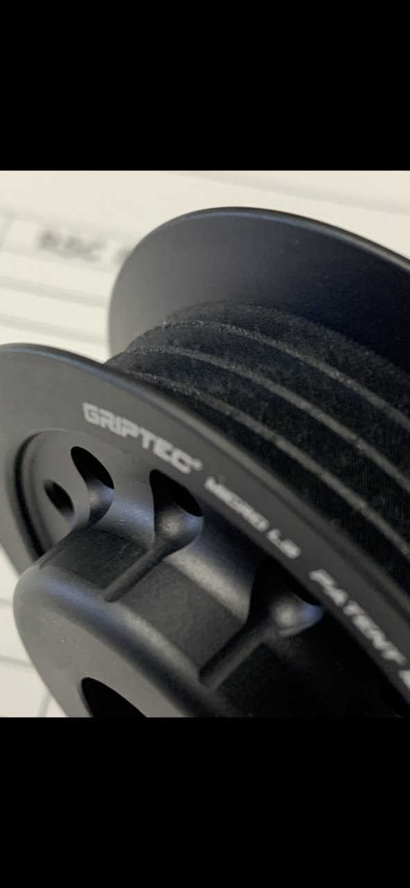

    Ive never seen that kind before , looks great!

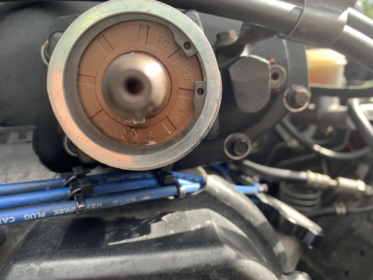

    Well, fuck.
    I decided to take the pulley off to take a look. This is what It was looking like with the other seal but with the old one I would of had way more oil everywhere under the hood, leaking down the snout, etc.
    I used superlube to grease the seal. If you’re familiar with superlube it melts pretty easily. So hopefully that’s just the superlube. But that color says otherwise.
    I’m my case it’s the shaft that’s giving me a hard time. That seal seemed to fit tighter on the shaft than the OD so I’m not sure what’s going on.
