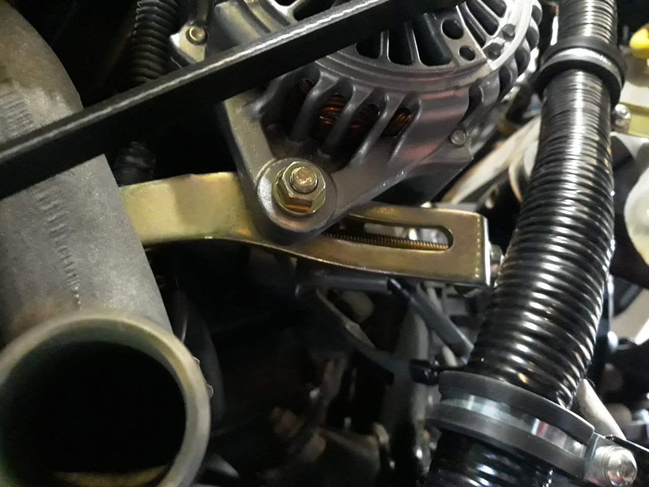

    I am replacing the alternator belt and alternator (Denso 105 amp) which has the mounting point positions the same as the original alternator. Also Im not using a Toyota belt its a Gates K040620, which should be the same length as the Toyota supercharger belt. I pulled the supercharger tensioner to get the belt on and once the belt is on and the tensioner is released the belt is pretty tight. When I go to tighten the bolt for the alternator tensioner the pivet bolt is to the far left. I remember it being towards the middle once the belt is close to spec tightness. Going off Timmy the Toolman video and his was tight with the pivet bolt more in the center of the slot. The picture shows where mine is in reference to the slot with the belt tight already. If I were to tighten the alternator adjuster bolt to bring it to the center of the slot then the belt would be way too tight. I have made sure the belt is routed correctly on all the pullys. Is anyone elses like that?

    Post more pictures? My belt has always been super loose even with the alternator to the center. Like wouldn’t even hardly register on the crikit tension gauge.
    It was always slipping so I ended up using a 61” belt and moving the alternator tensioner all the way in. It’s tighter but still only reads 40lb on my cheap tensioner tool.
    I read on Gadgets site that he was setting to 80lb with the static and auto tensioner. I have no idea how he was able to manage that.
    Do you have a tensioner tool?
