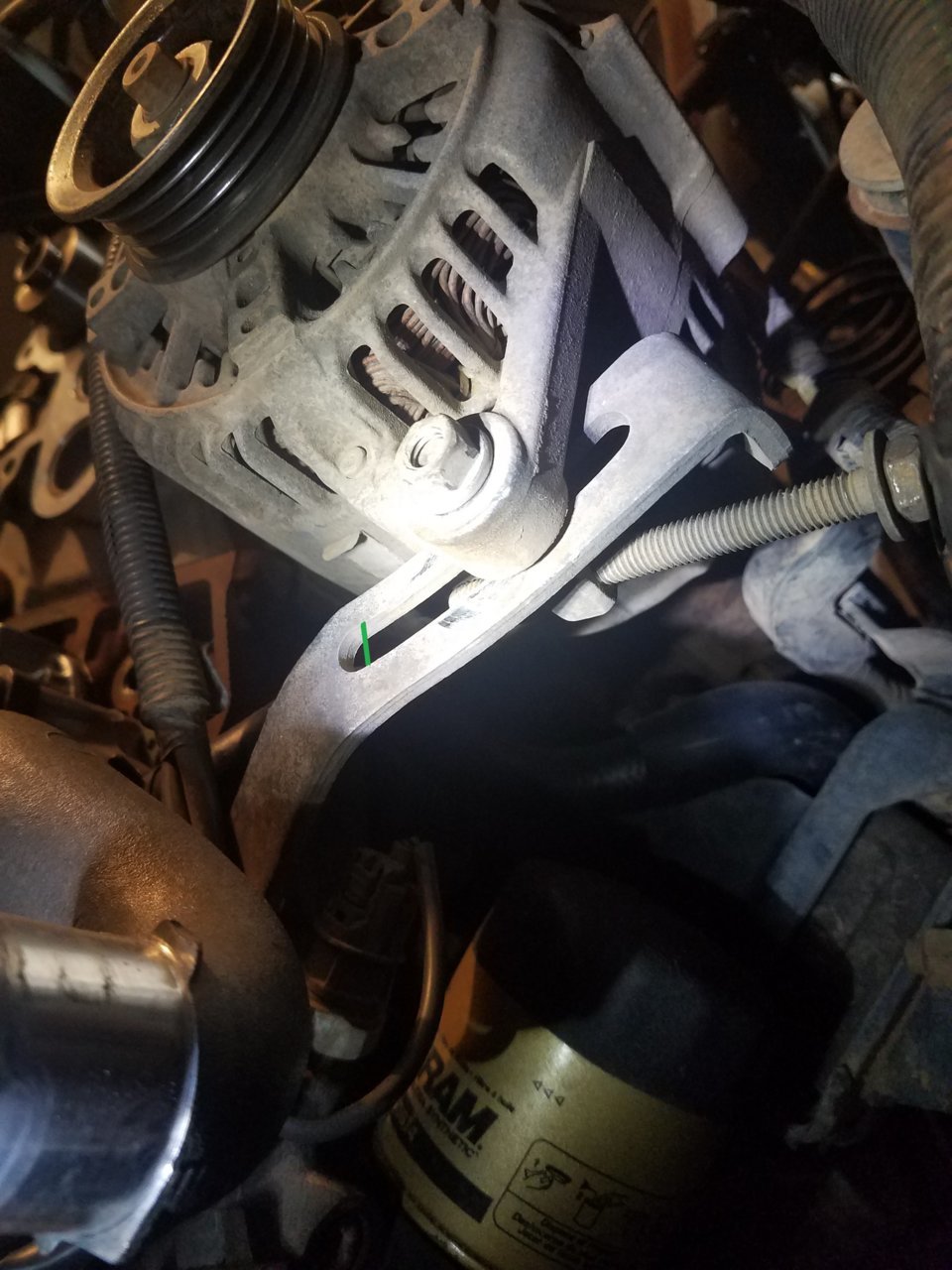

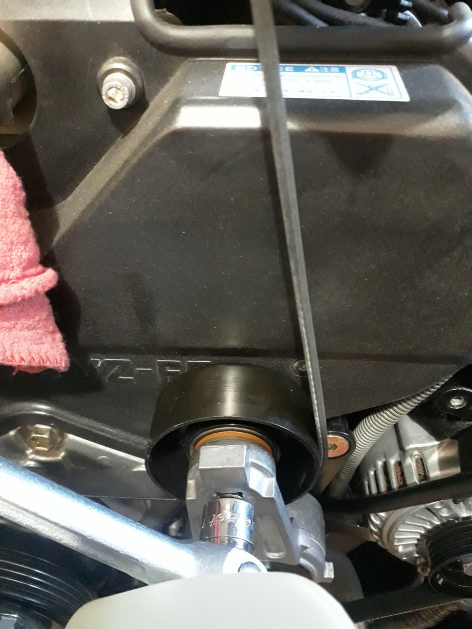

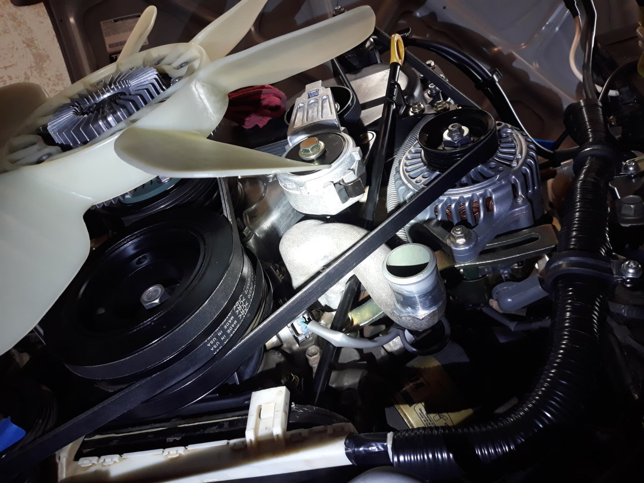

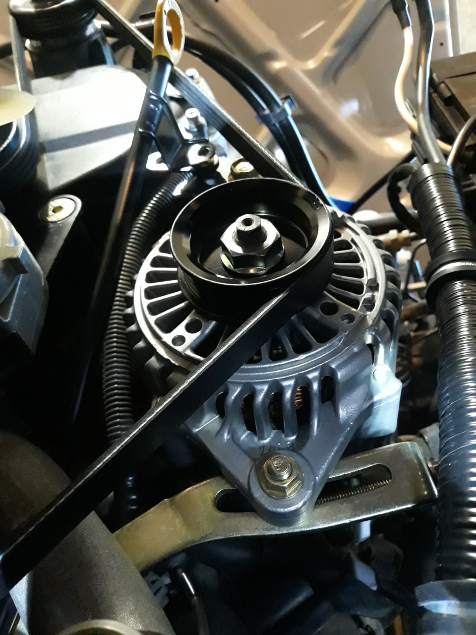

    I dont have a tensioner tool, just going by feel (10mm) up and down movement on the belt until I start the motor then will get it dialed in better. Here are a few more pictures.

    Jesus dude. Is that truck brand new or are you just OCD?
    anyway. The pulley on your alternator does look bigger than what I have. Maybe compare it to your old alternator and report back. Because now I’m interested to know.

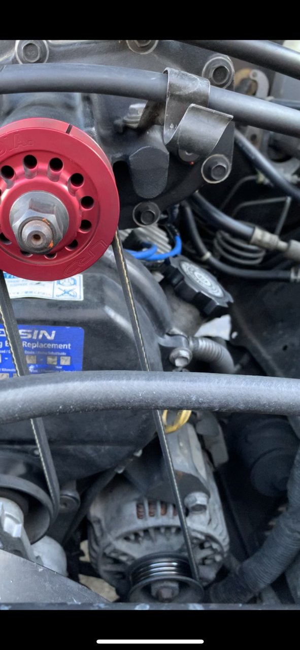

    I don’t have a good picture but you can see my alternator pulley looks much smaller

    Haha! It's the OCD. Did the timing belt and water pump replacement and ended up doing much more. Good eye on the alternator wheel. The stock alternator pulley is 2 3/8" in diameter while the new alternators pulley is 1/8" bigger at 2.5". That would account for it being off a bit but wouldn't think it would make that much of a difference. I'm currently pulling off the belt to compare to the Toyota belt length.

    You mentioned the alternator pulley do you mean the SC pulley? Mine is just the original pulley that came with the SC. But comparing the alternator pulleys there is 1/8" difference from the original to the 105 amp alternator

    I was referring to the alternator pulley. Yours look way bigger that. Maybe mine is super small for some reason. I’ll have to measure it tomorrow.

    Looking at other pictures across the net I think mines just small. Maybe that’s why I’ve had slip issues for ever now. If you look at my picture close you can see the nut almost take up the entire ID.
    Wow. That’s super frustrating.

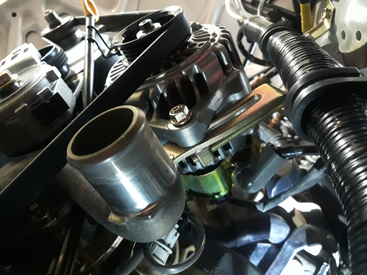

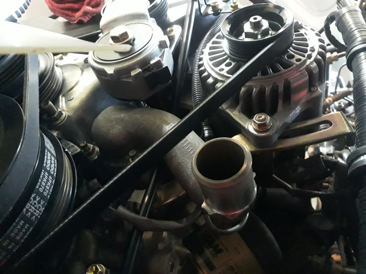

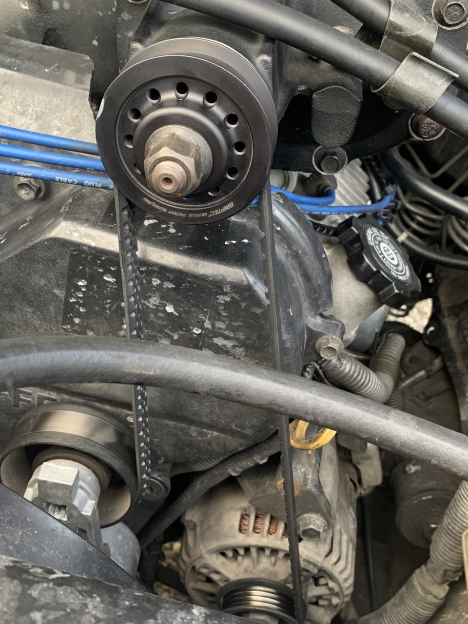

    These are some old pictures I had taken before I disassemled it. The red mark is where the alternator was positioned before loosening the belt. The green mark is where the position is now after assembly with the belt really tight now. Both the Gates and Toyota belts are the same length after stretching them tight side by side. Maybe Im making too big of a deal out of it but cant figure out why its so off in the alternator tension slot.

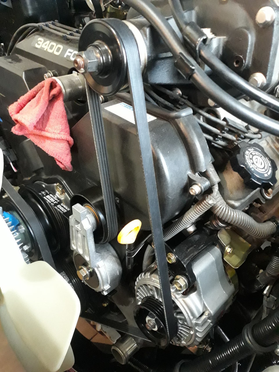

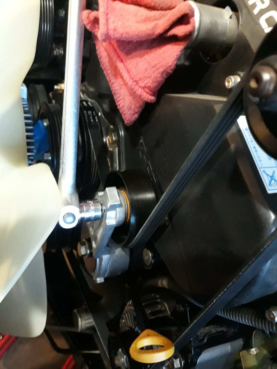

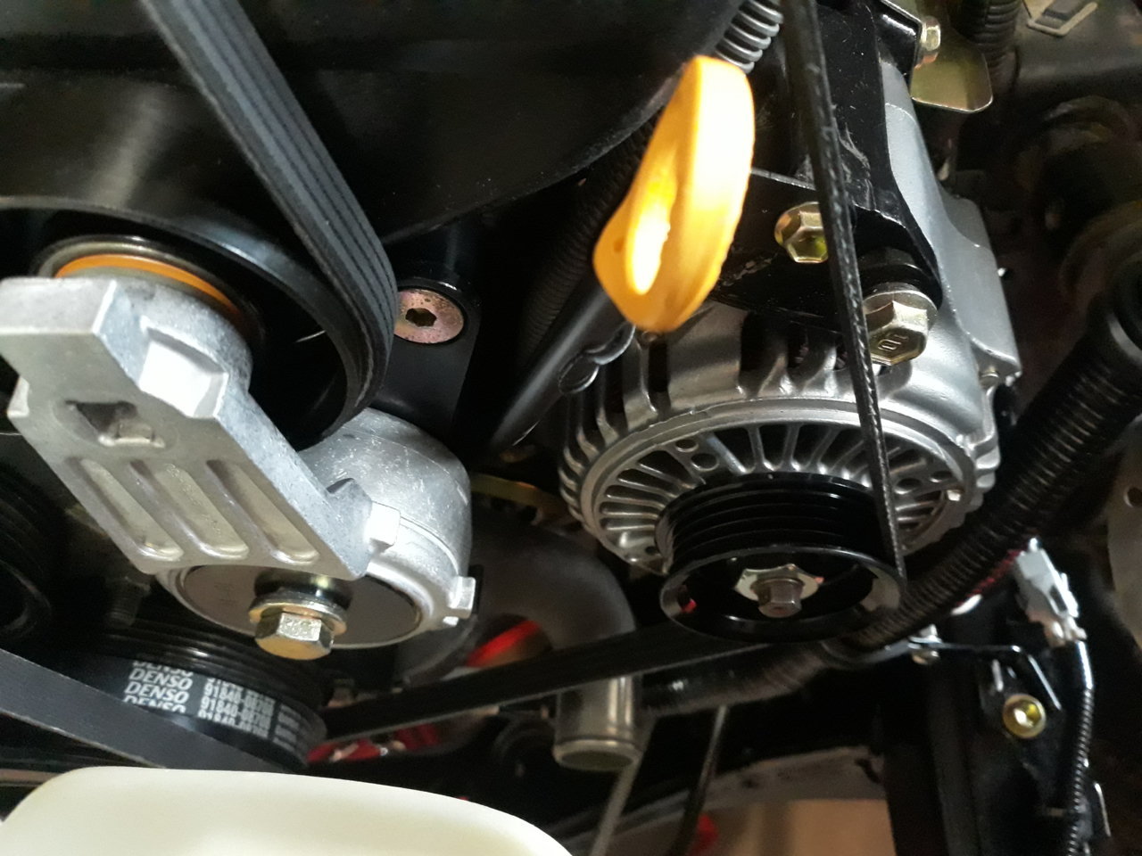

    I may have figured it out. I first set the alternator tensioner in the original position from before I disassembled it. Then I routed the belt accordingly and pulled counterclockwise on the lower SC tensioner/pulley until it basically bottomed out and was able to slip the belt over the upper SC pulley. The change that was made is that the lower SC pulley is basically positioned more verticle or more counterclockwise than before giving me the ability to position the alternator tensioner more central in the groove.
