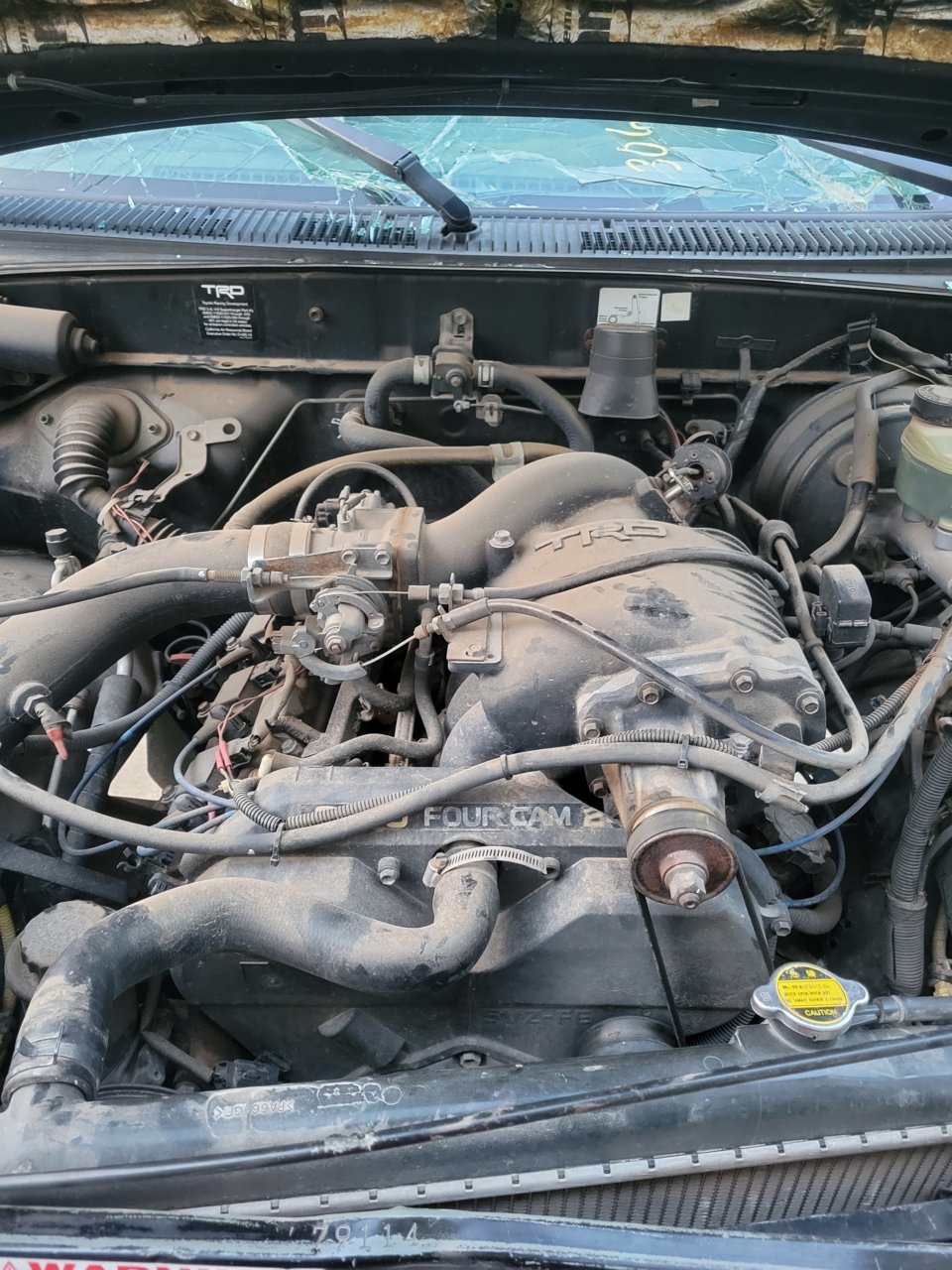

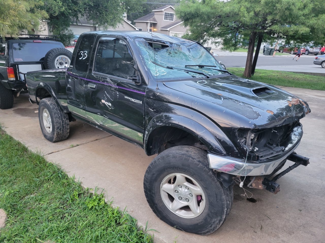

  8. Jul 22, 2021 at 1:15 PM
    #3248
    Milor
    Milor Well-Known Member
    May 15, 2018
    #253519
    309
    shaun
    03 Tacoma sr5 .TrD offroad 5spd..
    supercharged 2" pulley 6 puck clutch
    was it a rollover? parts truck only?

    Yes it was a rollover. No way it could be salvaged. Frame is rotted. Will be posting in the for sale section as a partout once I hit 50 posts.

    Can we get a pic of the full truck and the interior. and what year model is it? Also... i'd like to call dibs on the e-locker actuator if it has one... once you post it officially, of course :devil:

    Of course! Sadly no elocker. It's a 2000 Xtra Cab that took a slight hit front driver and rolled after. Still runs and drives and is a 4x4. 140k on the clock but will have to double check that when I get a charger on it. Will get a full set of pictures uploaded when I can post in the marketplace.

    damn if you were close to me i'd buy that hood right now even though its mangled.

    Got any pics of this badass 4Runner?

    It’s a 1998 Tacoma.
    The 4runner I have is just literally a bare Frame.

    That one in the photo looks to be a custom job. But there is a company I can’t remember f the top of my head that makes a fibreglass hood with a scoop

    @1997tacomav6 has a writeup somewhere on here about the functional hood scoop he did for his truck on his stock hood, looks really clean.

    I think the 00 and older trucks can just use a 4runner hood. But I may be wrong

    DansHoods. However I believe that louvers in the correct spot do more for cooling than a scoop.
