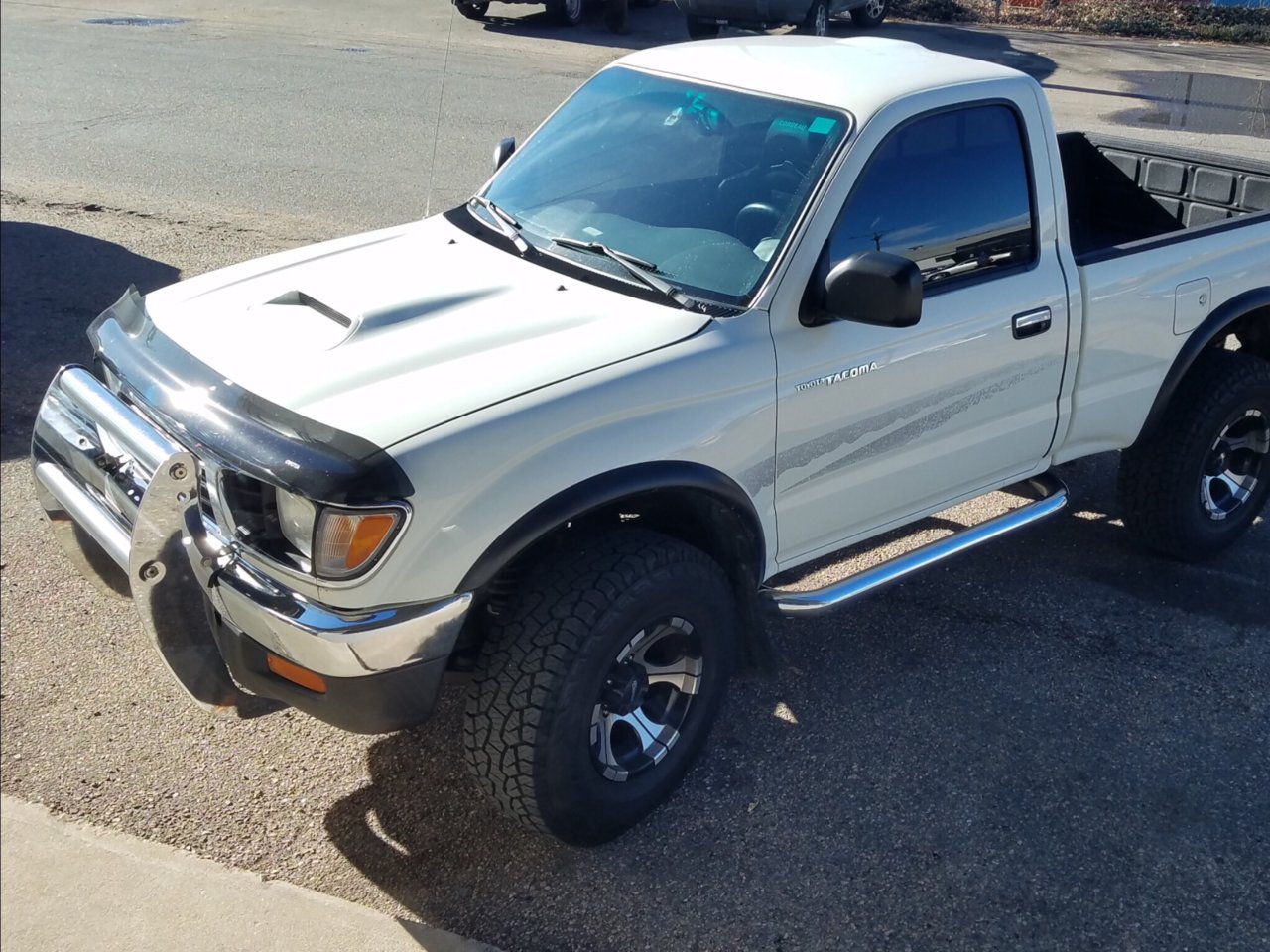

    how about louvres and a hood scoop

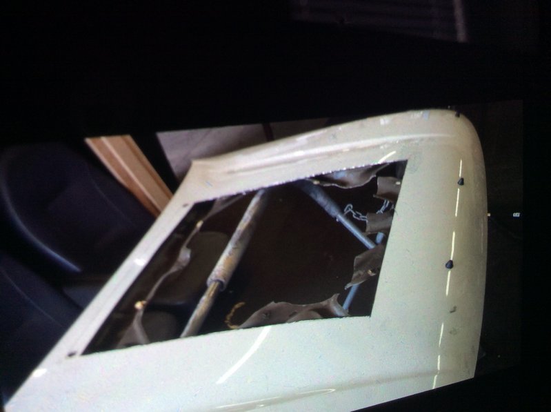

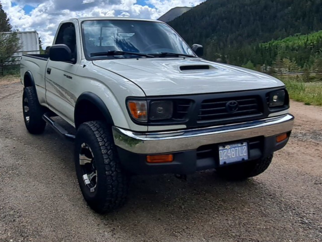

    The 4runner hood will not work because the 4runner fenders are different,
    I cut the 4runner scoop out and cut it into my stock hood and cut the scoop open to let air flow over the supercharger

    The hood scoop actually forces air over the top of the supercharger where it is the hottest, while vents will definitely help the air is not being forced onto or over the supercharger, the hottest area is actually the snout location,
    At what ever speed your at 25 or 75 you have that much air being pushed over the top of the supercharger that is usually around 150-200 degrees
