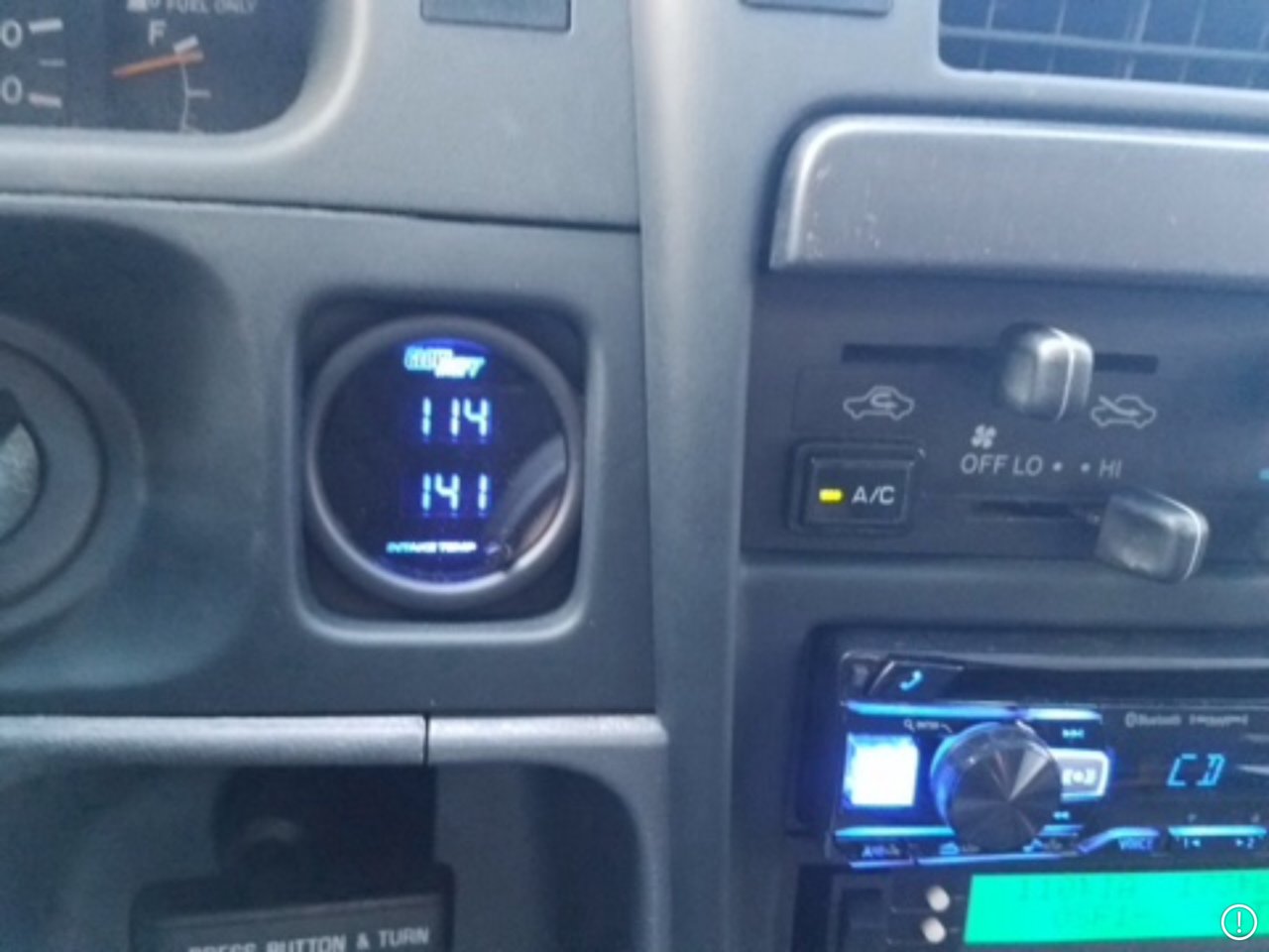

    V6 5sp,RegCab,TVS1320 Supercharger, 56mm pulley, methanol injected Haltech ECU, AC Tvs1320 supercharger,(MUST DO) every 125,000- 150,000 needs rebuild Projector headlights HID 5 speed manual Amsoil for all drive train Smaller 56mm custom pulley, (MUST DO) 2004 DESNO fuel injectors, zero ping ping, 2004 side door mirrors Dick Cepek Rims, Michelin tires LTX, ATM Pathfinders Dynopro ATM ( that last 100,000 miles) Now running Dynopro ATM mud and snow tires KN cold air intake Cat back dual exhaust with ss exhaust tip, Raised exhaust tail pipe to 2" below body line Optima*dry cell battery,red top Alpine sirius radio, 200 watt amp, focal is165 split door pod speakers Focal door speakers Subwoffer behind seat Viper alarm, Electric Locks Dark tinted windows, bucket seats corbeau lg1 Tacoma Rubber floor mats TRD fender extenders, Bilstien shocks, King shocks JBA UCA trailer iv hitch, electric brake control, Drilled slotted brakes, High carbon steel (MUST DO) EBS green stuff 7000 series pads(MUST DO) TRD engine oil cap TRD stick shift, Marlin crawl shift kit. Rear sliding window 2002 4Runner functional hood scoop cut into Tacoma hood, 4Runner dual overhead map light Gentex Auto dim + Compass + Temp, garage,rearview mirror Snow Methonal kit stage 2 Custom 3 core aluminum radiator Linex bed liner Haltech stand alone ECU, Intake supercharger gauge. Stainless steel brake lines, Custom leather wrapped steering wheel, Haltech stand-alone ECU,
    I am running an aftermarket radiator with a 170 stat so my engine temperatures are usually around 175-180,
    The superchargers are heat makers, no way around that.
    My supercharger temperature gauge can show an added 50 degrees just at idle from the MAF intake difference to the air after it’s gone through the supercharger going into the intake.
    All this heat just sucks your power away
    Are you run a supercharger temperature gauge to know your temperatures?

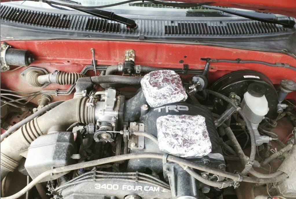

    I dunno, having a hot supercharger is good for warming up grilled cheese sandwiches on the trail. Can't do that if it's nice and cool all the time

    Haha awesome. on one of our last desert trips we had breakfast burritos cooking on the headers. we seriously need to figure out how to cool the gearoil in the nosecone, the heat generated has gotta be the main reason going below a 2.1" or 2" pulley is bad

    i just have a small scanner plugged into the obd2 port to monitor my ect & Iat. so I don't know what the temps at the charger are. I run the 170 thermastat and also run the bigger 4runner 3 core aluminum radiator with about 80water/20 coolant mix. Big Electric Fan from an f250, and a Hayden 1040 engine oil cooler which is also for f150/250. Jba headers are ceramic coated and heat wrapped, and the 11"x20" louvers(rear facing) placed where the hood gets the hottest... I'm pretty sure the methanol or some kind of hood scoop is the last way for me to ditch anymore heat. unless we can figure out a way to pump the nosecone oil to a cooler... oh and something else I just figured out after putting on my new throttlebody. it has coolant hoses on it

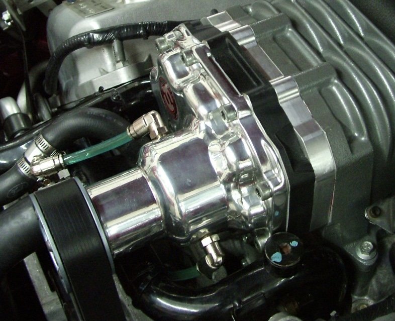

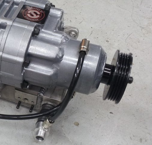

    On the snout cooler thing. There’s no way of actually coming up with an oil cooler. If it was possible it would have been done on an Eaton. I’d imagine the engineering involved with coming up with a circulation system that keeps oil pressure from spiking, the oil in the snout at the correct level etc. would be difficult to engineer.
    Having said that Kenne Bell does have a water cooled case but there’s not much on how it actually works. I’m assuming it has water ports in the nose cone area.
    Steigermeier has a mod where he welds a water jacket over the nose cone called the venom cooler. Ive considers this but you’d have to make a standalone tank, pump, and exchanger.
    the downside to this is that he’s welding to your cast aluminum snout. I would be concerned that the heat would warp nose cone in a way that could cause some bearing issues where the surfaces were originally machined to hold the bearings in.
    Someone needs to do this and see how it works out. It’s $500 for the mod plus whatever you come up with for the rest of the system. I’d assume it could be an issue to get the circulation speed right so that it’s efficient. Circulating too fast and it won’t take heat away and too slow it will under preform.
    again, I’d be more worried about the welding to cast part. It’s not that it’s NOT possible but rather how well it will hold up and wether or not it warps critical bearing surfaces. But I really don’t know enough about any of that to know if it would be a concern or not.

    this is interesting

    dont let that pic fool you. I’m 90% certain that particular nose cone just happens to have a cavity from the factory. All he had to do was drill.
    on every other picture of different nose cones you can see the water jacket welded on.

    i was wondering about that. those were the only pictures I could find
