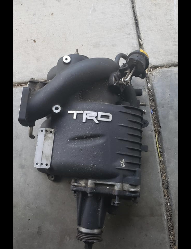

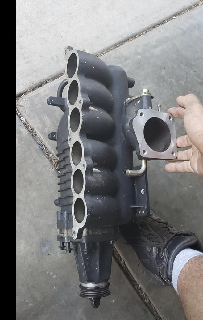

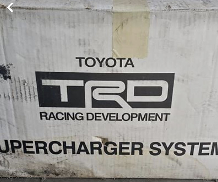

    Hey, does anyone know how to determine the condition of a supercharger that the selller has no known condition history? Maybe a visual check of some sort? There a guy selling a 2nd gen black supercharger that’s been sitting in his shop for years that was forgotten about , comes with no hardware, pulley, belt, etc. He wants $1,500 for it. Any opinions welcomed.
    Thanks!9FF23710-3C6B-467D-9242-9AEAFEF508DB.jpg496BFCED-1953-401A-91C5-A7A3BE431C62.jpg EC7DF1A3-D4C0-47A7-A2B5-2D024E23263B.jpg

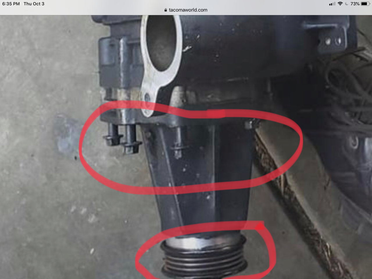

    It’s definitely used and looks like the snout was taken off as the bolts are not even tighten down.
    So expect to have to do some repairs along with finding all the other parts.
    The pulley has wear on the groves too, so there is a good chance it had a problem and was taken off the truck.
    Your buying a gamble at that price and could be a bad buy depending on what needs to be done.
    A full rebuild is 1000.00 plus 1500 plus xxx for parts.
    Not really a good deal

    Spin it, listen for obvious indicators, bearings scraping, excessive lash in the rotors or if they are contacting the housing. If you have a bore scope you can try and sneak it in the runners to see if the rotors are damaged at all. Some of it is hard to listen for though and your only really going to find out once you open it up.
    He give you any indication on usage/mileage? Thats your #1 way to estimate if problems will occur or if a rebuild is needed. Which I would do anyway.

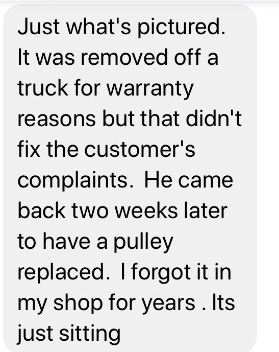

    This is all the info I could get pretty much...
