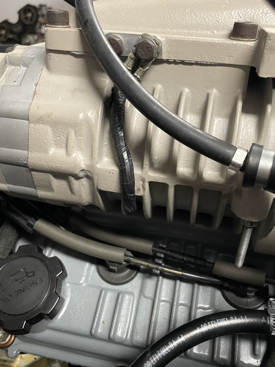

    I have a 2002 but installing a first gen charger onto my truck. Has anyone else ran into this issue with not having a mounting location for this wire? I was able to bolt it to the top of the SC but kind of worried about the wires becoming brittle from heat.

    Looks like a ground wire? Should be fine, could always wrap it in heat shrink wrap.
    BeLance89[QUOTED] likes this.

    Looks like just Ground i can check where i routed to tomorrow and let u know
    BeLance89 likes this.

    yeah it’s just the ground that tees off from the engine harness. It originally bolted to the lower plenum of the stock plenum/manifold assembly.

    Ah ok probably see just as much heat from stock location just keep it away from the header and make sure it has a little slack to move if the sc flexes

    good call, I’ll need to extended a little bit because right now there’s very little slack in it.
