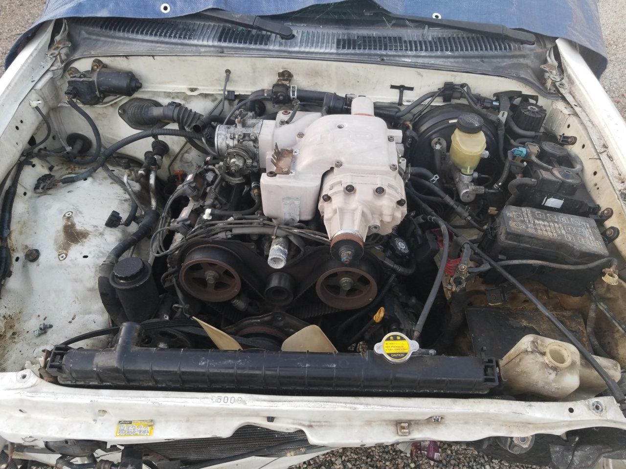

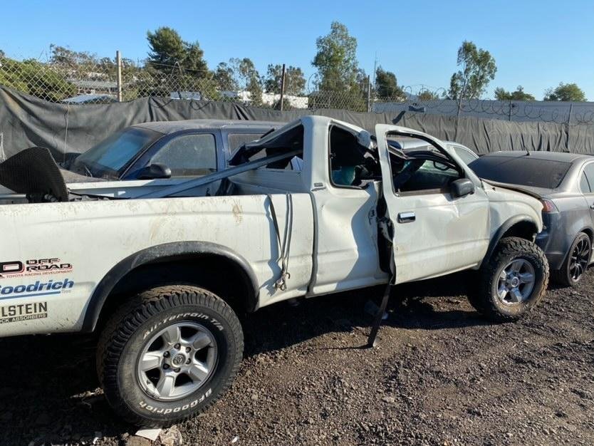

    I am sure most of you came about owning a supercharger a little differently than me. An acquaintance's father had a '98 TRD with a supercharger and lost control and rolled it. Don't know for sure but I think it came to rest on the roof and drivers fender. He was severely injured but last I heard he was recovering. I bought the truck and an in the process of removing the supercharger and I am planning on installing it in my 2001.
    I just removed the supercharger and as I thought it had motor oil in it. probably more than what came out the vacuum tube on the back probably about 4-8 ounces not having anything to measure it. the rest of it probably went back down the intake when they rolled it back over. Now here's my question, what do you think I should do about it? I was planning on changing the oil in the snout and it's would probably be a good idea to open it up and rebuild it. What should I do to the main body where the rotors are?

    Looks like it rolled pretty bad. I hope he has a speedy recovery.
    as for the SC, If it were mine, I would rebuild it or have it rebuilt. But it you’re trying to keep costs down and add cheap boost, you could just spin the pulley by hand to see if there’s any interference, or grinding bearings, or anything like that. It should spin freely and smoothly.
    also, just as a side note, don’t forget to grab that oil dipstick relocation bracket off of the alternator mount.

    BeLance89,
    Leaning towards rebuilding it. I looked at the rebuild thread and it seems pretty straight forward.
    I have the truck so I will be able to scavenge everything I need off of it, I want to part out some of it before shipping it off to the auto salvage.
    I did order the dynamic pulley from URD, it had the static pulley.
    Thanks for the input.
