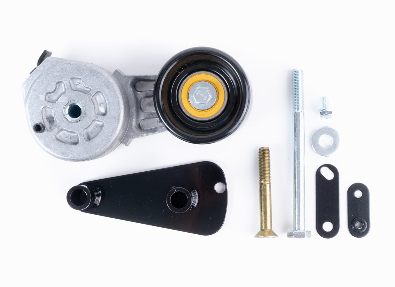

    you know that doesn't come with the tensioner bracket...
    I ordered the kit as well and only used a vacuum line and the Auto trans bracket. still have everything else from it.

    I think it does. This is what I got.

    Ohhh, gotcha. I what thinking the other hardware kit that just has all the different throttle body brackets.

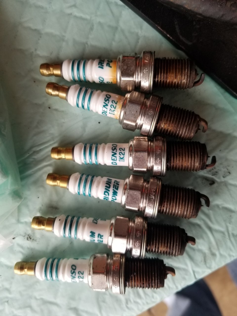

    Update to my crappy gas milage.
    Replaced upper and lower stream exhaust sensors
    Went from 130 mpg to 175mpg
    Just replaced spark plugs and found a loose plug and they all look kinda bad.
    Also replaced air filter and spark plug wires. Now ill see how much the mpg improves. I used the FR7 plugs, engine runs smooth and i keep thinking my trucks engine is turned off at stop lights it doesnt make any sound or vibration.

    you will love those new plugs. what was the gap on the fr7's .029? did you check the gap on the ik22's I bet the gaps were too big.

    I remember i did check the gap on the ik 22 at the time and i believe they were fine. Now that they are out i can measure them again

    i meant now that they were out. I know when I pulled mine the gapping was bad on a few after some hard supercharged miles

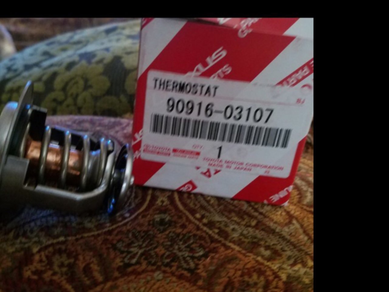

  16. Aug 18, 2021 at 11:18 AM
    #3496
    Billnis
    Billnis Well-Known Member
    Mar 23, 2020
    #322835
    132
    Bill
    Menifee, CA
    2001 White PreRunner Extra Cab 3.4L V6 Oak Int.
    PERFORMANCE: TRD Gen1 Supercharger, Snow Performance Water/Methanol Injection, Toyota E-Locker, Falken Wildpeak Tires, 5100 Bilstein Shocks, Redarc Tow Pro Brake Controller, B&M Transmission Cooler. EXTERIOR: Raptor Spray-on Bedliner, Custom NRT Off Road decals, Chase Rack with Offroad Lights, Fog Lights, Bed Lights, Rear Bumper Lights, Rago Bed Stiffeners, T1A Metal Door Handles, 7-Pin Trailer Connector, Switchback front turn signals, LED tail lights, License Plate Lights Shutoff For Backup Camera. INTERIOR: Android Head Unit with OBD2, Dash Camera, Backup Camera, TPMS, and Hands Free Microphone, Rockville SS8P Subwoofer, Remote Door Locks with Automatic Window Close, RFID Kill Switch, Custom Switch Panel, Hands Free Phone Mount, All LED lights LED, Ignition Light Ring, A pillar two gauge pod with VC-50 Meth Injection Controller and NRT Branded Oil Pressure gauge, Torque Pro App for Gauges (Wideband Air/Fuel, Water Temp, Trans Temp, MAF, Volts, Timing, Engine Load, Intake Temp, Throttle Position, Fuel Status - shows open or closed loop, Instant MPG.)
    9091603107 part number for the 170 thermostat.
  17. Aug 18, 2021 at 11:55 AM
    #3497
    jruiz555
    jruiz555 Well-Known Member
    Jan 12, 2019
    #279080
    1,191
    I run the 170 thermastrat and my temps are about 180. I just purchased a champion radiator but havent installed it.
    My trans temp run about 190 and when driving up the mountain, i see about 210 to 230 trans temp. I want to keep temps down a bit more. This is with a aftermarket trans cooler and i bypass the radiator
    unstpible likes this.
  18. Aug 18, 2021 at 3:52 PM
    #3498
    1997tacomav6
    1997tacomav6 V6 5sp,RegCab,TVS1320 Supercharger,Haltech, 800k
    Oct 5, 2013
    #113940
    10,419
    John
    Denver
    97 reg cab, v6 5sp 300hp supercharged, Methonal Injection, 800,001 plus miles, Original Owner
    V6 5sp,RegCab,TVS1320 Supercharger, 56mm pulley, methanol injected Haltech ECU, AC Tvs1320 supercharger,(MUST DO) every 125,000- 150,000 needs rebuild Projector headlights HID 5 speed manual Amsoil for all drive train Smaller 56mm custom pulley, (MUST DO) 2004 DESNO fuel injectors, zero ping ping, 2004 side door mirrors Dick Cepek Rims, Michelin tires LTX, ATM Pathfinders Dynopro ATM ( that last 100,000 miles) Now running Dynopro ATM mud and snow tires KN cold air intake Cat back dual exhaust with ss exhaust tip, Raised exhaust tail pipe to 2" below body line Optima*dry cell battery,red top Alpine sirius radio, 200 watt amp, focal is165 split door pod speakers Focal door speakers Subwoffer behind seat Viper alarm, Electric Locks Dark tinted windows, bucket seats corbeau lg1 Tacoma Rubber floor mats TRD fender extenders, Bilstien shocks, King shocks JBA UCA trailer iv hitch, electric brake control, Drilled slotted brakes, High carbon steel (MUST DO) EBS green stuff 7000 series pads(MUST DO) TRD engine oil cap TRD stick shift, Marlin crawl shift kit. Rear sliding window 2002 4Runner functional hood scoop cut into Tacoma hood, 4Runner dual overhead map light Gentex Auto dim + Compass + Temp, garage,rearview mirror Snow Methonal kit stage 2 Custom 3 core aluminum radiator Linex bed liner Haltech stand alone ECU, Intake supercharger gauge. Stainless steel brake lines, Custom leather wrapped steering wheel, Haltech stand-alone ECU,
    This is the one I have 170, the Corolla stat
