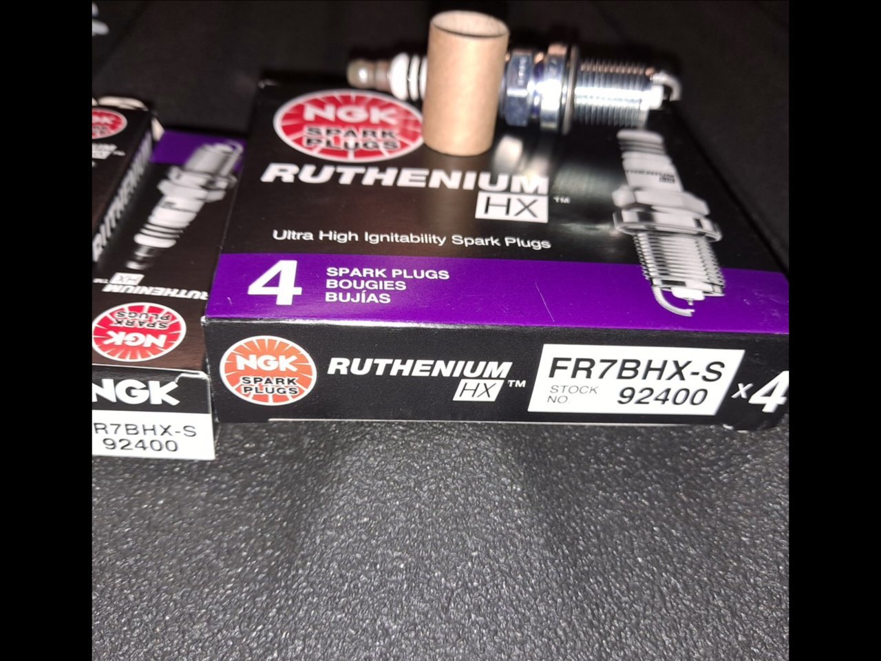

    Took the truck for its first real “drive”. And uh.. the pinging is insane. SO confirms my suspicions of the dealer putting stock plugs in the poor thing… I’ve got the ik22s coming now….

    Since it's manual trans, keep your shifts above 3k rpm so you're no lower than 2500 rpm when you accelerate in the next gear. I've found on my truck at least, boosting under 2500 rpm is a great way to make it ping. 2500+ it never happens.
    7th injector may have something to do with that but still. High gear/low rpm is well known to make it happen

    I’ll see if Napa has them Monday. I tend to spend money there because I get that sweet employee discount lol
    i actually pulled one plug right after that post.. they’re indeed stock plugs… I think she’d be ALOT happier with proper temp plugs.

    Oh definitely yeah, don't be boosting that poor truck on stock rated plugs lol
