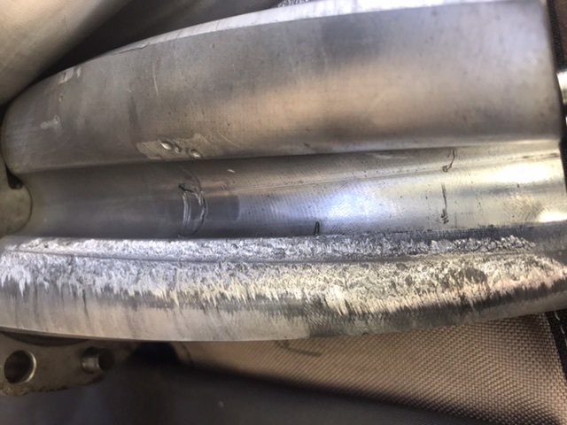

    I bought a supercharger that was rebuilt. Well, they put new bearings and put it back together with rotors that are complete toast. A full rebuild with new rotors and re-coat the bore is more than $1200. That plus the cost of the supercharger and I’m not all that far from buying a new one.
    I’d be very very skeptical.

    Yeah, I shoulda spent more time checking it out. I was short on time and excited.
    Im going to send it off to high speed lab for a full rebuild at some point. Maybe next spring.

    The bore has some light scoring. It’s not enough to catch a fingernail when you drag it over it.
    A re
    Hmmm...this might be a better route. The supercharger appears to have new bearings and a new coupler. I know it also needs a new bypass valve. I'll have to take a closer took to see what else it needs.
    $572 for new rotors and a bypass valve beats $1200+ for a full rebuild.
