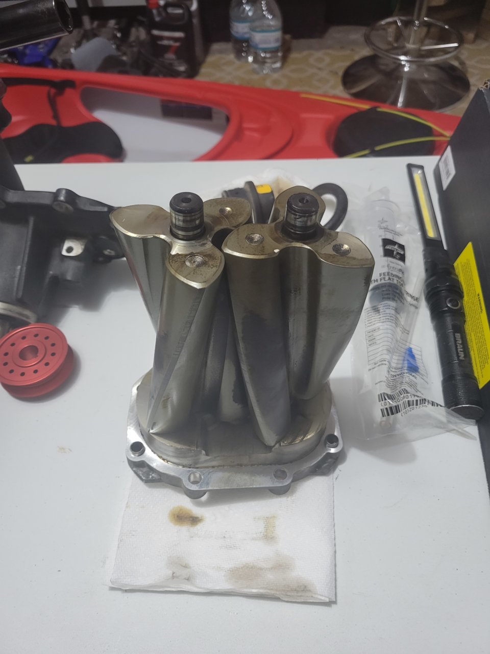

    Sending the rotorpack off to be recoated. Also seems like there is slight play between the two rotor assemblies, almost like they tap each other when I grab them and try to move them. Is this normal?

    Hopefully your replacing the rotor pack bearings?
    There can be play if these are worm,
    If the rotors have play tapping each other as shown in the photo that’s normal because they
    are not being held in place where the needle bearings go

    Yep. Going with High speed lab for the rotor rebuild and recoating. Will be doing housing rebuild here in my garage.
