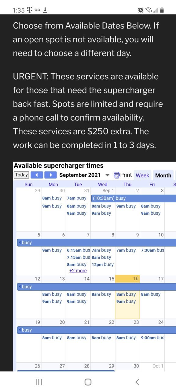

    I had to have the nose snout rebuilt on mine and Jon Bond had mine done in one week.

    Jon Bond actually has a live calendar you can schedule onto and for 250.00 extra can be done in 1-3 days

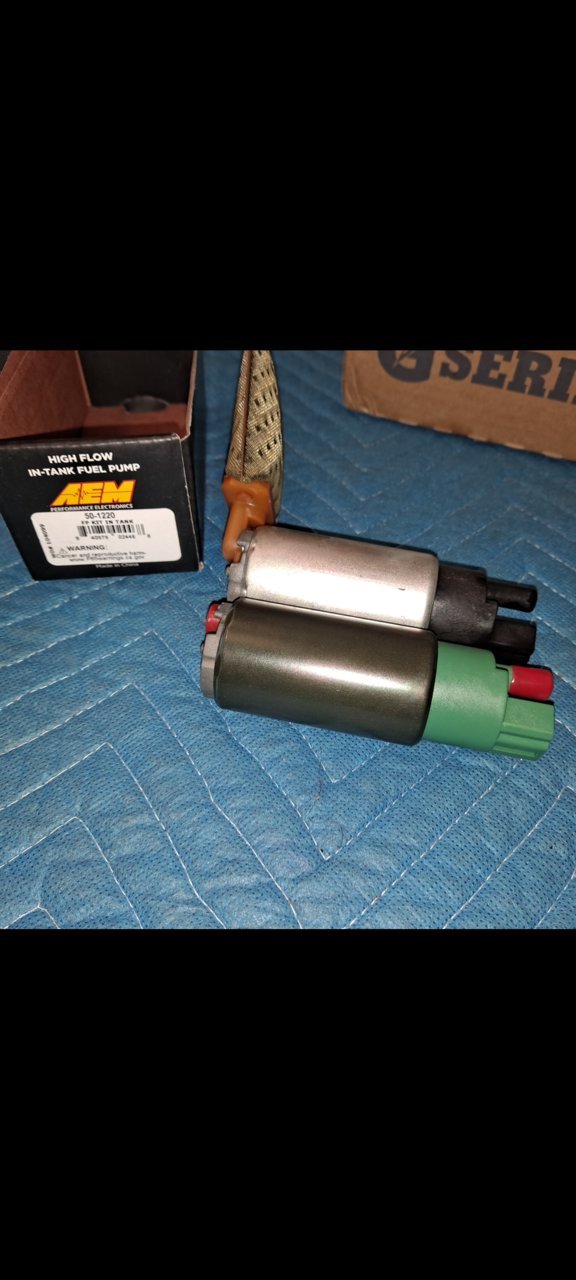

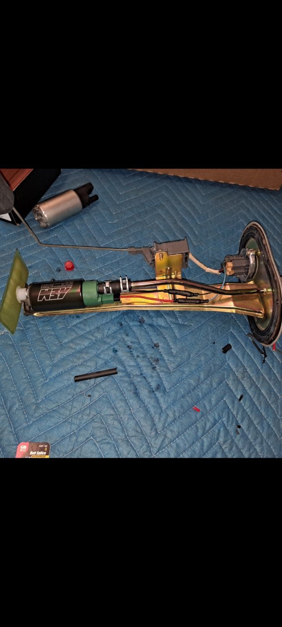

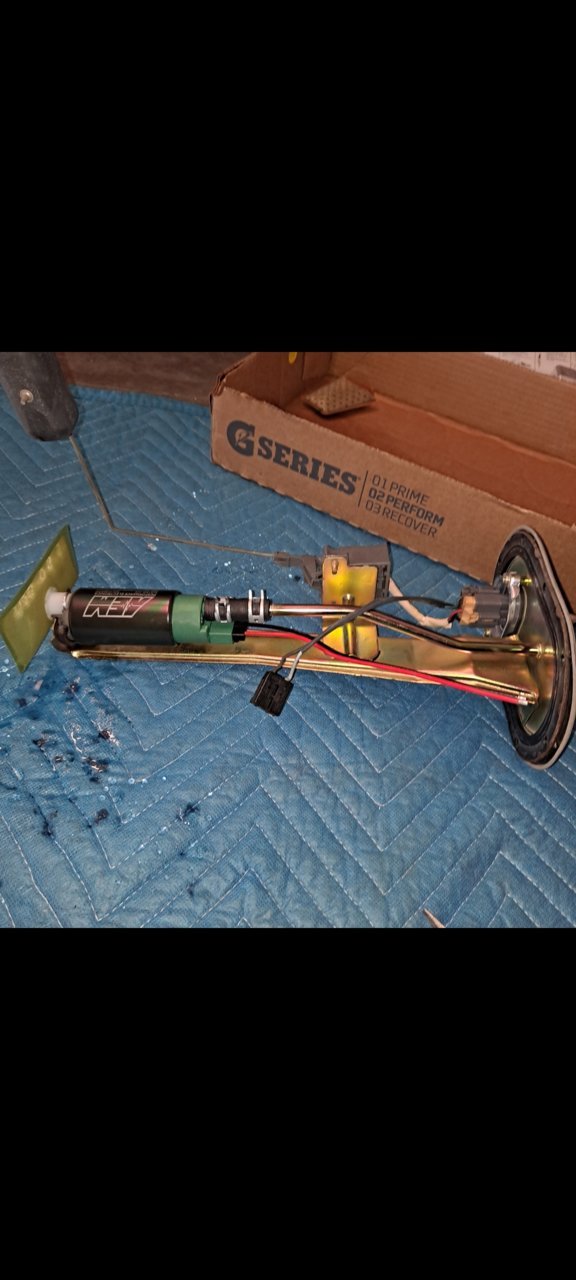

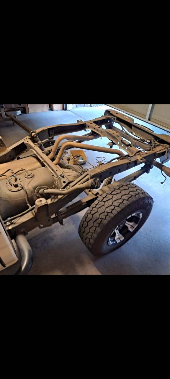

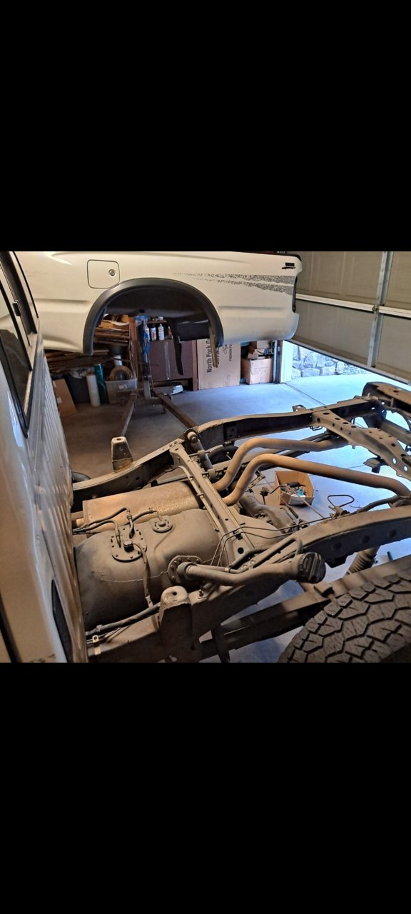

    Decided it was time to upgrade to the high output AEM 50-1220 340lph fuel pump.
    It's almost IDENTICAL to the stock Denso fuel pump.

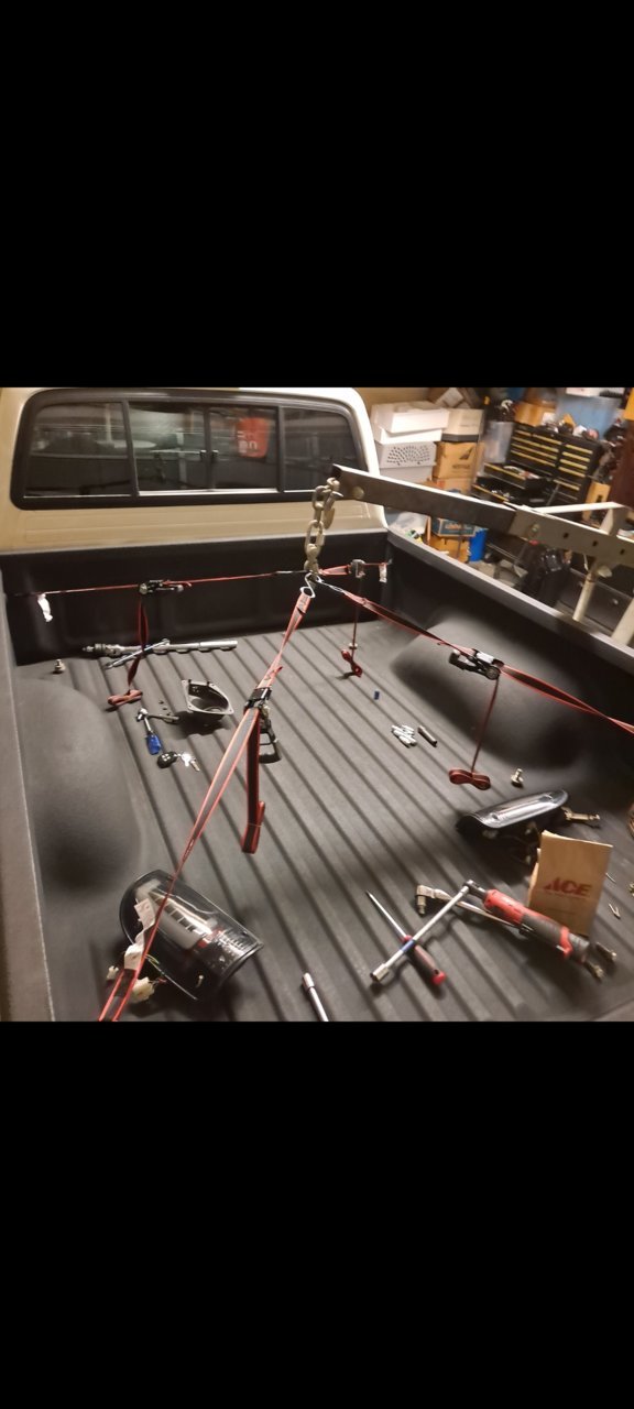

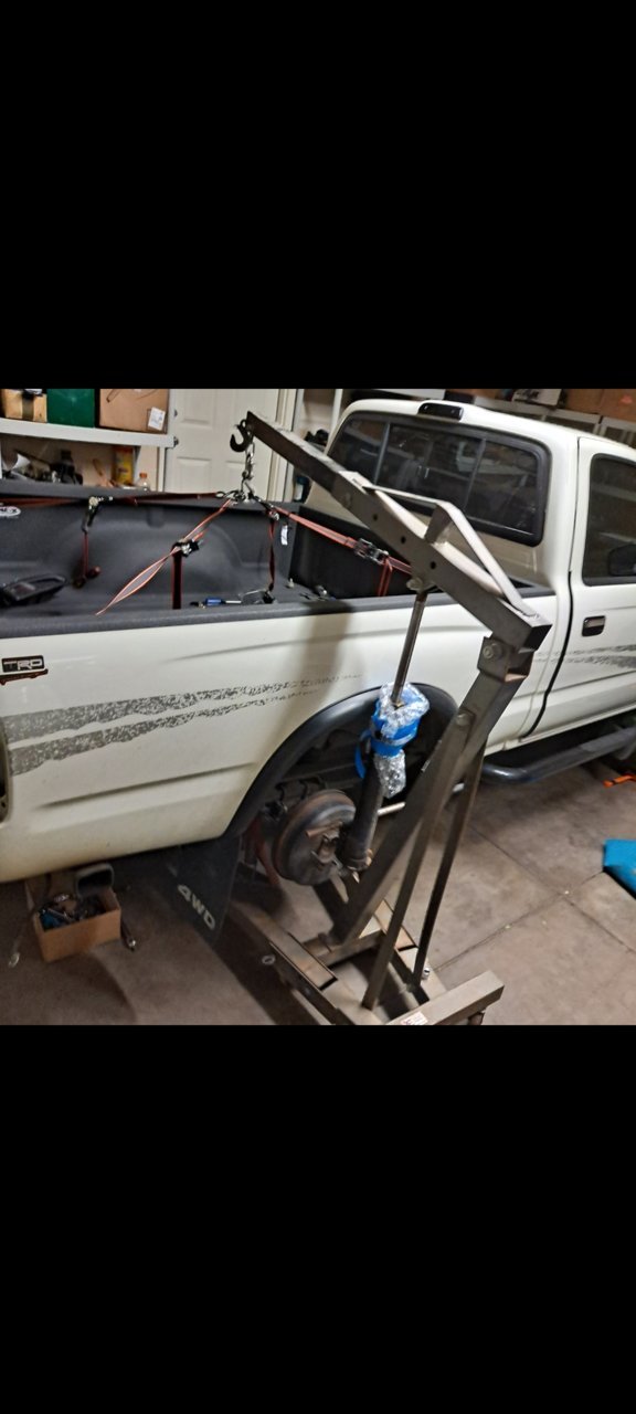

    The Pittsburgh engine hoist works perfectly to remove the bed.
    Took about an hour to get the bed off going slowly,

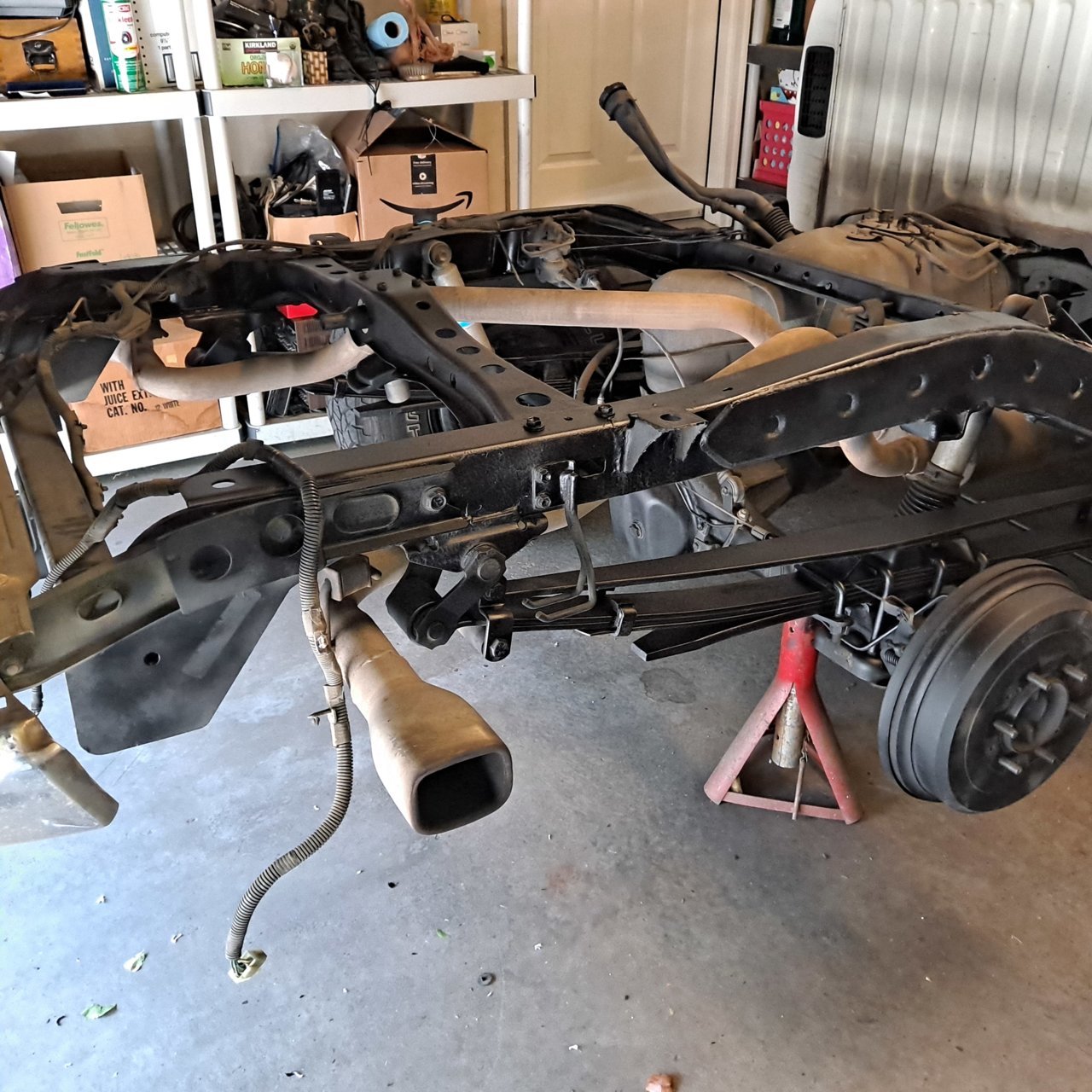

    Then decided to clean up the frame and paint
