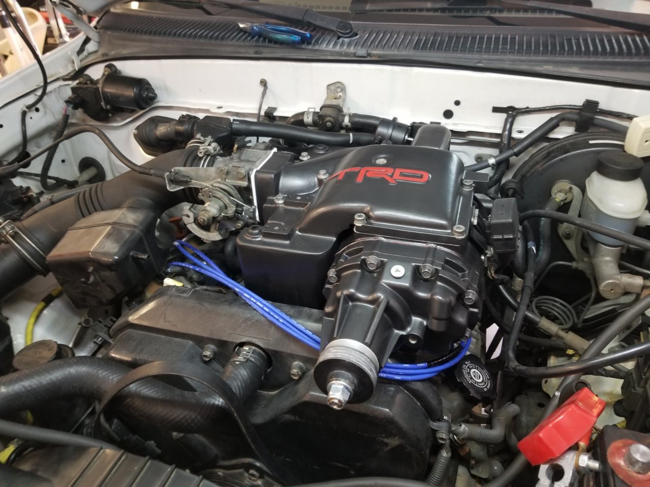

  16. Oct 9, 2021 at 6:53 PM
    #3636
    Billnis
    Billnis Well-Known Member
    Mar 23, 2020
    #322835
    132
    Bill
    Menifee, CA
    2001 White PreRunner Extra Cab 3.4L V6 Oak Int.
    PERFORMANCE: TRD Gen1 Supercharger, Snow Performance Water/Methanol Injection, Toyota E-Locker, Falken Wildpeak Tires, 5100 Bilstein Shocks, Redarc Tow Pro Brake Controller, B&M Transmission Cooler. EXTERIOR: Raptor Spray-on Bedliner, Custom NRT Off Road decals, Chase Rack with Offroad Lights, Fog Lights, Bed Lights, Rear Bumper Lights, Rago Bed Stiffeners, T1A Metal Door Handles, 7-Pin Trailer Connector, Switchback front turn signals, LED tail lights, License Plate Lights Shutoff For Backup Camera. INTERIOR: Android Head Unit with OBD2, Dash Camera, Backup Camera, TPMS, and Hands Free Microphone, Rockville SS8P Subwoofer, Remote Door Locks with Automatic Window Close, RFID Kill Switch, Custom Switch Panel, Hands Free Phone Mount, All LED lights LED, Ignition Light Ring, A pillar two gauge pod with VC-50 Meth Injection Controller and NRT Branded Oil Pressure gauge, Torque Pro App for Gauges (Wideband Air/Fuel, Water Temp, Trans Temp, MAF, Volts, Timing, Engine Load, Intake Temp, Throttle Position, Fuel Status - shows open or closed loop, Instant MPG.)
    Finished the Supercharger installation. Had a few issues along the way I thought I'd share. When we went to start it the first time it ran really bad. wouldn't idle at all, it was most happy when the RPMs were up around 2000. Checked the vacuum connections many times and felt they were all good. We had installed injectors, plugs and wires so we swapped out those to see if that would change things, but it didn't. Swapped out the IAC. After doing a lot of diagnosing we found a large vacuum leak where I had installed the Teflon plate from LCE in between the TB and the SC. Removed it and now it runs great. It may be the lower bolts that mount the TB. Noticed that they are bottoming out in the holes. The factory intake has through holes but the SC holes are blind. Going to put shorter bolts in and see if the Teflon plate can go back on. Once we had the vacuum leak we went for a test drive and it started running rough and continued to get worse. It threw a code, misfire on cylinder 4. swapped that plug and no more problems. I will order a replacement plug.

  17. Oct 9, 2021 at 7:30 PM
    #3637
    1997tacomav6
    1997tacomav6 V6 5sp,RegCab,TVS1320 Supercharger,Haltech, 800k
    Oct 5, 2013
    #113940
    10,419
    John
    Denver
    97 reg cab, v6 5sp 300hp supercharged, Methonal Injection, 800,001 plus miles, Original Owner
    V6 5sp,RegCab,TVS1320 Supercharger, 56mm pulley, methanol injected Haltech ECU, AC Tvs1320 supercharger,(MUST DO) every 125,000- 150,000 needs rebuild Projector headlights HID 5 speed manual Amsoil for all drive train Smaller 56mm custom pulley, (MUST DO) 2004 DESNO fuel injectors, zero ping ping, 2004 side door mirrors Dick Cepek Rims, Michelin tires LTX, ATM Pathfinders Dynopro ATM ( that last 100,000 miles) Now running Dynopro ATM mud and snow tires KN cold air intake Cat back dual exhaust with ss exhaust tip, Raised exhaust tail pipe to 2" below body line Optima*dry cell battery,red top Alpine sirius radio, 200 watt amp, focal is165 split door pod speakers Focal door speakers Subwoffer behind seat Viper alarm, Electric Locks Dark tinted windows, bucket seats corbeau lg1 Tacoma Rubber floor mats TRD fender extenders, Bilstien shocks, King shocks JBA UCA trailer iv hitch, electric brake control, Drilled slotted brakes, High carbon steel (MUST DO) EBS green stuff 7000 series pads(MUST DO) TRD engine oil cap TRD stick shift, Marlin crawl shift kit. Rear sliding window 2002 4Runner functional hood scoop cut into Tacoma hood, 4Runner dual overhead map light Gentex Auto dim + Compass + Temp, garage,rearview mirror Snow Methonal kit stage 2 Custom 3 core aluminum radiator Linex bed liner Haltech stand alone ECU, Intake supercharger gauge. Stainless steel brake lines, Custom leather wrapped steering wheel, Haltech stand-alone ECU,
    You need two step cooler plugs
  18. Oct 9, 2021 at 7:58 PM
    #3638
    Billnis
    Mar 23, 2020
    #322835
    132
    Bill
    Menifee, CA
    I do have DENSO Iridium IK22 Spark Plugs, it was one of them that failed. Need to buy a new one to replace it. For now I put back in one of the stock Denso plugs that were in it till the replacement comes.

  19. Oct 9, 2021 at 9:18 PM
    #3639
    Milor
    Milor Well-Known Member
    May 15, 2018
    #253519
    309
    shaun
    03 Tacoma sr5 .TrD offroad 5spd..
    supercharged 2" pulley 6 puck clutch
    whats the teflon plate for? what size pulley is that?
  20. Oct 9, 2021 at 11:55 PM
    #3640
    Billnis
    Mar 23, 2020
    #322835
    132
    Bill
    Menifee, CA
    Gasket
    Stock pulley, I may get a smaller one after the methanol injection.
