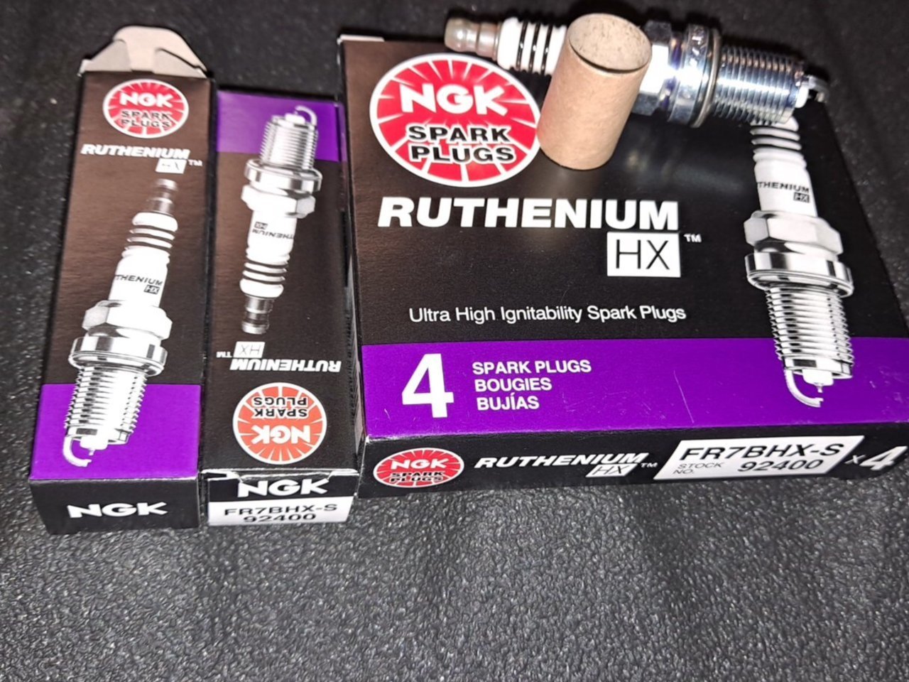

    Try these, available at advanced auto

    Thanks for the suggestion but I think I'll just buy one replacement for the Denso Iridium that is bad. Seems like a waste to buy all new ones when everything is running well. I knew about the NGKs, but went with the Denso.

    I run these ngk's now as well. i think they are better but the ik22s aren't bad

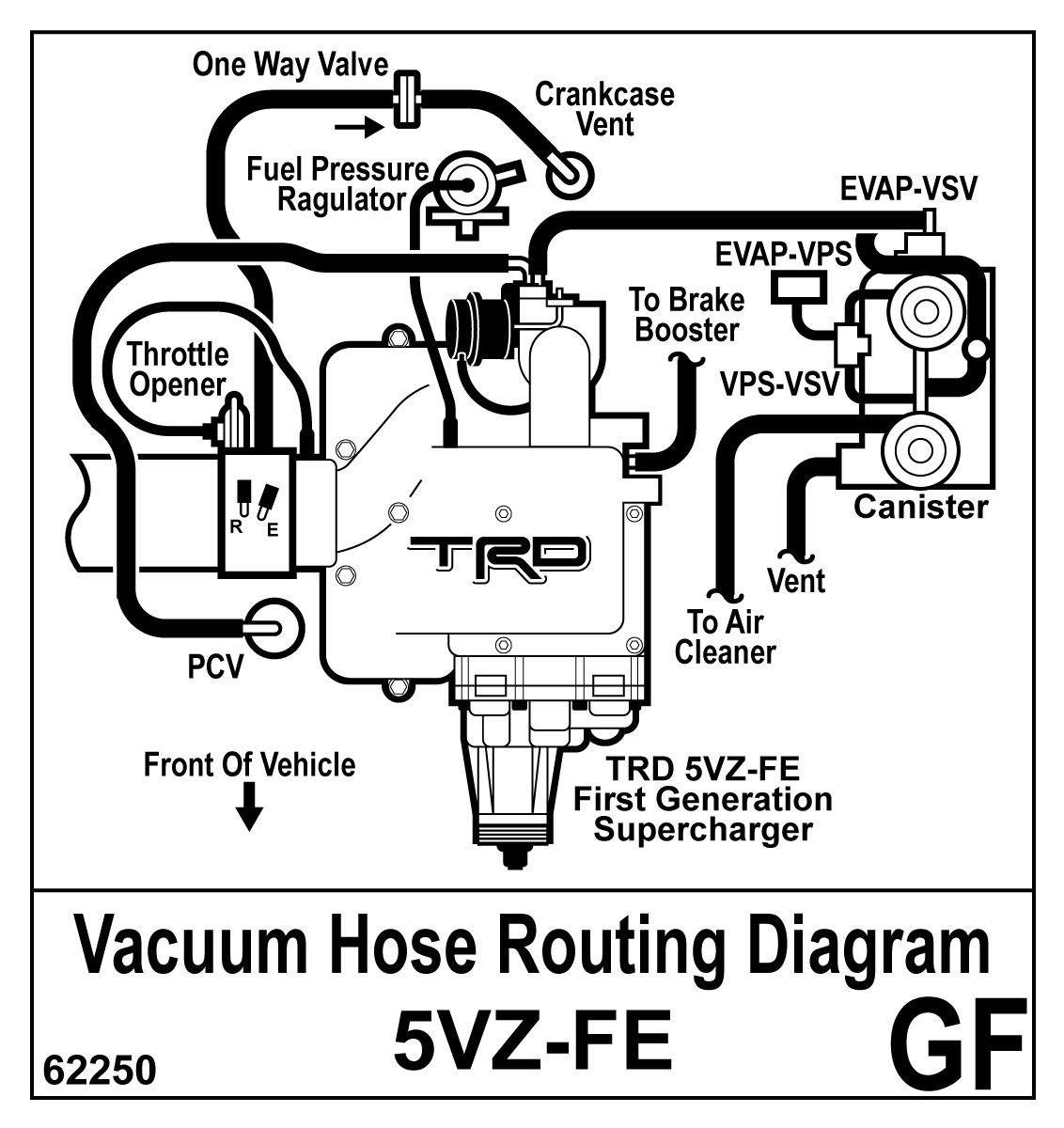

    I created this new sticker to replace the one under the hood.
    Accurate for my 2001 2WD, seems there are quite a few different vacuum routings for other models.
