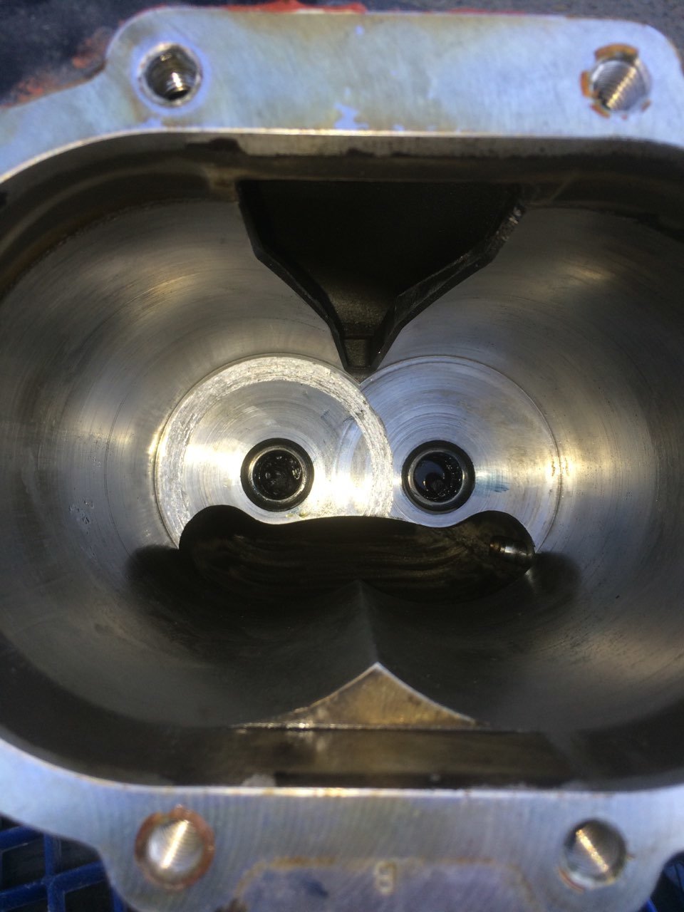

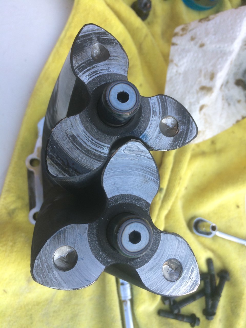

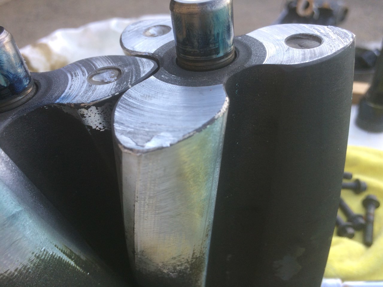

    Did you install this unit from brand new? How many miles are on it?
    Do you think Magnuson will honor their warranty if this unit has been disassembled?

    If I remember correctly it was new and has 12,000 miles on it now

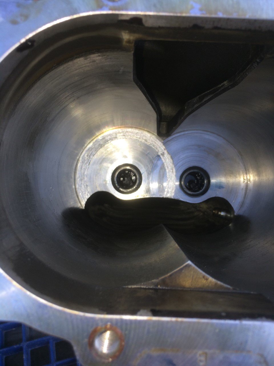

    I bought it october 2019 brand new. there is about 12k on it. I don't see why they wouldn't with it disassembled. you can see it is theirown gasketmaker they use on the face surface. so its never been re assembled. I took it apart thinking it was a nosecone problem that I could fix myself. tough break... maybe now is a good time to get it ported? definitely going methanol when it goes back on.
