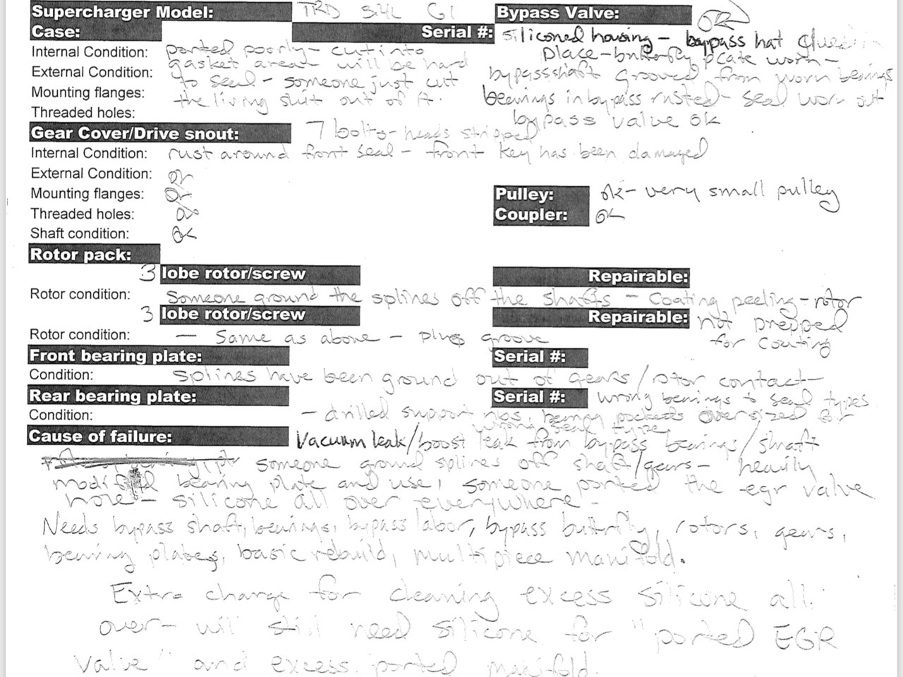

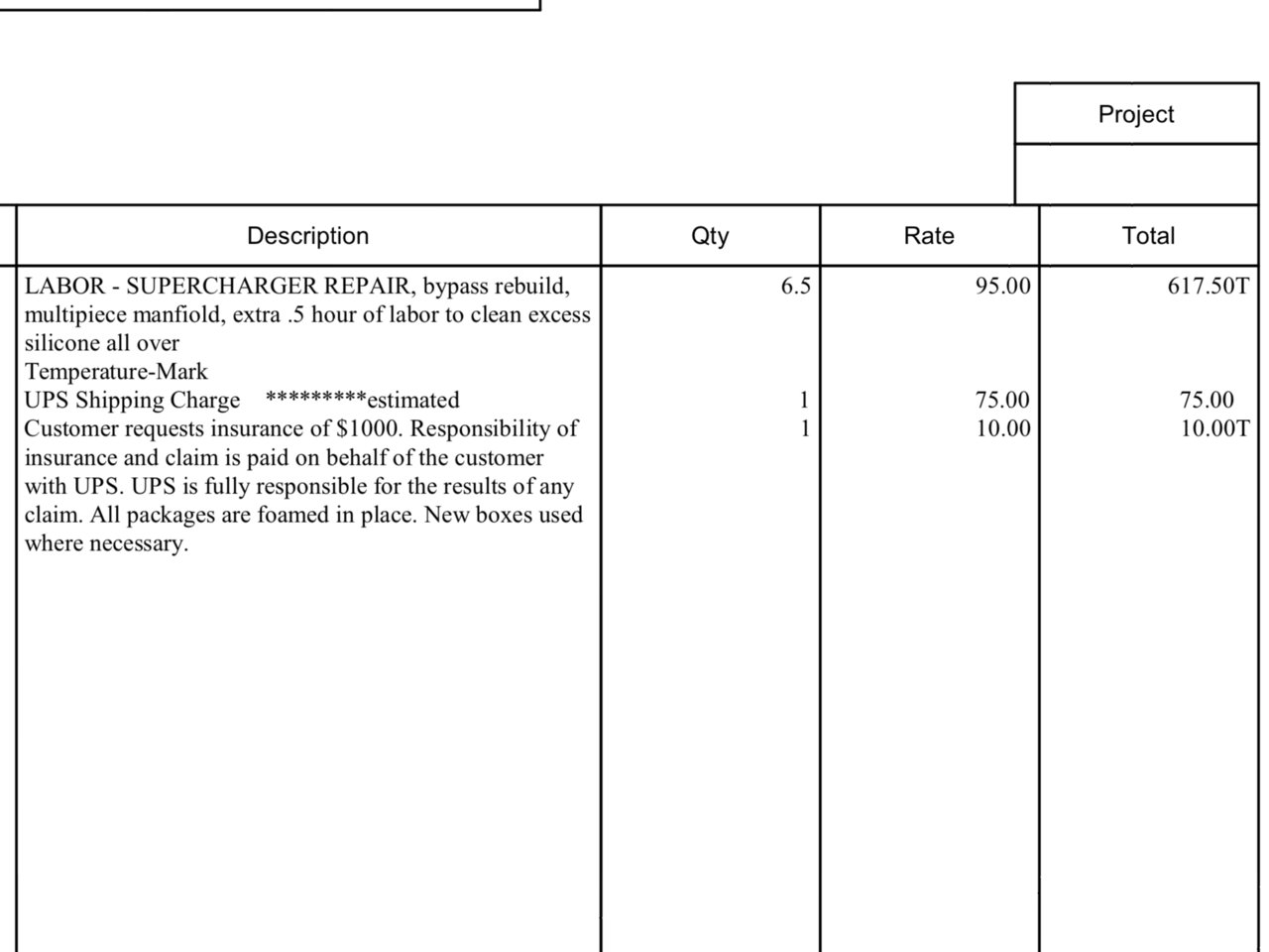

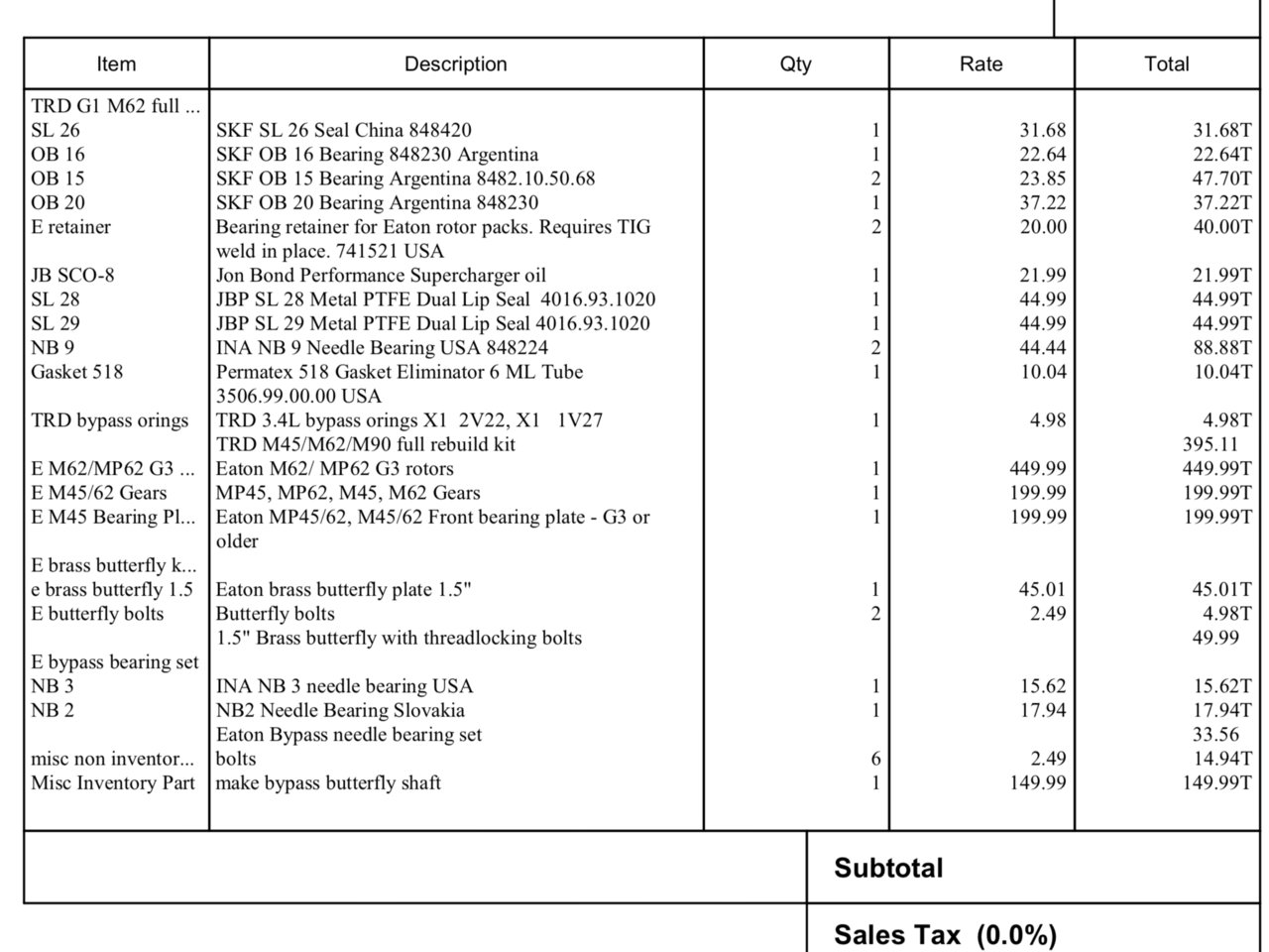

    Got my inspection from Jon Bond today,
    They said just about everything that was done a year ago for 1500.00 by High Speed Lab was a disaster.
    One of the worst rebuilt jobs that they have had to fix.
    It’s going to cost 2000.00 to fix all the screw ups that HSL did and they just rebuilt it last year less than 30k miles but past warranty of 12 months.
    1)The rotors and gears both have to be replaced because the splines were ground down and don’t stay in place.
    2) the thermal coating is half gone because the rotors were not prepared correctly.
    3) bypass bearings shot
    4) bypass sections were sealed with gasket maker instead of O RINGS,
    5) rotor pack seals were glued in with gasket maker to keep seals in place because he used the incorrect rotor seals, to small, and the nose oil was leaking pass these seals into the rotors.
    6) boost vacuum leaking at the bypass valve bearing area
    7) inside of case was coated with silicone.
    8) a new rotor pack plate is needed because the old one was drilled out.
    ALL I CAN SAY IS IT COST ME TWICE AS MUCH PLUS BECAUSE OF THE POOR WORKMANSHIP
    Here is my work sheet and all the parts that have to be replaced from Jon Bond to fix HIGH SPEEDS poor workmanship errors.
    You can probably use this sheet for parts and prices for yourself if needed.
    I have the grey 1st gen supercharger.
    The only GOOD NEWS was running the 1.9” pulley shows normal wear to the bearings.

    wow they destroyed your gen 1. damn shame. can they fix the egr area with weld or is that just going to be done with silicone?

    Not sure at this time, I think they should be able to weld to fill in and then grind it or drill.
    It's not a weight bearing area, so I'm not to worried about that section

    its a boost leak issue though. if they cut it as bad as it sounds the silicone might fail under your 12-14 psi of boost

    He said the boost leak was by the bypass housing shaft if I remember.
    He said it all can be fixed but it was a hack job of a rebuild
