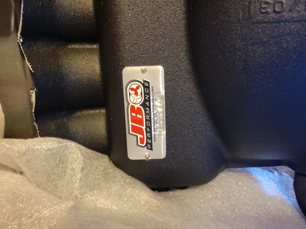

    Got mine back from JonBondPerformance after roughly ~2 months. Did an incredible job with the powder coat, don't have any doubts that just as much care was taken with the rebuild itself. +1 happy customer:D

    Now lets see it back on the truck!
    Looks great

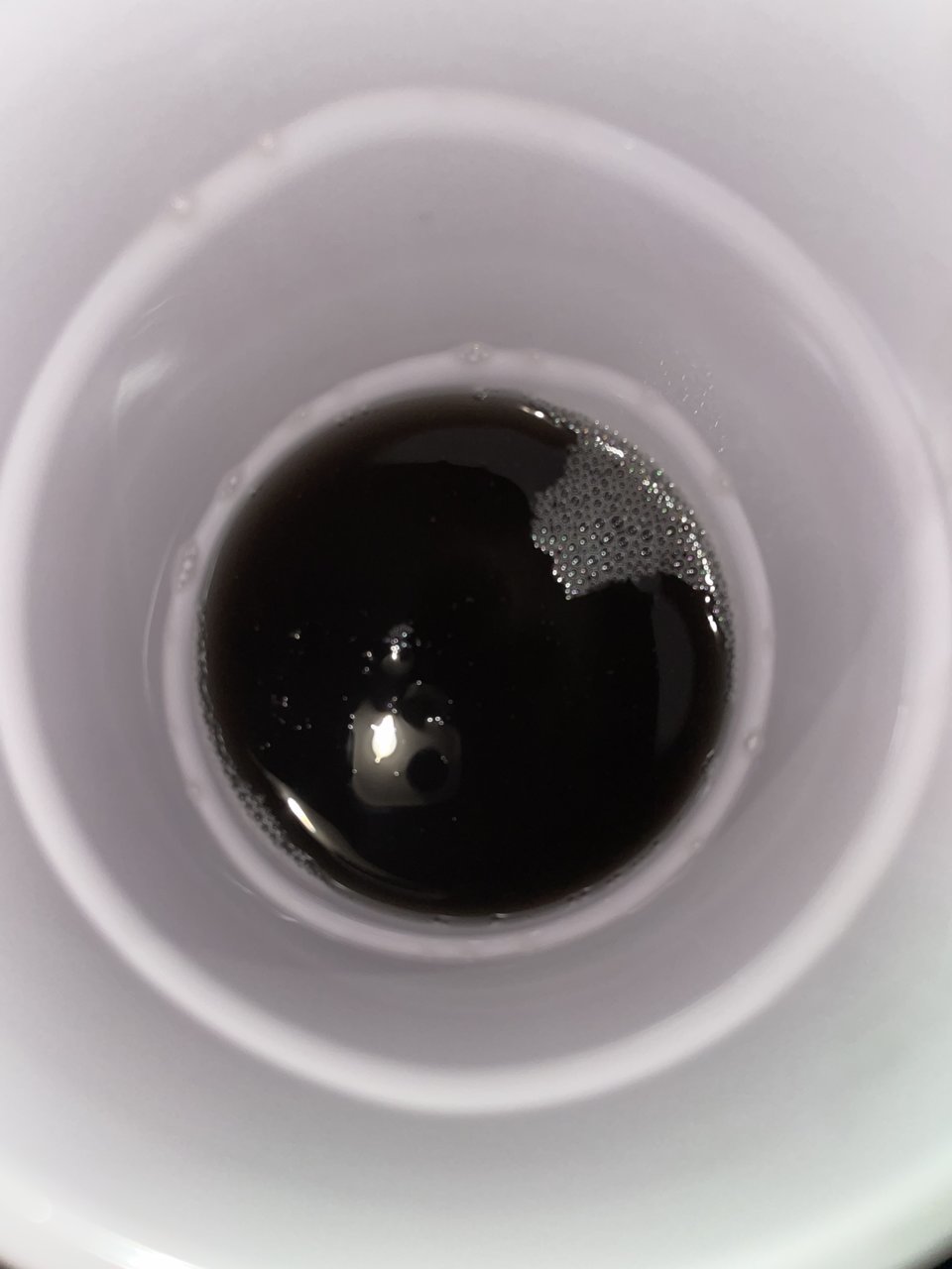

    So reposting this here from another thread. Had some problems after a rebuild.

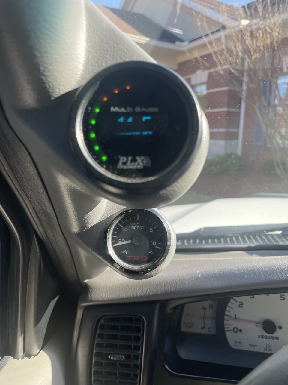

    Is >20 a normal vacuum reading at idle? AFR is 14.6

    #3753
    eon_blue
    eon_blue Okayest Member
    Mar 4, 2016
    #180213
    69,326
    Azusa, CA
    I'm 99.9% sure that's normal but I'll verify when I get into my truck after work

    2002 White TRD double cab
    Thanks! I thought so too but wanted to confirm. This was while parked by the way; if i'm idling in Drive it holds around 18. Getting peak boost at 8-9 PSI. Feels really healthy.

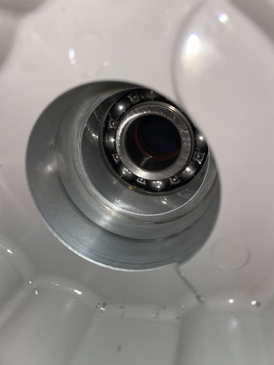

    I’m planning on pulling it off and using Permatex sleeve retaining compound for the bearing in the nosecone. Gonna also try cleaning the TB while I have the nosecone off and curing. I have the grey supercharger so no chance at getting a new nosecone if it gets screwed up.

    Update. Pulled the nosecone to repress the bearing. This is what the brand new oil looked like along with the bearing in question. I wasn’t able to find metal shavings in the housing and while you can see the little lip where the bearing was, I can’t feel anything along the line.
    @1997tacomav6
    I’d say I saved it. Only problem is, I don’t have any more supercharger oil.
    unstpible and 1997tacomav6 like this.

    I get mine from the local Chevy dealership, they usually have supercharger oil in stock

    So I’m getting a rotor sent out from the high speed lab after thanksgiving. It will have the oil in it as well but I need the truck running to make it home before then. Would running synthetic 10w-30 for 6 hours of driving be all that bad for it? I’ll have a new bearing plate, gears and new bearings if need be. I got the bearing re-pressed in only using a actual press this time. No hammer mechanics involved. Seemed to fit much more snug. I still put a small layer of the sleeve retainer on but when I rotated it, didn’t see anything.

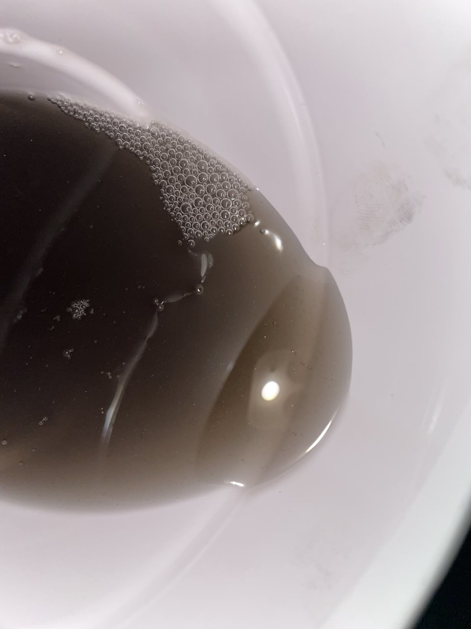

    Also back to the oil. I might try running it through some doubled up coffee filters and see what it looks like. If it takes out a good amount of the particulate on the first pass, I might keep filtering it to re-use the old oil. I admittedly used the full 8 ounces I was sent so if I lose some filtering it all out to run it for 8 hours total I don’t think it will cause too much harm.
