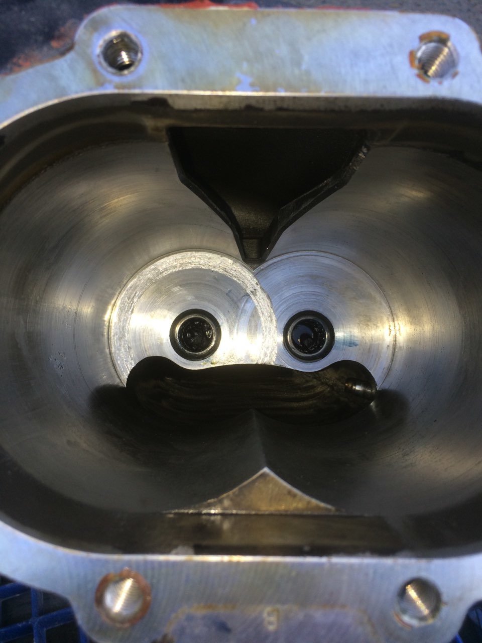

    Yeah I’m pulling the rotors out to inspect. I’ve heard that some of the other versions of the MP62 supercharger can run Mobil 1 Synthetic 10w30 for short periods of time. If all else fails I have the normal alternator belt. I can only hear the rotor noise when the engines running. If I spin it by hand I can’t feel/hear anything out of the ordinary with it. This things killing me. I might cancel the parts from HSL and see what jon bonds turn around time is for a rebuild. I don’t have the old intake manifold otherwise I’d already be working on getting it sent to them.

    Looks about the same as when I pulled it the first time. I had it running long enough to mark up wherever it was making contact. I want to check the bearings to make sure the outer races aren’t spinning at all somehow.

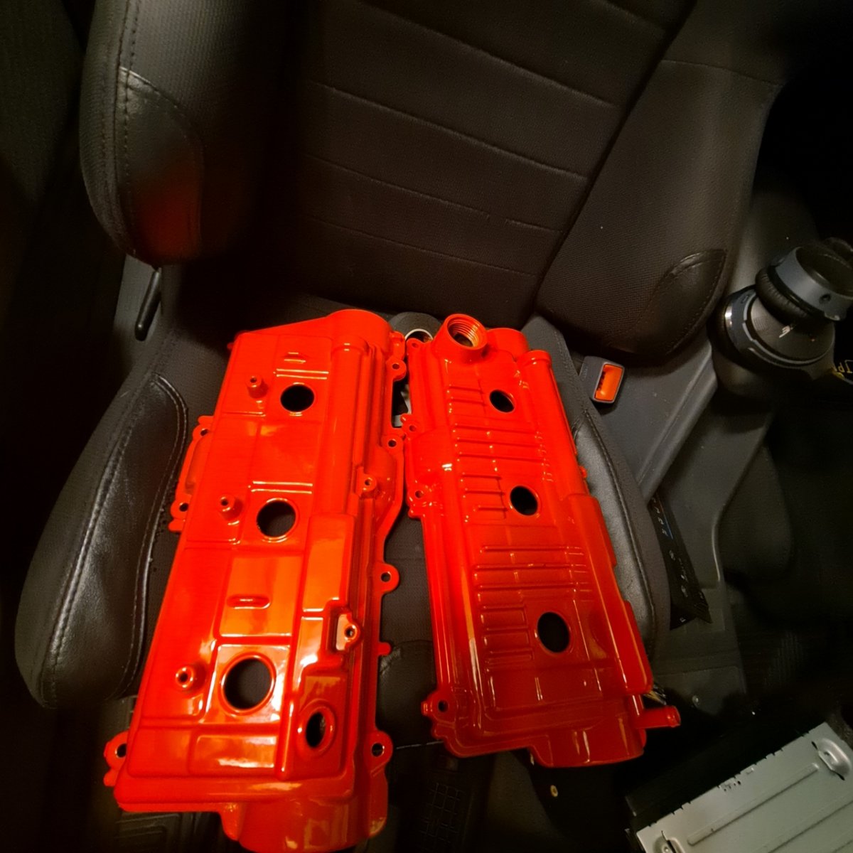

    we should have a loaner program on here for stock stuff while the superchargers are down. My blower is going back on today! I anodize painted my valve covers candy apple red. Ignore the snowboard I bought It just happened to show up the same dayIMG_4453.jpg

    Just got my covers repainted too

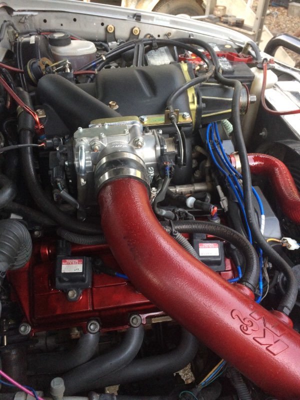

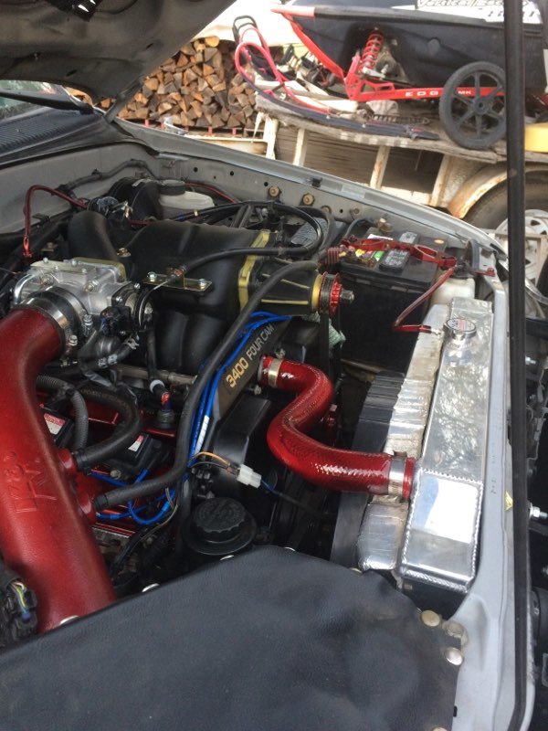

  20. Nov 29, 2021 at 6:53 PM
    #3780
    Milor
    Milor Well-Known Member
    May 15, 2018
    #253519
    309
    shaun
    03 Tacoma sr5 .TrD offroad 5spd..
    supercharged 2" pulley 6 puck clutch
    I just finished getting my truck back running with the supercharger.Didn't get the methanol kit on it yet. but It is quick... my engine bay is a work in progress. I had some fun with some paint and still need to clean up some wiring.. so the paint is annodizing paint so its see-thru. I'm waiting for my colored radiator hose/ hose kit and supercharger badges
