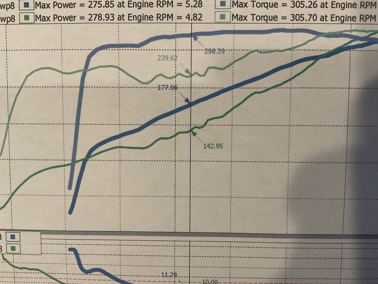

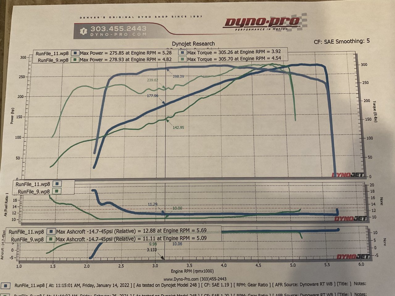

    Update with dyno with 91 octane only, No methanol.
    At 6000 feet.
    The haltech is 90 percent tuned, we ran short on time to finish the top rpm section and the methanol switch and I had a dyno already setup.
    So the top rpm’s are just a bit soft, not fully tuned.
    The results are in and what you can expect.
    The haltech is definitely the SILVER BULLET for the supercharger tune and probably the turbo.
    My max hp at 5000 rpm’s and torque will be pretty close to the same with the supercharger with the stock ECU and Haltech AT 5000 rpm’s.
    BUT THE HUGE DIFFERENCE IS,
    The new power band you get at 2500 to 4500 rpm’s.
    This is typical where we run our motors at probably 80-90 percent of the time anyways,
    So the top rpm’s hp is not really that important here.
    The graph in green is the stock ECU a year ago
    The graph in blue Is the Haltech ECU today.
    The AFR, torque and hp curves are super clean and linear now.
    The torque gains are as much as 60 pounds of more torque 2k-4k rpm’s,WOW!
    AT around 3k rpm’s the stock ECU is at 239 pounds of torque and the Haltech is at 298
    At around 3k rpm’s the stock ECU is at 142 hp and the haltech is at 177hp
    The HP gains are as much as 35 more horsepower 2k-4k rpm’s.
    The sweet spot is 3k-4k she pulls so hard with the extra 60 foot pounds in any gear!
    Gas mileage is about the same
    Redline was raised a bit too
    I’m super happy with this upgrade and special thanks to Gabe For making these available for the 3.4 motor and his tune.
    It definitely turns the 3.4 supercharger motor into the beast it can only get through this HALTECH setup.
    At 680,000 miles my truck has never run so well or had so much useable power.
    http://www.snpspeed.com/
    This was also done using my stock injectors, some of the 3.4 this will pass and some it might not depending on your motor.
    [/QUOTE]
    Those are great gains low to mid range! and on 91 octane...about 280 wheel with 305 torqs at 6000ft with no methanol! do you know what the Density altitude was by chance?

    Those are great gains low to mid range! and on 91 octane...about 280 wheel with 305 torqs at 6000ft with no methanol! do you know what the Density altitude was by chance?[/QUOTE]
    The dynojet is showing a correction factor for density altitude already so technically these are his numbers at sea level and some median temp I think.
  6. Jan 14, 2022 at 8:37 PM

    The dynojet is showing a correction factor for density altitude already so technically these are his numbers at sea level and some median temp I think.[/QUOTE]
    This is how dyno number are mostly done, my 1st numbers with PFI were actually 280 hp rear wheel but the altitude is lower there

    This is how dyno number are mostly done, my 1st numbers with PFI were actually 280 hp rear wheel but the altitude is lower there[/QUOTE]
    ok that makes sense. how much better would it have been with methanol possibly 20 more hp & torque through the range?

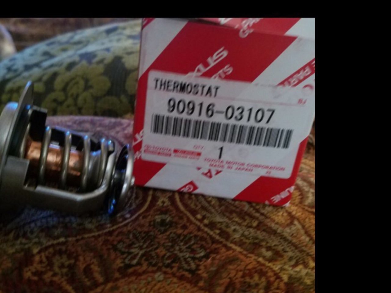

    Do you guys know which 160 degree thermastat works for our trucks? my truck stays cool but rips so much harder right before I'm at my operating temp.

    ok that makes sense. how much better would it have been with methanol possibly 20 more hp & torque through the range?[/QUOTE]
    Don’t really know, the methanol has to be tuned on a separate map,
    I ran the methanol just a little at 20 percent and it just made the AFR TOO RICH

    170 OEM STAT
    were you on your 1.9 or 2" pulley. did not think the stock injectors had enough duty cycle to keep up with the smaller pulleys

    I have the 170. I want to run the colder one.

    were you on your 1.9 or 2" pulley. did not think the stock injectors had enough duty cycle to keep up with the smaller pulleys[/QUOTE]
    Running the 1.9” pulley because I’m at 6000 feet,
    With the haltech Gabe was able to tune it on the stock injectors with plenty of room .
    He said some 3.4 this works and some it doesn’t

    Don’t think they make an OEM 160.
    The aftermarket ones are all crap

    I think there is one out of anothe model that fits that is a 160. pretty sure thats where they used to get the 160s they offered with the supercharger years ago
