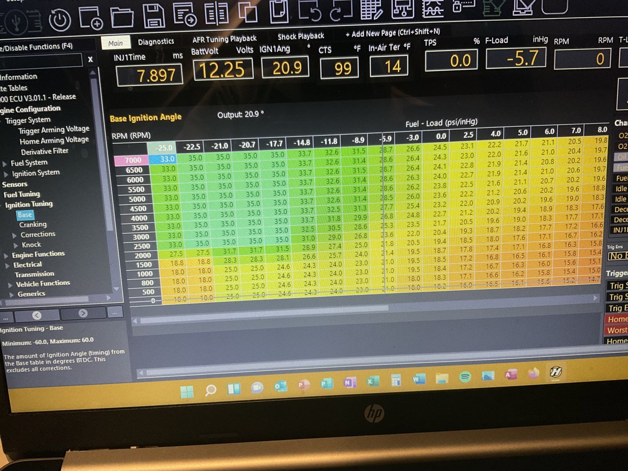

    How about this. Has Gabe ever mentioned what it is in the OEM ECU that kills the low end torque that Toyota and Magnuson has scammed us out of? My guess almost purely timing.
    Milor and unstpible like this.

    with my scan guage during a hard 2nd gear pull the oem computer drops timing down to 12.0 before climbing back up slowly. and thats with the gm knock sensor

    mine is the same under full boost. I want to know if reduce the amount of ignition gets pulled maybe 18-20 under full boost is safe

    i guess we need to ask mr 1997haltech-taco what his timing looks like. thats part of the puzzle the other is obviously where it switches from open loop to closed loop. theres got to be a way around the open closed problem. so watching the boys tune on hondas on the pfi speed youtube channel. there is a company called Hondata that makes a computer chip that they install into the oem computers that allows them to control timing boost and complete tunability.

    I can probably get you a photo of my timing map, it’s an aggressive table,
    I know the knock sensor were modified in the tune setting too.
    The timing is where the power is but has to be done correctly so you don’t blowup the motor.
    3500rpms when tune correctly is your sweet spot

    I think the issue here is that we don’t know where Toyota set the base timing.
    What’s are seeing on the OBD2 devices is timing advance. Not the same thing. There’s still a few variables were blind to without actually being able to get into the OEM ECU to see how it’s set up and how it’s programmed to react to something like knock and load.
    So while it would be cool to see it really dosen’t tell us much in comparison to the OEM ECU.

    Here is my timing table, map.
    We did not have time to finish the complete tune so the top rpm’s area is not fully tuned.
    Next week the rest of the tune will be done.
    Are you using the data logger to look at your tune runs?

    These are the haltech timing numbers setup in the programming map for my tune
