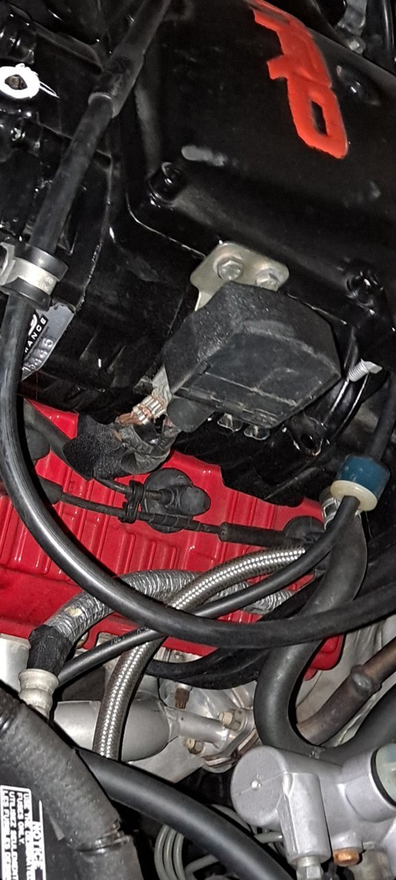

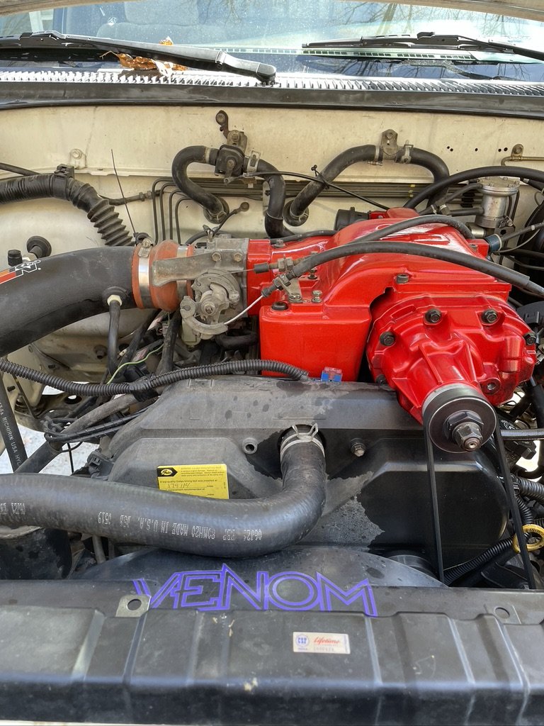

    THIS thread is HUGE! I bought a '98 T100 yesterday, 3.4 with TRD supercharger. This thing will not stay running at idle unless I throw it in neutral. Thinking of removing the charger but will likely try Seafoam, MAF clean, check IAC first. Plugs & wires were just changed. I know little about the 3.4.

    Yeah, lots of possibilities. If you clean the throttle body, remove the IAC first so no gunk gets down into it to further gum up its functionality.
    What fuel management is on the setup now? A 7th injector or the like?

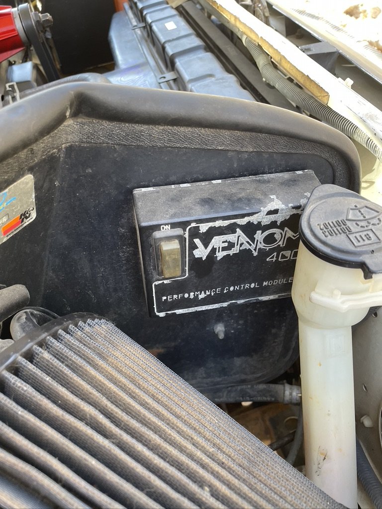

    I have no idea on the fuel mngmt. I'll snap a photo tomorrow when it's not raining & cold, ty for reply.

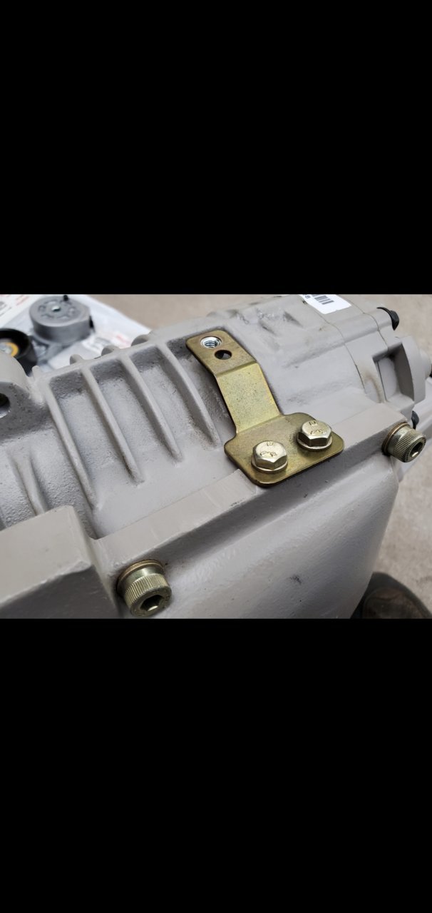

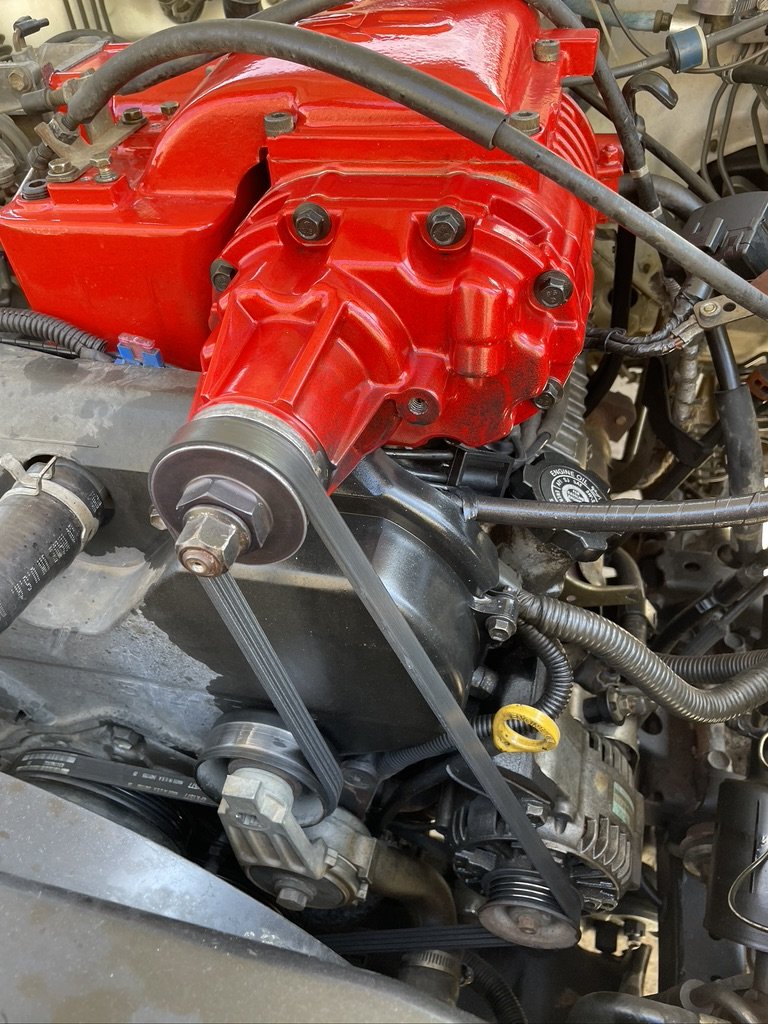

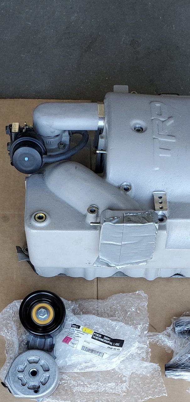

    Finally got the supercharger back from the rebuilder. Rough installed last night and she’s running great. Anyone with a first gen s/c have a picture of your grounding bracket? I don’t have one so I might have to make one.

    @WorldwideTacoma
    Do you mean the engine hook bracket? I can't see one in your picture.
    Also you might look into the nose cone support bracket @mechanicjon makes.

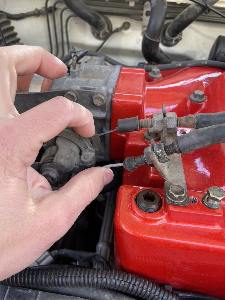

    The engine lift bracket is there. I’m talking the ground that gets attached to the manifold that’s like 2 inches long. I’ve seen some brackets in pictures with two 10mm bolts holding it to the supercharger. For now I used the bracket for the throttle cable, drilled a hole and bolted it temporarily.
    The support bracket will be my next purchase along with spark plugs. My main goal was to make sure I had everything for the initial install.

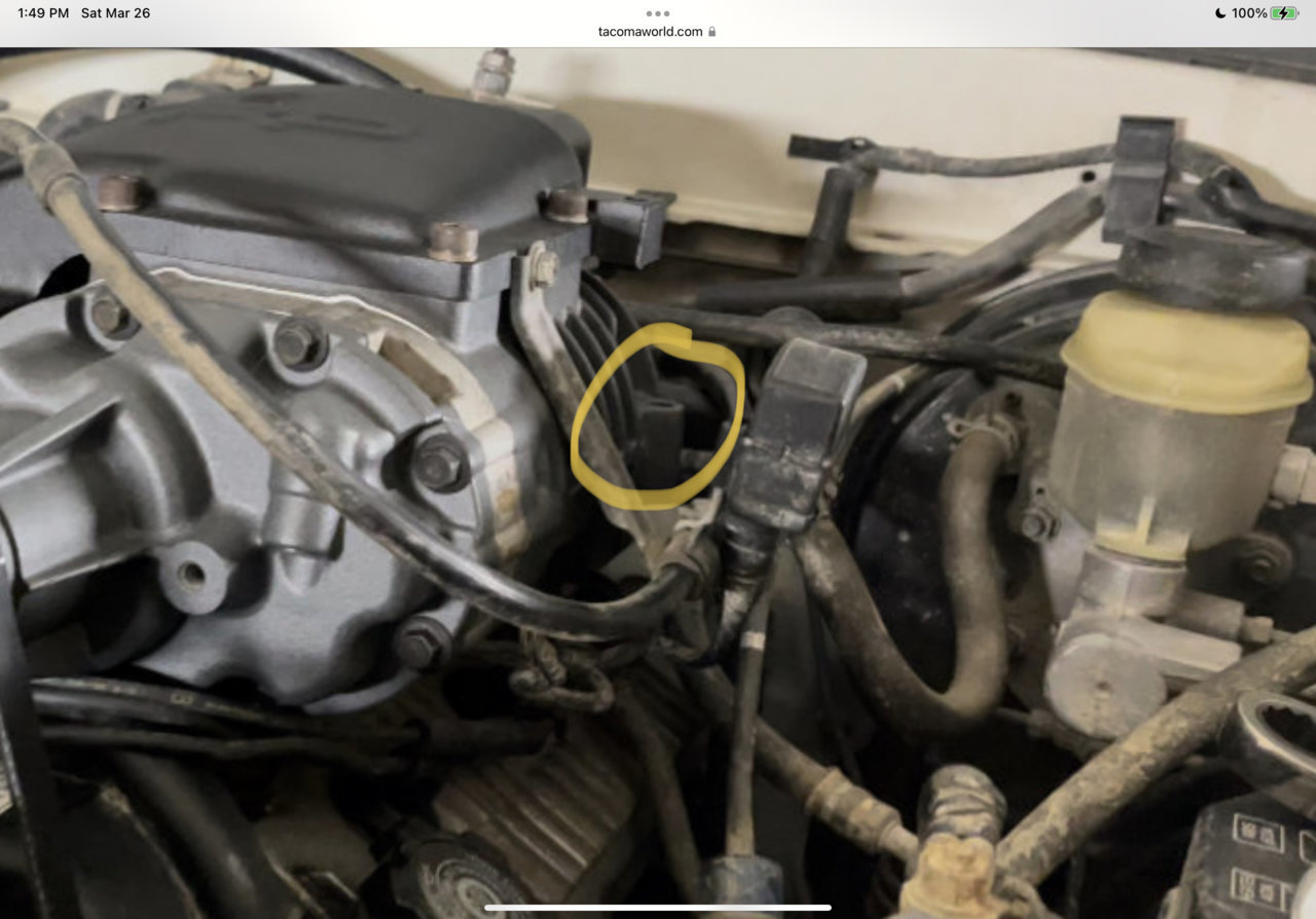

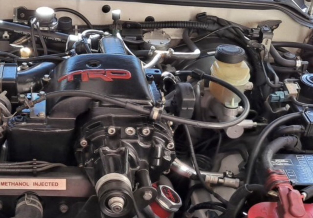

    Your throttle cable is coming off the wrong location and direction, fyi, it should be attached with a bolt ( yellow circle) coming straight out

    Yeah it’s half assed at the moment, definitely missing parts that I will have to source to make it correct. Not too much information out there for our first gen s/c so I appreciate you guys for sure.
    I’ll probably have some more questions to come when I can sit down and go through everything. Just getting back into it after a 3 month tour.

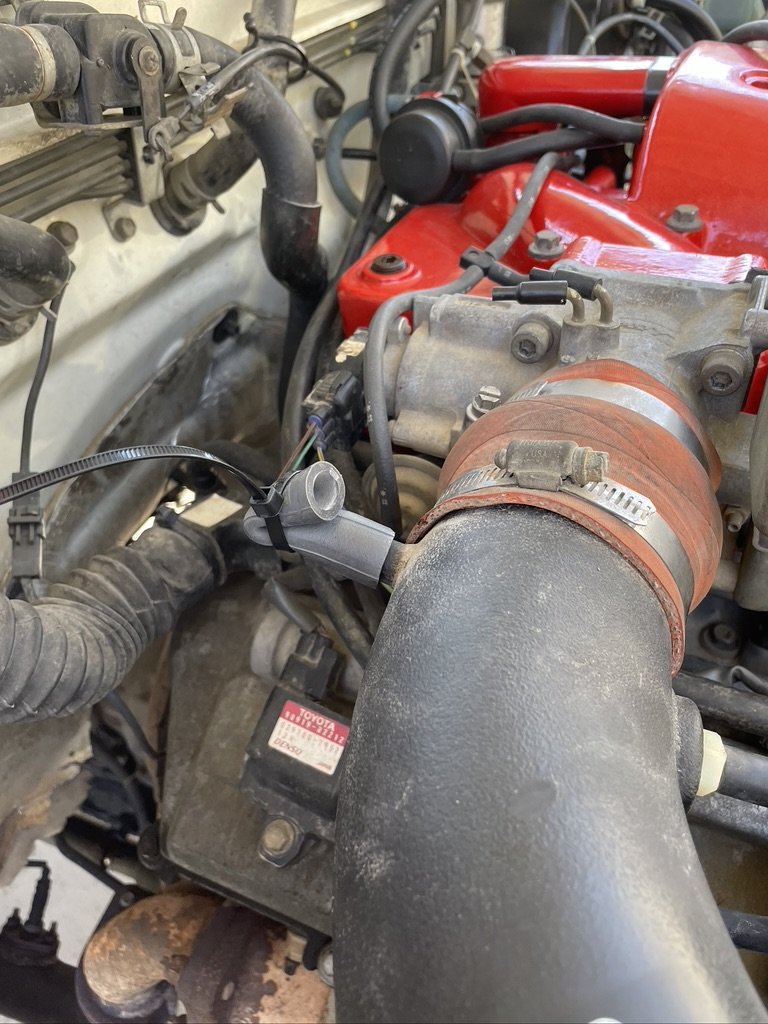

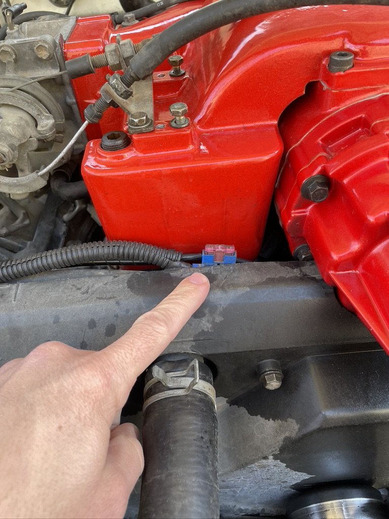

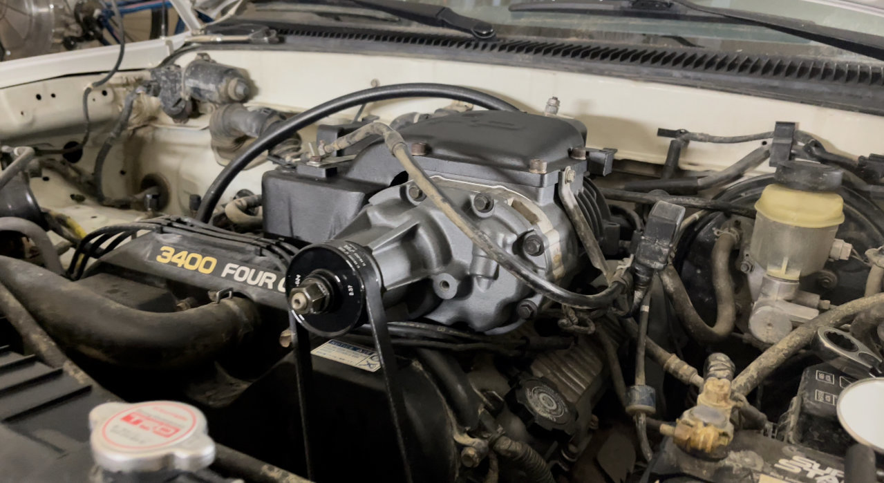

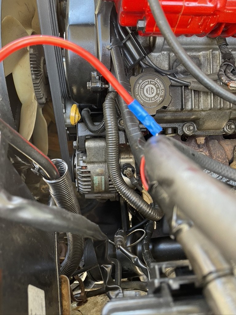

    Not sure what to attempt, let me see if pictures and videos can speak for themselves.. the S/C sounds terrible to me but I have never had one. Not sure on the motor, cannot hear it over this charger.. Throwing P0325 and P0330
    859F4A30-DF40-4B21-B738-F5E4703709C9_1_105_c.jpg A3A57631-359A-40B6-A540-2891E8C9AF12_1_105_c.jpg 04C6597D-5D53-4B6B-B67C-259BAB6131D0_1_105_c.jpg 20763127-07DE-46B2-A20B-1A2B885E6556_1_105_c.jpg 13230875-56C5-45C2-ADAF-CE43B2C6B72C_1_105_c.jpg 4E1F24F4-4DDF-4E0D-8FCA-78252A264962_1_105_c.jpg 22BEFDEA-5C0C-4428-8E12-BCD0343A8DDE_1_105_c.jpg

    @camillethetoy
    Sc will make noise at idle, but a worn coupler will make it sound worse. It may be time to rebuild/overhaul.
    Looks like that fuse could be in the knock sensor wire, but it may be a different wire altogether. Trace it.
    Where is your Pcv vent tube routed? (From passenger valve cover)
    Where is back of driver valve cover vent tube going?
    What spark plugs are you running?
