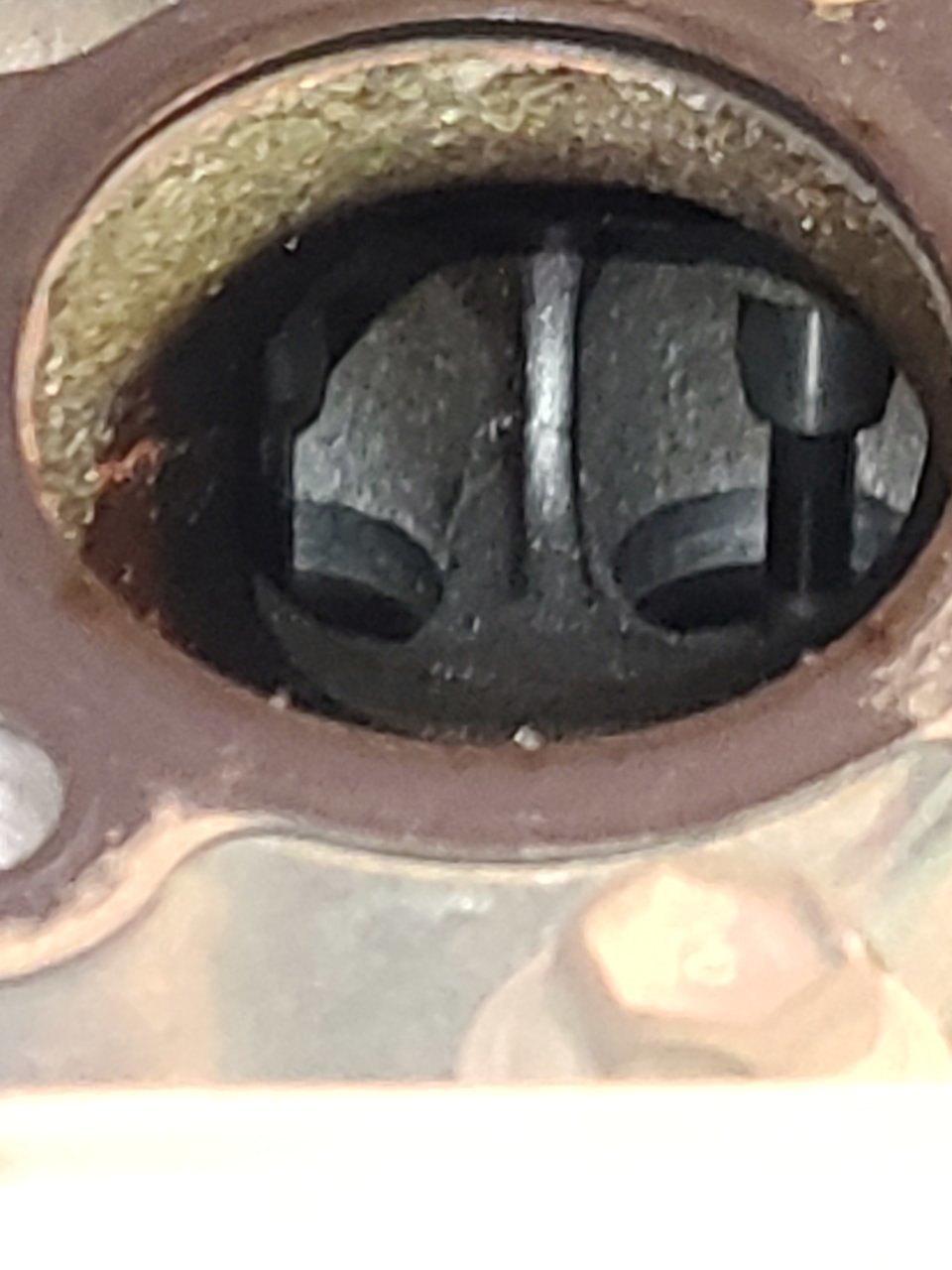

    I never scoped the Pistons when replacing the plugs but all my intake valves looked like this set when I did the injectors and valve cover gaskets. All I've ever used is Redline Fuel System cleaner in the past

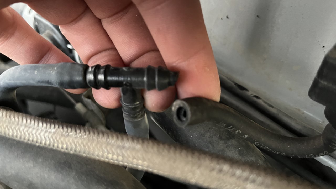

    My vacuum T that split the vacuum line between the boost gauge and the URD box broke yesterday. I thought it was odd that my boost gauge was reading 0psi consistently. Got it fixed up today with a brass fitting so hopefully this won’t happen again! I added some zip ties for good measure after I checked that it was working again.
    FEE9B58E-94E3-4B49-841B-0051E1D445A2.jpg 9DCBF64D-96F4-4FE4-A006-389F758E8A30.jpg

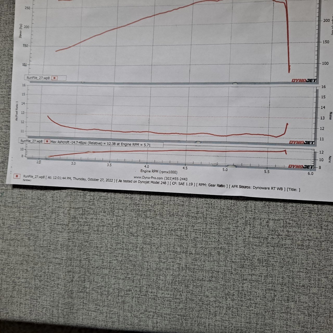

    Just installed this last month 500 miles ago and a dyno done yesterday to show how well it’s working

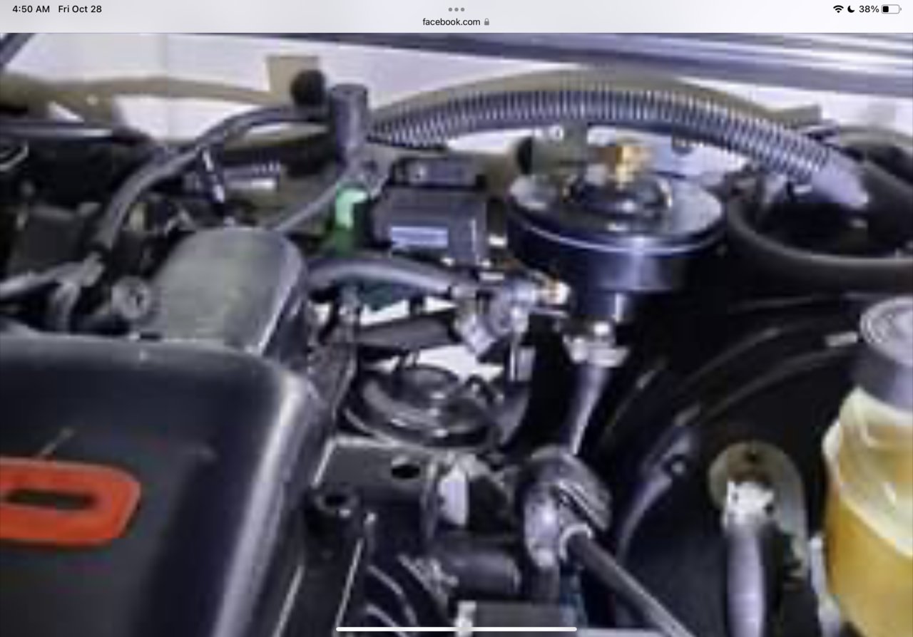

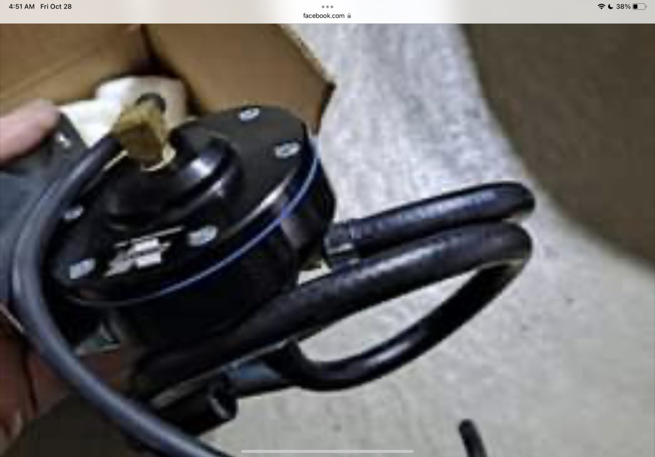

    Vortech FMU INSTALLED
    FMU are not talked about here maybe because others have not tried them or don't know about them

    I've never needed the 7th injector because I have the fmu for added fuel.
    With the 1.9 pulley and stock injectors and stock ecu 340 AEM I had no ping issues at 6000 feet.
    With the haltech I have no ping issues either with the 340 AEM, stock injectors and 1.9 pulley,
    I have 40,000 plus miles with the 340 AEM pump, stock injectors and haltech running perfectly, no issues except inconsistent fmu pressure.

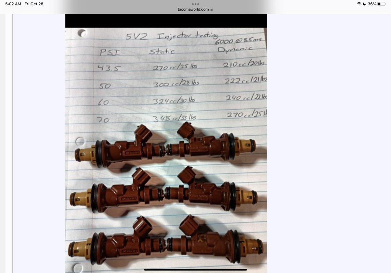

    Gabe Salazar from snpspeed.com has been doing some testing on the stock injectors and he found an ideal high quality FMU and now has a kit with fmu, the precut fuel lines, vacuum line and clamps needed
    This kit I got from him 500 Miles ago and I'm very happy and pleased with its results. I have added a dyno pull done today with the new FMU to see below.
    The AFR from this FMU is very consistent now unlike the TRD FMU.
    Trd stopped using the TRD FMU and rerouted the vacuum hose to the FPR coming off the boosted side of the supercharger giving the fpr a 1:1 rise rate. Unfortunately it doesn't perform as well as a 3:1 actual fmu unit hence some lean issues are found depending.
    FMUs have been around for years and are active when boost starts.
    If you have a haltech and want to keep the stock injectors because of emissions this is an excellent solution,
    If your supercharger is pinging this FMU might solve your lean issues without 7th injector or methanol.
    With any supercharger its highly recommended to
    1) get your injectors cleaned because each one had a fuel filter,
    2) new fuel filter
    3) a high flow fuel pump,,
    4) 2 stage cooler plugs
    Alot of people don't do this and immediately think they need a 7th injector or methanol
    An FMU will add more fuel pressure to the injectors once in boost 3 to 1 riase rate for this specific fmu and a 270cc injector becomes a 340cc with the add pressure as it rises slowly per pound of boost
    Here is a flow test done by Gabe Salazar below.
    Ideally you want larger injectors but the FMU can cover the spread for stock injectors.
    For me the FMU over the last 700,000 supercharged miles has been a great solution for no lean issues without having to reinstall injectors for emissions.
    My fmu situation that works is 6000 feet, 340 AEM fuel pump, you can use a smaller one, 1.9" custom pulley, injectors are stock that have been rebuilt.
    Puts out 282hp and 305lbs torque at rear wheel.
    Gabe Salazar is selling these vortech FMUs as he is an authorized dealer for them.
    There are lots of fake, take offs FMUs available but with the original vortech you can count on the performance and quality,
    Installation is pretty easy but the supercharger needs to be removed to access the stock fpr,
    You need to replace that hose with the High pressure hose and the higher pressure hose clamps that are part of the kit. NOT a pressure clamp or screw type clamps. The new FMU is installed in series.
    So if you're having lean issues at the boosted rpms this might be an easy solution,
    This vortech FMU can be rebuilt and you can change discs for different rise rates

    V6 5sp,RegCab,TVS1320 Supercharger, 56mm pulley, methanol injected Haltech ECU, AC Tvs1320 supercharger,(MUST DO) every 125,000- 150,000 needs rebuild Projector headlights HID 5 speed manual Amsoil for all drive train Smaller 56mm custom pulley, (MUST DO) 2004 DESNO fuel injectors, zero ping ping, 2004 side door mirrors Dick Cepek Rims, Michelin tires LTX, ATM Pathfinders Dynopro ATM ( that last 100,000 miles) Now running Dynopro ATM mud and snow tires KN cold air intake Cat back dual exhaust with ss exhaust tip, Raised exhaust tail pipe to 2" below body line Optima*dry cell battery,red top Alpine sirius radio, 200 watt amp, focal is165 split door pod speakers Focal door speakers Subwoffer behind seat Viper alarm, Electric Locks Dark tinted windows, bucket seats corbeau lg1 Tacoma Rubber floor mats TRD fender extenders, Bilstien shocks, King shocks JBA UCA trailer iv hitch, electric brake control, Drilled slotted brakes, High carbon steel (MUST DO) EBS green stuff 7000 series pads(MUST DO) TRD engine oil cap TRD stick shift, Marlin crawl shift kit. Rear sliding window 2002 4Runner functional hood scoop cut into Tacoma hood, 4Runner dual overhead map light Gentex Auto dim + Compass + Temp, garage,rearview mirror Snow Methonal kit stage 2 Custom 3 core aluminum radiator Linex bed liner Haltech stand alone ECU, Intake supercharger gauge. Stainless steel brake lines, Custom leather wrapped steering wheel, Haltech stand-alone ECU,
    I’m on my original cat at 720,000 miles all supercharged so I’m not sure if that will be an issue as long as you keep your AFR in a happy spot.
    You should look into adding an FMU if your having lean issues still.
