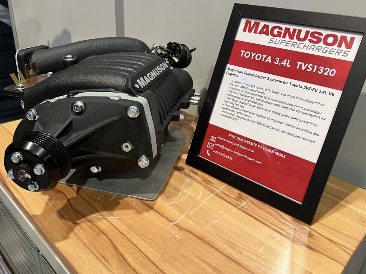

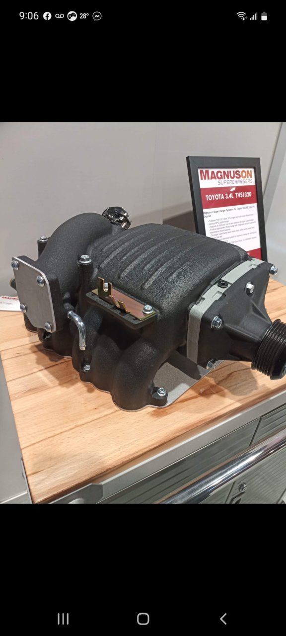

  5. Nov 3, 2022 at 9:46 AM
    #4125
    eon_blue
    Mar 4, 2016
    #180213
    69,616
    Azusa, CA
    Everyone that just bought a brand new MP62 supercharger is probably saying wtf right now
    That's awesome they are still developing new stuff for this engine. The built in intercooler system is a big upgrade over ours.
    1997tacomav6 likes this.

    Wait what? Intercooler? Got a link to info?

    V6 5sp,RegCab,TVS1320 Supercharger, 56mm pulley, methanol injected Haltech ECU, AC Tvs1320 supercharger,(MUST DO) every 125,000- 150,000 needs rebuild Projector headlights HID 5 speed manual Amsoil for all drive train Smaller 56mm custom pulley, (MUST DO) 2004 DESNO fuel injectors, zero ping ping, 2004 side door mirrors Dick Cepek Rims, Michelin tires LTX, ATM Pathfinders Dynopro ATM ( that last 100,000 miles) Now running Dynopro ATM mud and snow tires KN cold air intake Cat back dual exhaust with ss exhaust tip, Raised exhaust tail pipe to 2" below body line Optima*dry cell battery,red top Alpine sirius radio, 200 watt amp, focal is165 split door pod speakers Focal door speakers Subwoffer behind seat Viper alarm, Electric Locks Dark tinted windows, bucket seats corbeau lg1 Tacoma Rubber floor mats TRD fender extenders, Bilstien shocks, King shocks JBA UCA trailer iv hitch, electric brake control, Drilled slotted brakes, High carbon steel (MUST DO) EBS green stuff 7000 series pads(MUST DO) TRD engine oil cap TRD stick shift, Marlin crawl shift kit. Rear sliding window 2002 4Runner functional hood scoop cut into Tacoma hood, 4Runner dual overhead map light Gentex Auto dim + Compass + Temp, garage,rearview mirror Snow Methonal kit stage 2 Custom 3 core aluminum radiator Linex bed liner Haltech stand alone ECU, Intake supercharger gauge. Stainless steel brake lines, Custom leather wrapped steering wheel, Haltech stand-alone ECU,
    Gabe Salazar
    Just talked to Gabe who is at the Sema show in California and was talking to Magnuson.
    The supercharger will NOT have an inner cooler.
    The rotors will be a newer more efficient design,
    Rotors will be 30 percent larger turning slower making less heat.
    BUT cfm will be the same.
    I guess a small pulley will create more air flow at the end of the day tho than the old supercharger,
    Supercharger is still in development,
    They may try to get the output to a higher number then the old supercharger with the stock pulley.
    End of summer ETA,
    Again it’s still being developed,
    They need to get it to the 300hp line in my opinion

    Booooo! I WOULD have pulled the trigger if it did, but not now... darn.
    "no calibration needed"
    Doubt. I doubt the efficiency gain is enough to make us pingy types no longer ping. And for the non-pingers you will still be loosing out on power, just look at the piggyback gains and then the even bigger gains of Haltech peeps.
    IMO short of EMS the only thing they could do on their end to really nip low gear/low RPM high boost ping is to make the mechanical calibration or electrically control the bypass valve to simply not allow as much boost in lower RPMs.

    It'll need an intercooler for me to do a swap with my 2nd gen supercharger.

    Weird that the info card in the photo says it's intercooled, when it's not? Unless I'm reading it wrong.
    "High efficiency intercooler system for maximum charge air cooling and sustainable performance"
    unless they just pulled that bit off the description for the same blower for the 2nd gen Tacomas, which does have an intercooler.

    I think that’s the same model number as the 4.0 supercharger. Couldn’t actually find this one on their website.
    I just received mine in thw mail. It’s still in the box!

    From GABE SALAZAR at the SEAM show,
    “The reason for the upgrade is tooling, it’s not really an upgrade it’s a replacement for there existing tooling‘s they’ve been using since the 90s that is worn out so they had to make a decision between rebuilding their own tooling, continuing to use the existing rotors or creating a new design with more efficient rotors and by doing a new efficient rotors to help reduce the amount of air temperature.”
    “The misconception of the wording so while at the Sema 2022 decide to get the answers the truth is they are going to a new rotor design that will make the new supercharger more efficient which will reduce heat but it will not make any more additional power.
    the new changes are due to tooling changes more than an upgraded supercharger and what you see is a 3-D print of the new supercharger,”
    ETA is late summer,
    The new supercharger will be more efficient spinning slower with 30 percent larger rotors with more air flow making less heat but the same hp because of emissions standards, (CARB certification) supercharger has to be the same specific, if they change that the new supercharger would have to be installed on each year truck to see if it passes.
    So theoretically you will be able to get more power available over the old design if a smaller pulley is used because the new supercharger rotors will be pushing more air then the old rotor design if compared at the same rpms.
    Because this supercharger is in the design stage it’s not known what the CFM is compared to the older supercharger at the same rpm’s.
    If the new rotors pushed 30 percent more air theoretically there would be a nice potential for more power at the same rpm’s with a smaller pulley over the old supercharger.
    Their is NO intercooler in this supercharger!
    Price is not set but will be maybe a little higher

    Well, it’s gonna be a race to get ‘em apparently. That’s awesome an intercooler and larger supercharger, aftermarket control mods mean we’ll be able to add some horseys when this comes out. I’m gonna be saving for the year so I can plop one on my single cab manual and then my 4 door will be sad

    No intercooler, that was an error, it’s still in development, ETA end of summer next year
