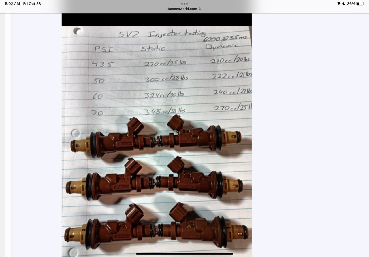

    I bet if you do the check list below you have a great chance of no ping.
    1) 340 aem fuel pump
    2) service injectors because each has a filter
    3) 2 step cooler plugs
    4) new fuel filter
    5) vortech FMU 3:1 rise,
    Fmu will get the stock fpr from 40 to 60 plus psi,
    6) and methanol last resort
