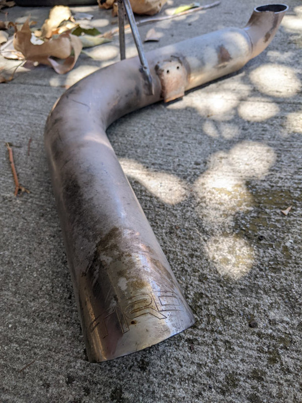

    Azusa, CA
    Not really, just has a throatier sound to it than a stock header v6. It was a lot louder when I had this on it, cut it off for my axle dump a few years back. Was getting too friendly with rocks

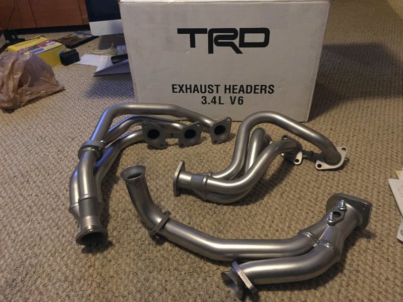

    image.jpgthese are the headers (found picture on another thread)
    do you have these headers? so I imagine that you do have trd headers if you have a TRD tail pipe but headers come right off the block

    Yes I have the TRD headers, I just mentioned the exhaust tip because he was asking if my truck was loud.
