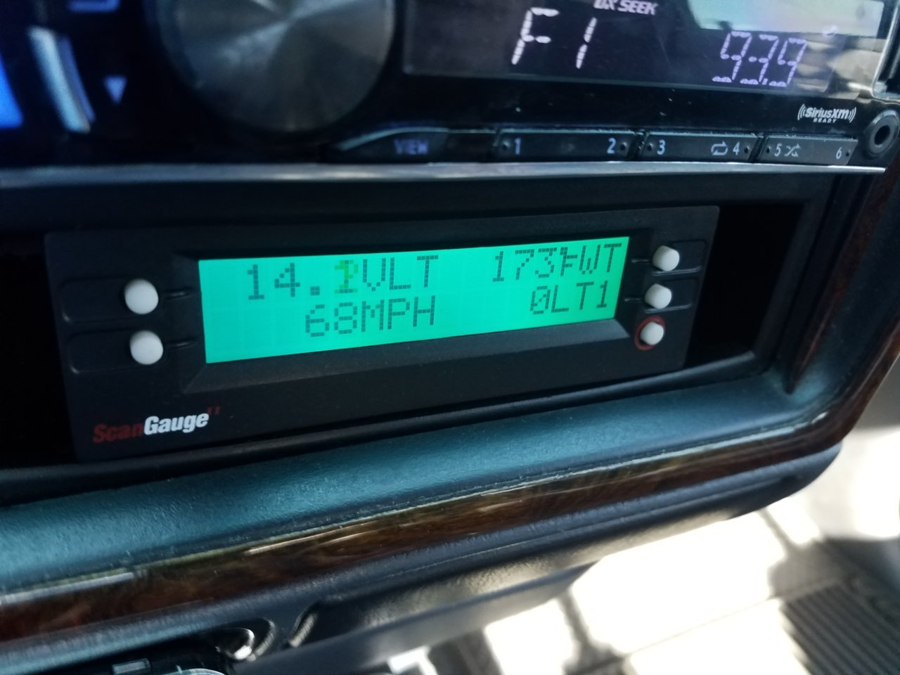

    On my screen I keep the long fuel trims as one display on all the time.
    If the fuel trims get out of wack there are a dozen different reasons that can cause this so
    you will know when your engine is off beat

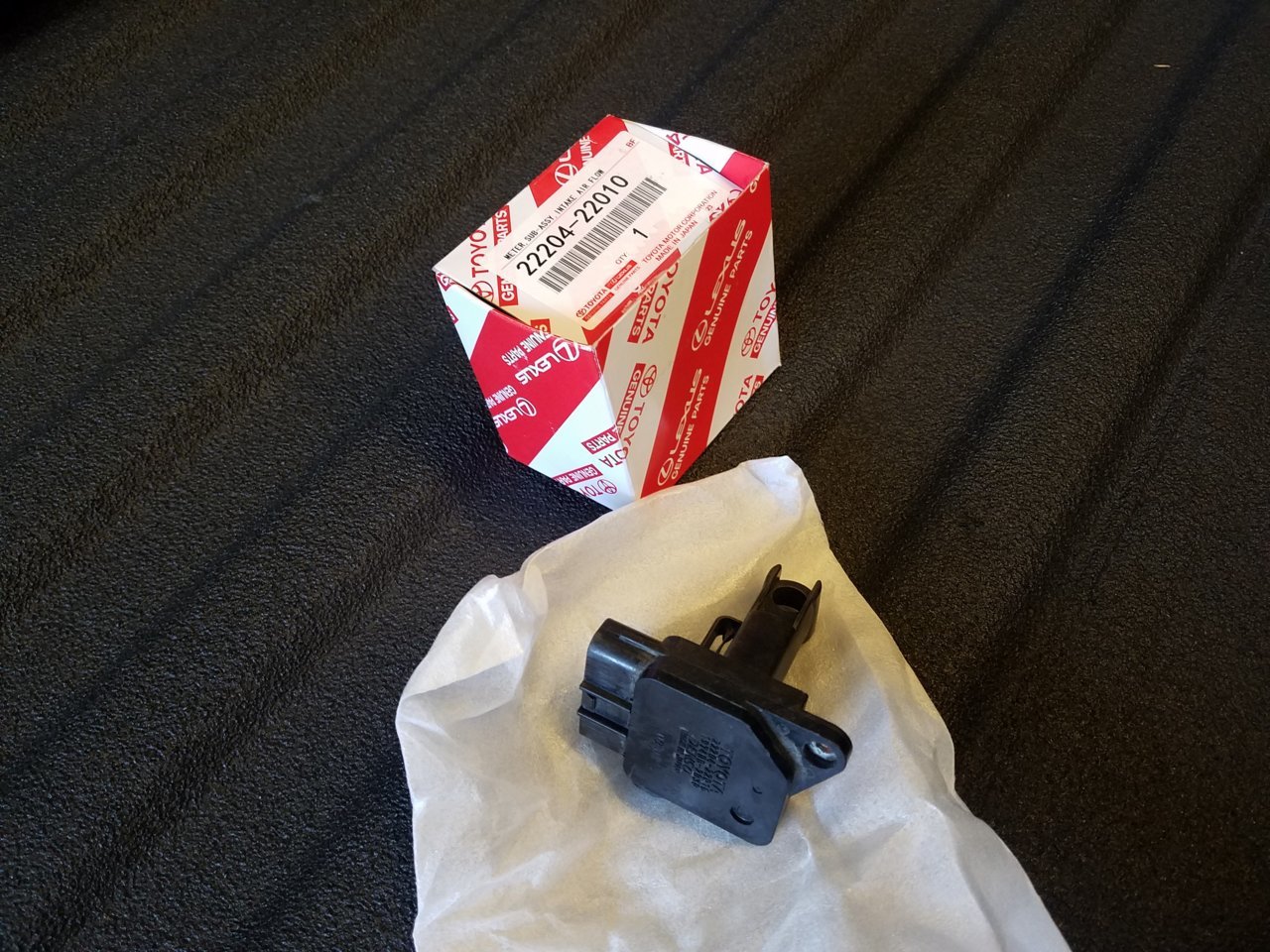

    Was a bad MAF sensor, fuel pump pressure tested at 46 psi, so the fuel pump is still running great,
    Specific range is 44-48, so it’s good!
    Long term Fuel trims at speed are at zero again.
    Alls golden again that’s to the scanguage catching this early.

    Did they put a new OEM MAF in for you, or did you order one?
    I've been getting abysmal gas mileage lately (worse than usual)...like 14mpg lol. I'm going to clean my MAF and hope that helps. My LTFT numbers are within -5 to 5 so I don't think I'm having any real problems but it might just be a combo of a few minor things.
    I had a new MAF put in about 3 years ago, but the truck has seen quite a bit of dirt and dusty conditions since back then.

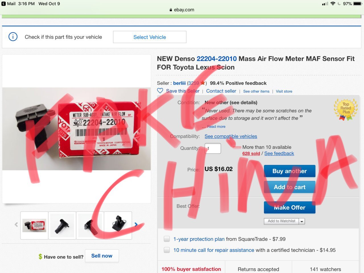

    UPDATE, I. PRETTY SURE THESE ARE FAKE DENSO AS MY TRUCK STUMBLED AND BUCKS ABOVE 4000RPM, SO I PUT THE OLD ONE BACK IN AND IT RUNS FINE AT 4000rpms.
    I ordered two, one as a spare off eBay and took one over to the dealership to put in just in case.
    Of course they had finished doing the fuel pressure test and smoke test.
    But at least I know what the numbers are now and no vacuum leaks and not worried about the fuel pump anymore and it WAS the MAF.
