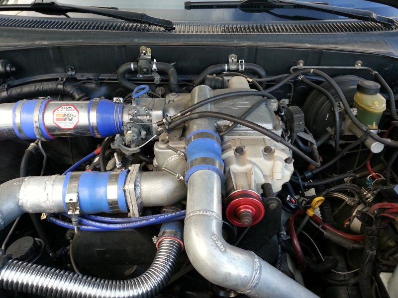

    No, though honestly I think that one pictured would be more effective (less flow resistance, much more cooler capacity). The one I saw back in the day the guy took the gen 1 apart and did some machining to fit a trans cooler inside + tubing, tank, pump, external cooler etc, making it an air to water setup just like OEM Magnusson for later gens.

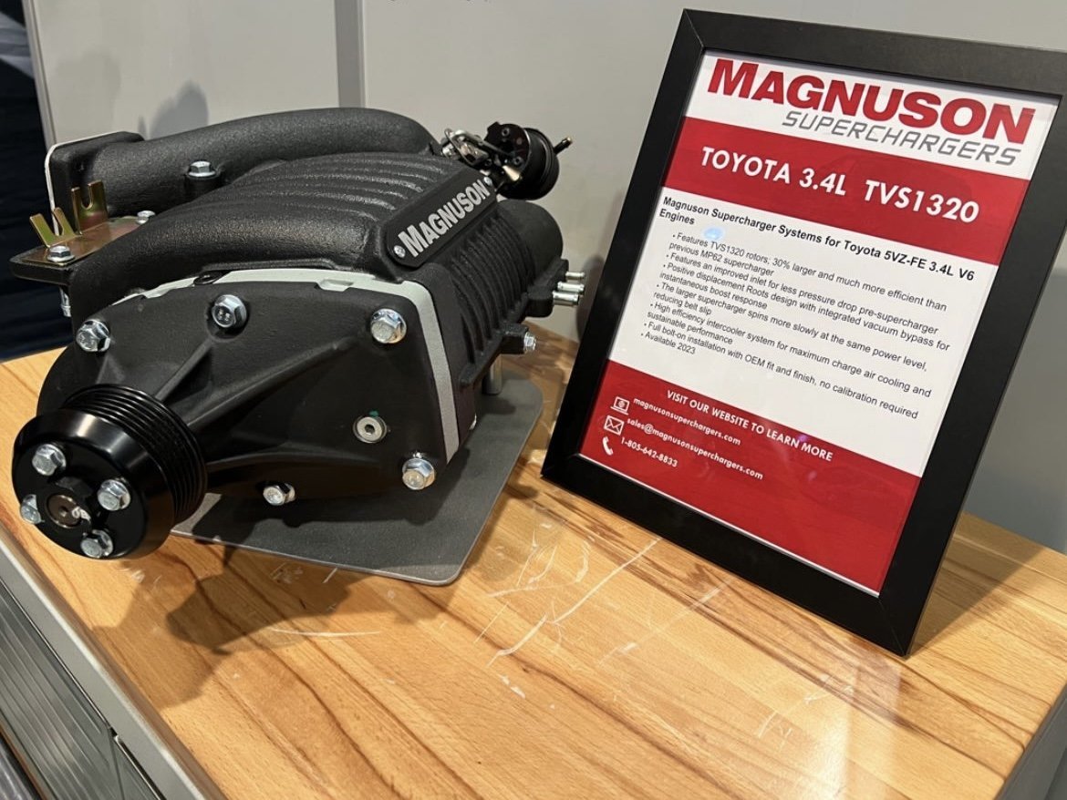

    Updates from magnuson
    The forthcoming TVS 1320 for the Toyota 5VZ-FE 3.4L V6 is not being introduced as a way to build more power than the MP62. The current generation system is a massive success, so much so that the casting tooling is nearly its end of production life. So the decision was made to create a new generation to switch to a more available and modern TVS rotating group. We are still aways from production on the new unit, but when it is released it will be making the same boost levels as the current unit. That is because that is what we feel this motor will safely handle over its usable life. Also, this will hopefully allow us to more easily keep the new unit CARB certified as well, but we will have to see on that. The 1320 is a larger rotating group so we will be slowing it down to keep boost where we want it compared to the MP62.
    the next generation unit with the TVS 1320 does have the potential to go further both on boost and efficiency. But as you already acknowledged the engine needs to be able to support that added boost. The Eaton TVS technology is OEM tested and established for its durability and efficiency. We are excited that the 3.4L marketspace is still so vibrant.
    Best regards,
    Magnuson Superchargers
    Customer Support

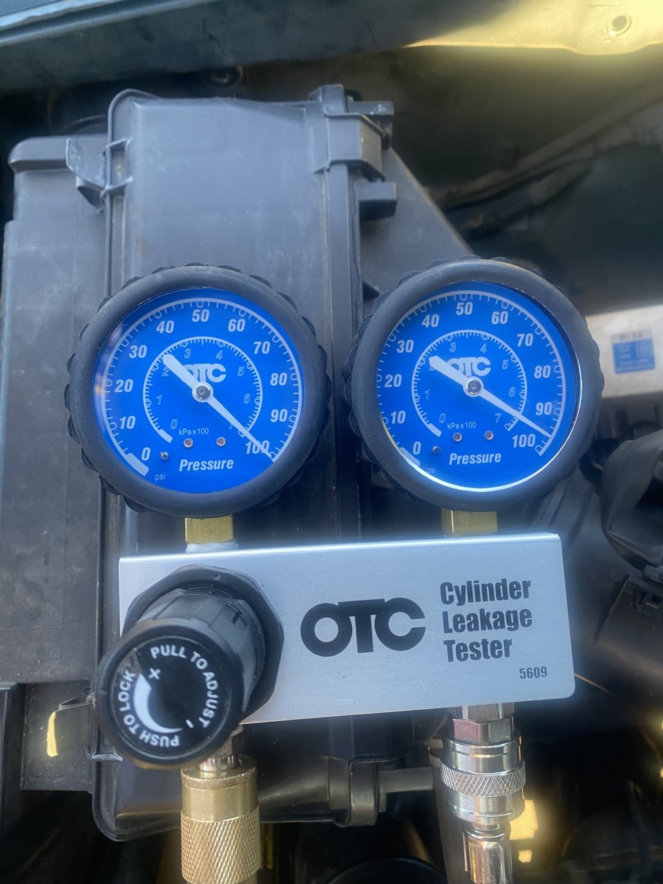

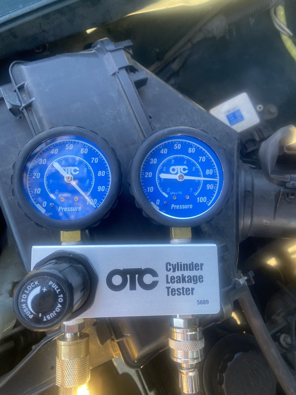

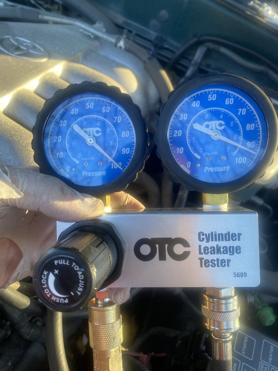

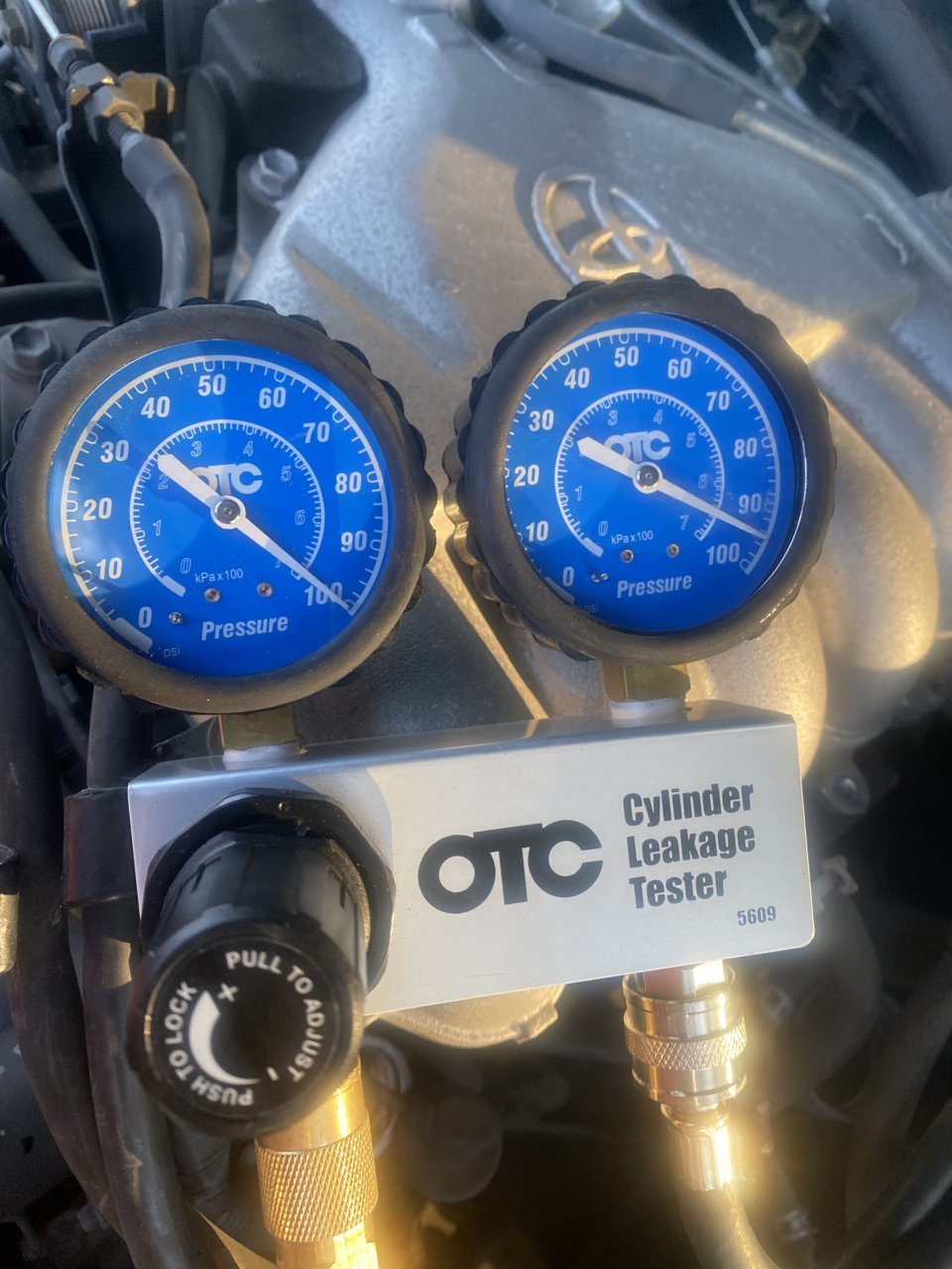

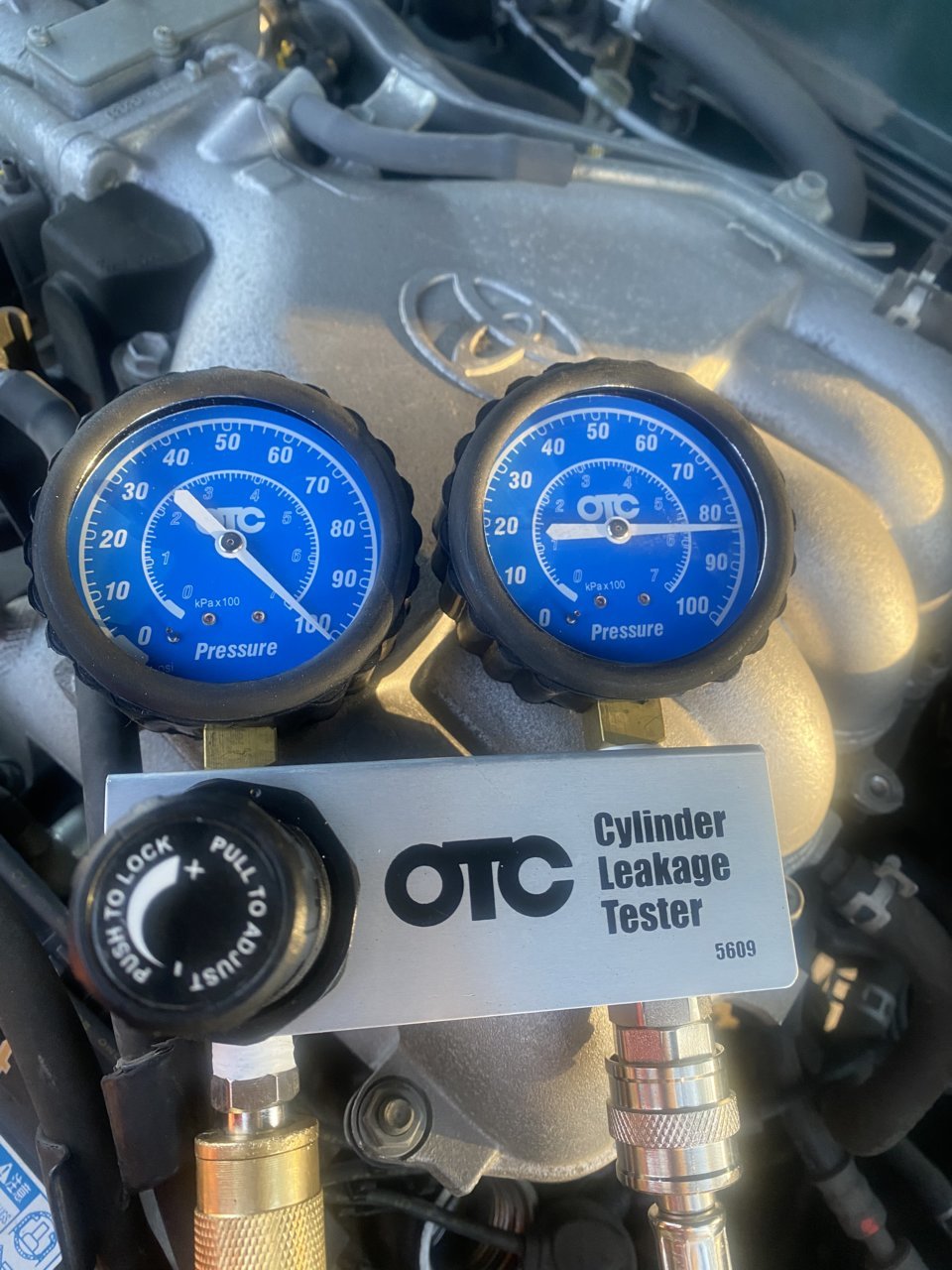

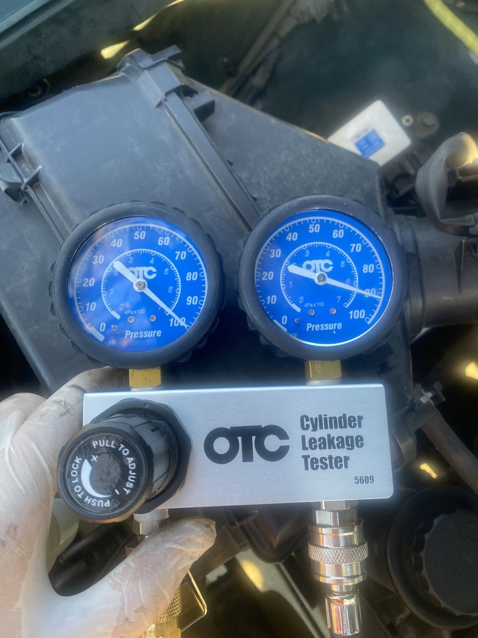

    Still in the prep phase for my s/c install. I ran a dry compression test and leak down test. On compression Cylinders 1,5,2, and 6 all came up 210psi. Cylinder 3 was 190psi and 4 was 201psi.
    On leak down my results were:
    Cyl 1: Leaking to the crank case.
    Cyl 3: Leaking to Cylinder 1
    Cly 5: Leaking to crank case.
    Cyl 2: Leaking to crank case.
    Cyl 4: Leaking to Cylinder 2.
    Cyl 6: Leaking to Cylinder 4.
    Not great results, but better to know now than to find out after I start F/I.

    You sure you had valves closed on the cylinders that were leaking into another. If you did and it's a true leak from head gasket. It would run like shit. Also your compression wouldn't be that high.

    Reasonably sure. Found TDC while adding pressure to the tested cylinder. Once I could add pressure without holding the crank, I recorded the result and the leakage. I can re-run the tests to see. I was thinking about doing so anyway just to be sure.
