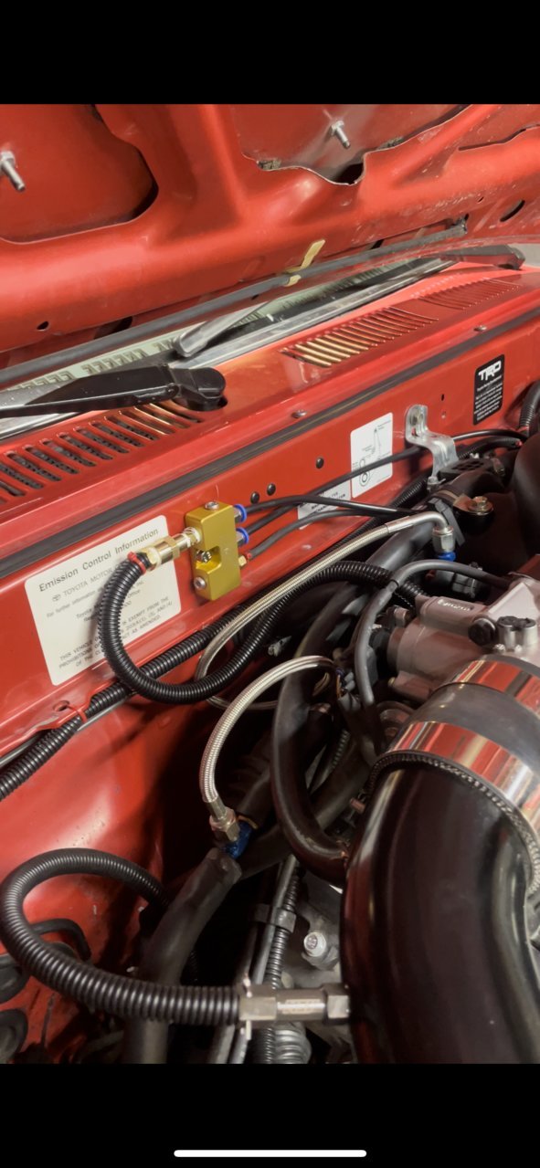

    Hi all, So I ended up working on ALL of my boost lines today. I took a good 4 hours and installed the Damond Boost junction. Its nice because it comes with 7 ports so If I ever need to tap into it with something else, I can easily add or take away things as well. For anyone with a 3.4 swap in a Pickup generation truck, I think it is essential as you cannot get to ANYTHING without a big fight. I guess the argument could be that you are creating more places for a leak, but I didnt feel confident with any of those plastic "T"s.
    Essentially it mounts wherever with one bolt. I used a thread that was on the fire wall. You can tap whichever connector you want. I went with the Push connectors after researching a TON of racing and turbo sites. My thought was if its good enough for them with 15 pounds of boost, its fine for my use. They are amazing as you can pull them out if you need to get to something else. The only pieces I used rubber tubing was the outlet that goes to the stock FMU since its that little nozzle thing. In the back of the supercharger I just took out the 1/8inch barb and put in a push connector. I ran one of the plastic press fit tubes to my boost gauge through the fire wall, I then T'd off of that to go to my AEM water meth controller.
    The only other one that I had to go with the rubber vacuum tubing was for my URD 7th injector. I figured it was fine and I'll live to fight another day and change it out when I'm redoing something in a similar area. Here are the photos, it looks good and is simple. I know there are a lot of cheaper ones on Amazon but I just figure you get what you pay for. Oh and ignore the long ass barb, I couldn't find 1/8in NPT to 1/8 inch barb at my local Home Depot and didnt want to have my daily driver down for 3 days while I wait for the new on in the mail.
    Now for the results. I am now getting about 1 pound more of boost from this setup. Also It took care of a small buzz I was having I assume from the boost. Also, my response time seems a bit zippier. This could all be in my head.
    So currently 8.5pounds with a 2.2 Pulley, URD crank shaft, Idler arm etc.
    I'm still convinced that I'm getting SOME belt slip and Im thinking its the position of my larger alternator putting the dynamic tensioner pulley in not quite the right position. This is after reading like 50 pages from this forum where some others were having a similar experience.I'm wondering if I need to play with that position, but I dont have much choice with how large my alternator is. If I am feeling inspired I might remove it for the stock one to see if that fixes anything...
    Anyway, I'm pretty happy with the boost junction box, no more screaming while leaning over my engine when I do ANYTHING with my boost hoses.

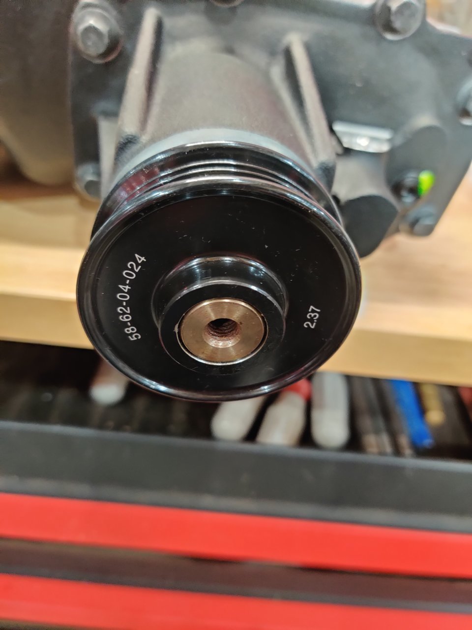

    Well, I purchased my supercharger a year and a half ago and it came with the press on to my dismay. Magnuson said they would only make them that way from now on but now I've been seeing them with the bolt on. Also I see URD has complete nose cones for around 700 dollars so I suppose if that ever needed rebuilt I could go back.
    I just purchased the URD 2.2 and had a machine shop match the existing press fit. I took a heat gun and heated up the new pulled, and then it slipped on with a pulley installer from another generation supercharger. It was pretty easy and I havent noticed any problems. The shop charged me 80 bucks because he said he couldn't justify charging me more than the pulley was worth. Thus far its worked quite nicely and I'm at about 9.5 pounds of boost. There is a part of me that is curious if a design like that could ever slip, although I know a lot of other chargers use this design.
    Anyway, pull your old pulley off, take it in with the URD, and there is enough space for them to machine a hole in the pulley and it should slip right on. I would suggest using heat to remove and install, and then a press fit pulley installer from URD and it pops right on.

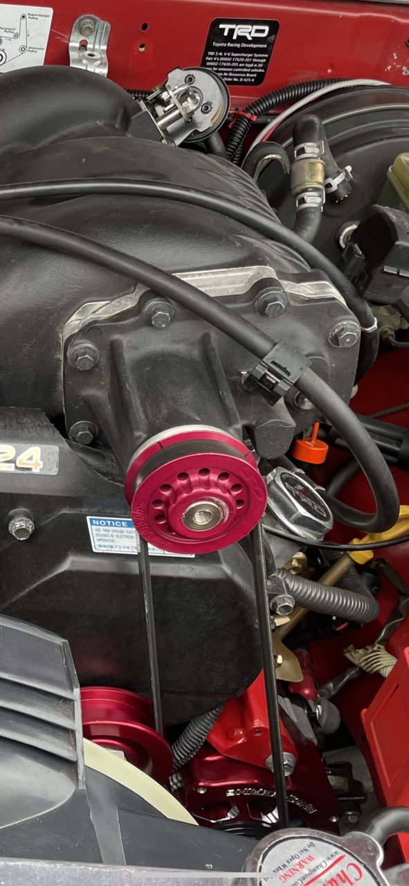

    IMG_4701.jpg This is it installed. If anyone has any thoughts on why this wouldnt be a good idea let me know, hahaha. It was a suggestion from gadget.

    as a note, since Im a bit of a freak, I marked its position with a sharpie and it did move for several months and then I felts like it was good to go and erased it.
