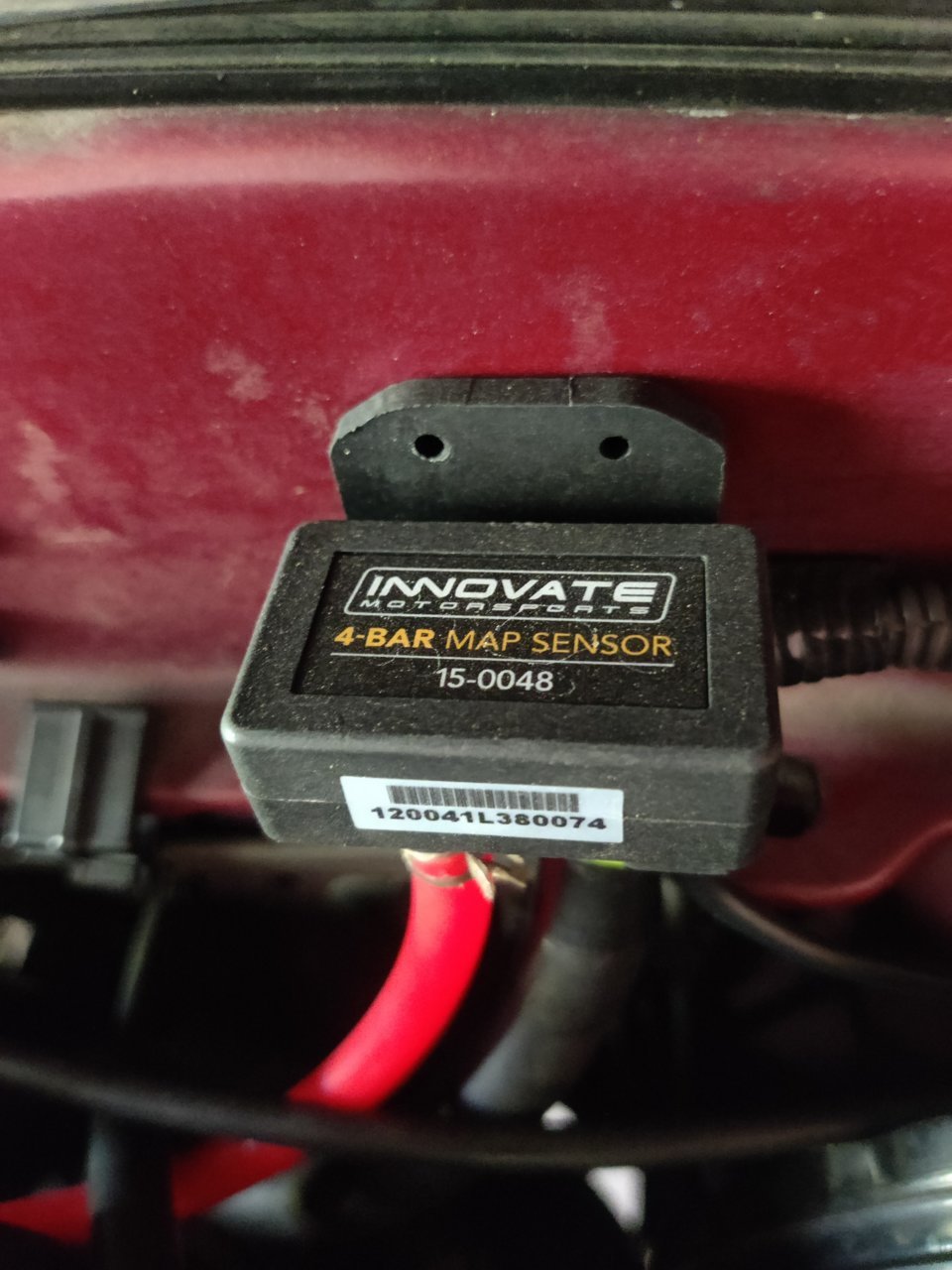

    Ah dang I didn't see this post until now, but I do have the correct MAP sensor. It arrived today so I'll probably go install it later today.
    I run around 188-195º and I have the Corolla thermostat. Currently hot as beans here in Texas.
    Hmm...Wonder which position my jiggle valve is in. I NEVER see temps in the 160s

    Update. New MAP sensor is working as it should. Old one must have overheated itself

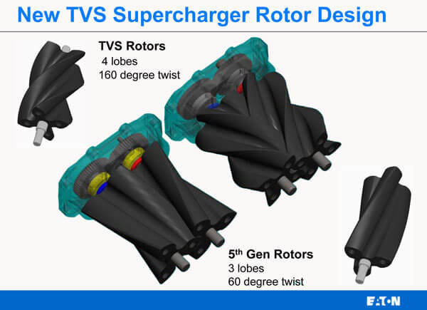

    I'm excited, the 4 rotor lobe design instead of 3 lobes is definitely a huge upgrade and from 60 degrees to 160 degrees twist and
    Thermal Efficiency %: 70+
    Parasitic Loss (MAX): 20 hp (aprox)
    Pressure Ratio: 2.4
    I'm just hoping the new design 2 piece pulley doesn't come back over the snout limiting the size of a smaller pulley because at 6000 feet I'm going to need a smaller pulley.
    The one piece pulley of course it's not an issue.
