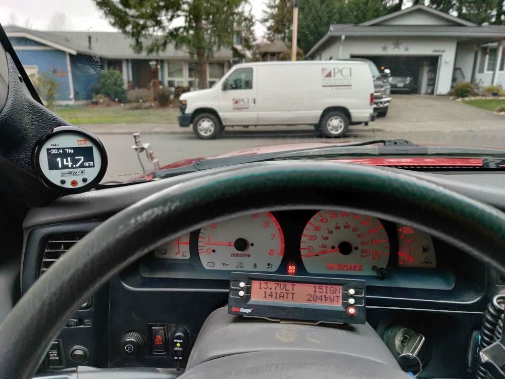

    I run the PSB-1 and like it because it is a 2 in 1. I will say that I've had to replace the wideband O2 sensor once.

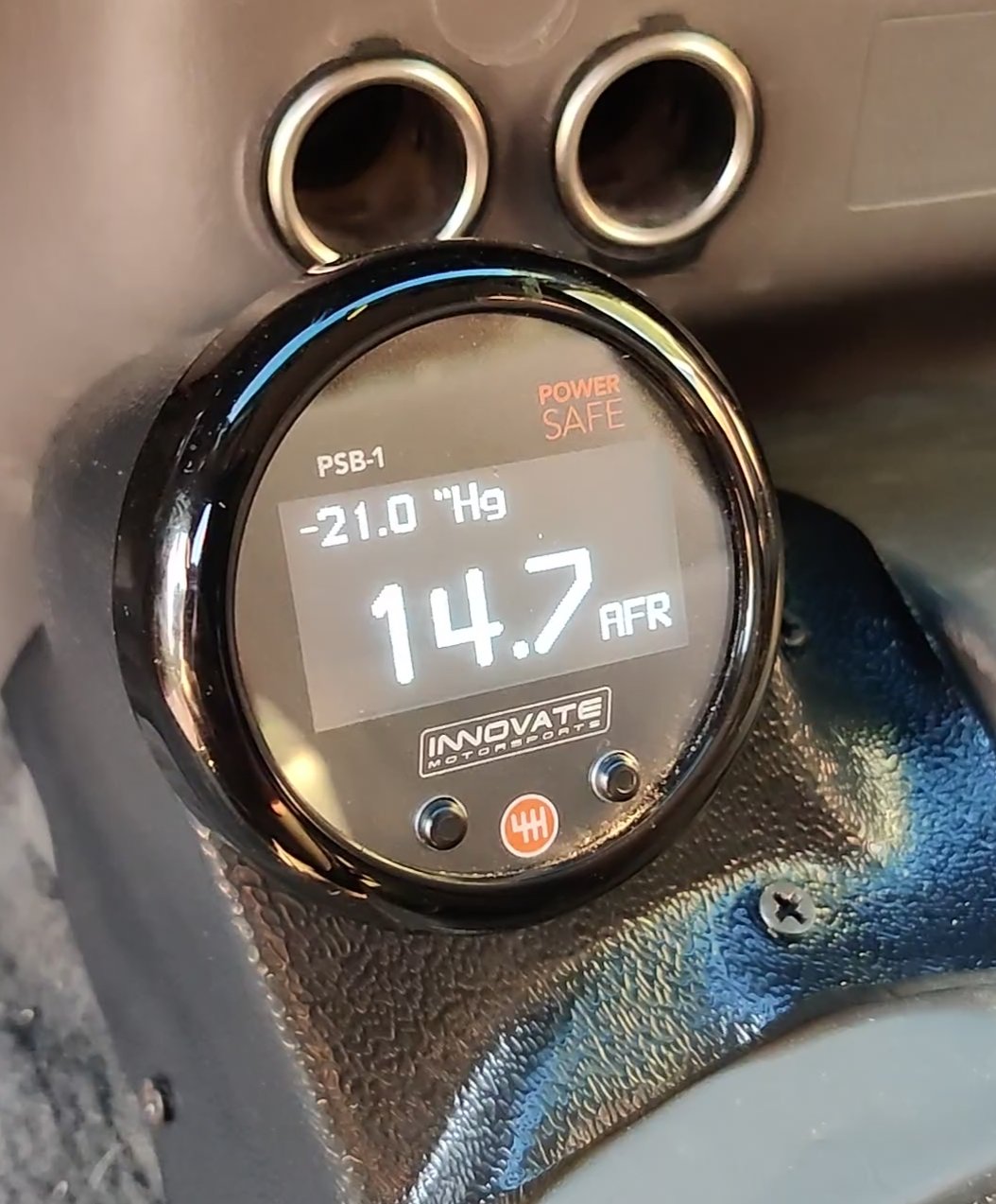

    I also use the PSB-1 guage. I've been happy with the guage even though I had a couple issues that were my own fault (I may have fryed the 02 sensor by driving around for a couple hours when it didn't have power due to a faulty connection I made so I can't blame the quality for the malfunction).
    I do get an E9 error code from time to time on the PSB-1 but can't seem to find anything that mentions what the error code means. The manual only mentions an E2 error of the O2 sensor isn't plugged in.
    I've also had a couple times where the AFR stops reading and goes back into a heat cycle.
    but when it's reading it appears to be accurate
    It can be hard to read both displays at the same time but I leave mine displaying the AFR on the bigger section and can press the left button twice to show me what my max boost was after the fact. AFR for me is more important, the boost number is safer to view while the foots not in the skinny pedal.

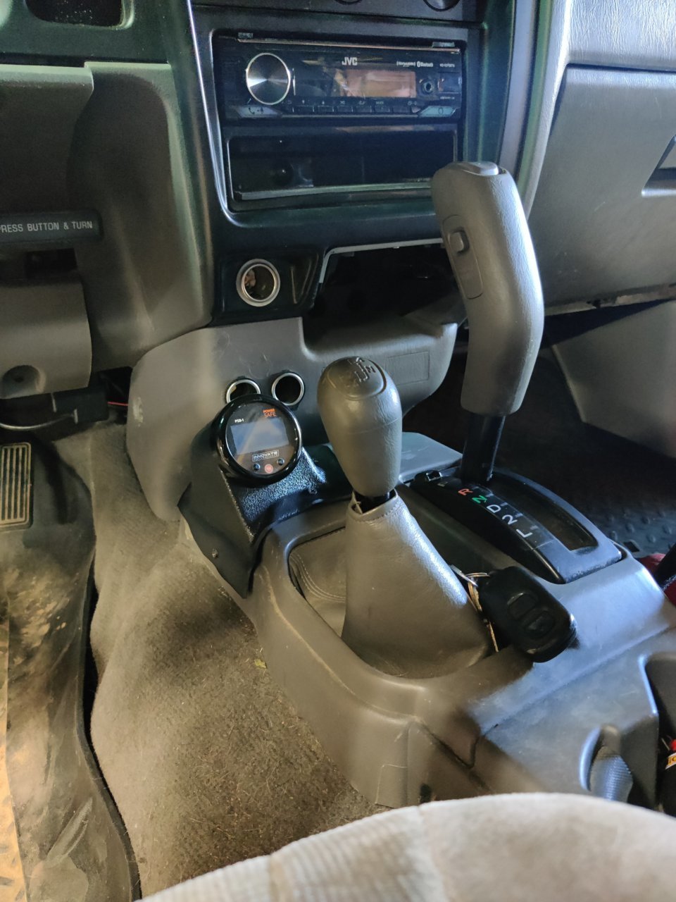

    I took a cheap A pillar mount and molded it to the center console with a heat gun. It's a little crude for a first time attempt but I like not having it in my face especially since the dimmer feature it's wired up yet
    I can still access the outlets even though I've never used either of them.
