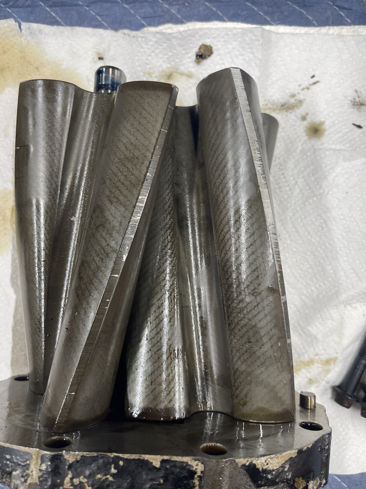

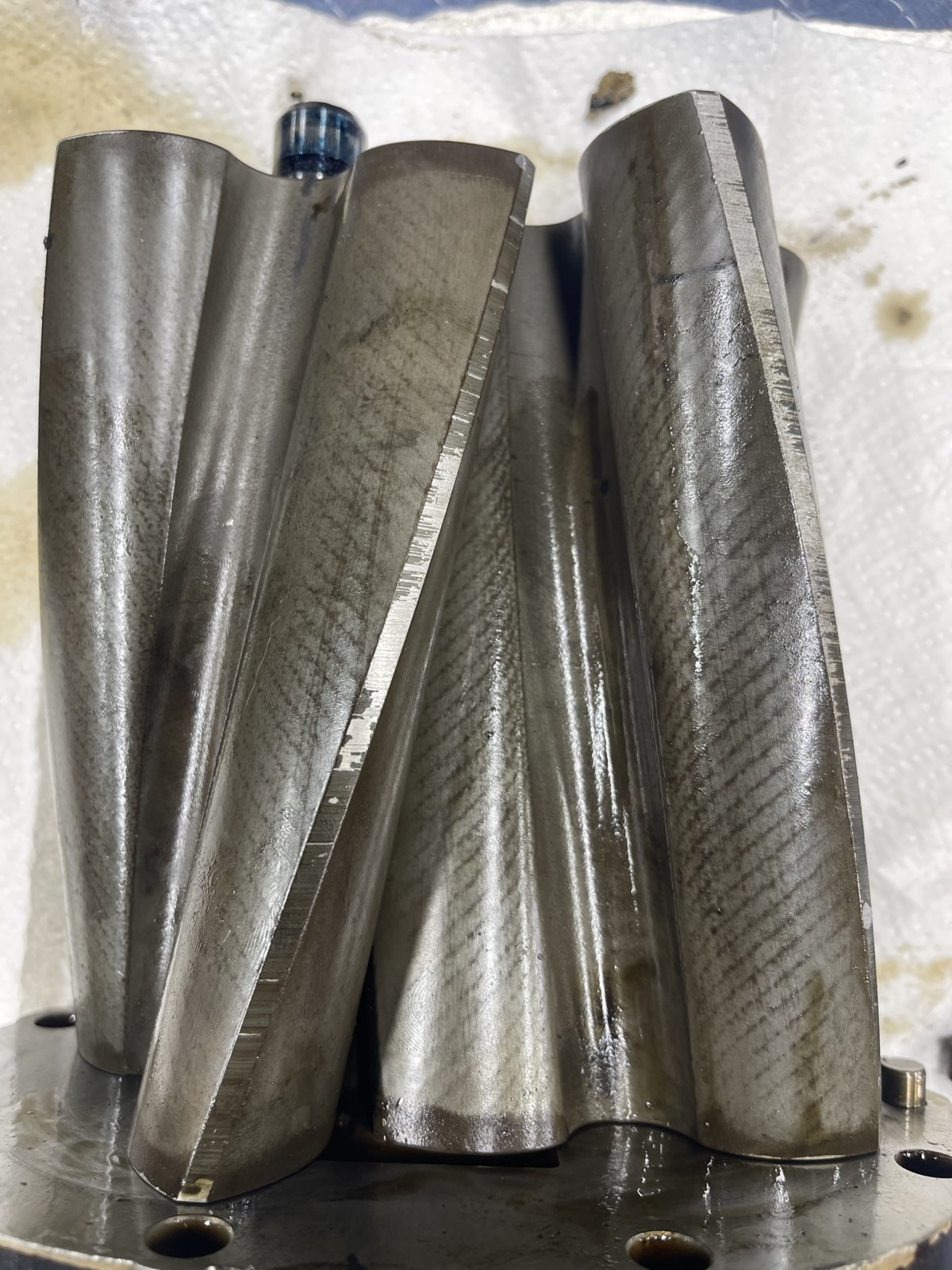

    How do these rotors look? I’ve seen a lot worse online.

    What are your thoughts on the pics of the rotors?

    Those rotors look pretty clean to me. I would run it as is, personally

    Thought the same thing.
