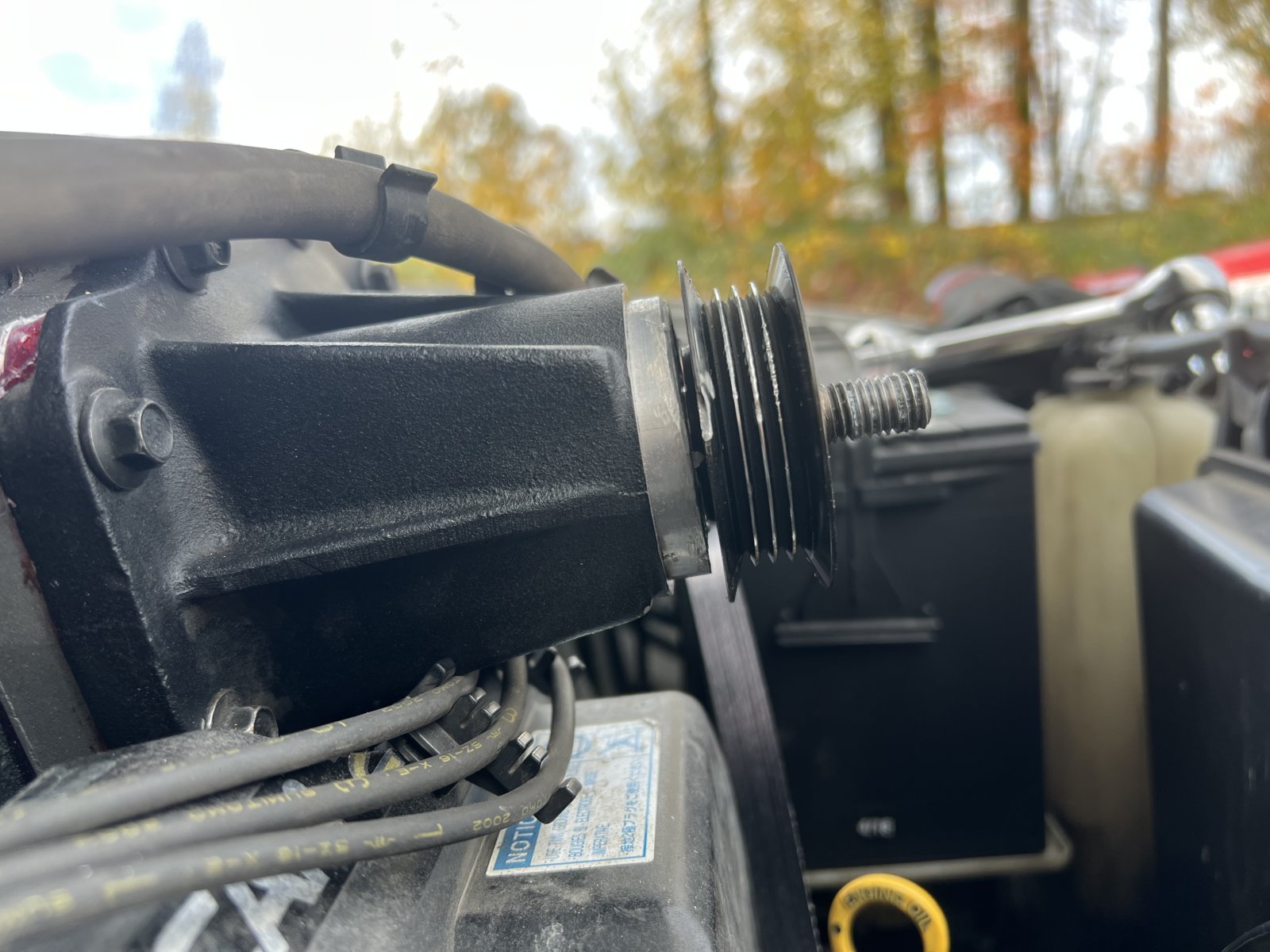

    Hello all
    I recently bought a used black trd s/c and replaced the rear needle bearings, nose cones bearing, coupler and seal. I didn’t hear it running before I bought it and upon start up she rattles pretty bad. Wondering if this is a rotor plate issue or something else. Full disclosure when pressing the nose cone back together I forgot the spring so I pressed it back out. Im not 100% but the pulley does look like the bottom is sitting closer to the snout than the top. I’m wondering a few things
    1. did I screw the bearings and need a redo. The nose spins smooth
    2. The pulley shoulders on to the shaft but looks like I need a spacer or something as seen in photo. I temporarily used washers.
    3. how do you check the rotor plate.
    sorry for the long message but this has been causing me severe agony lol. Should I just buy a new snout? Send to Jon bond for rebuild? Rebuild snout?

    You installed the pulley the wrong way!

    Hahah I was wondering about that. Is there a spacer or anything that is needed cause all the videos I’ve seen there is none

    No spacer. The pulley is keyed, but is also tapered so the pulley should line up with the other pulleys better once it is corrected.
    Install the pulley correctly and take a pic. There should be 1-2 threads on the shaft visible after the pulley nut is tightened.

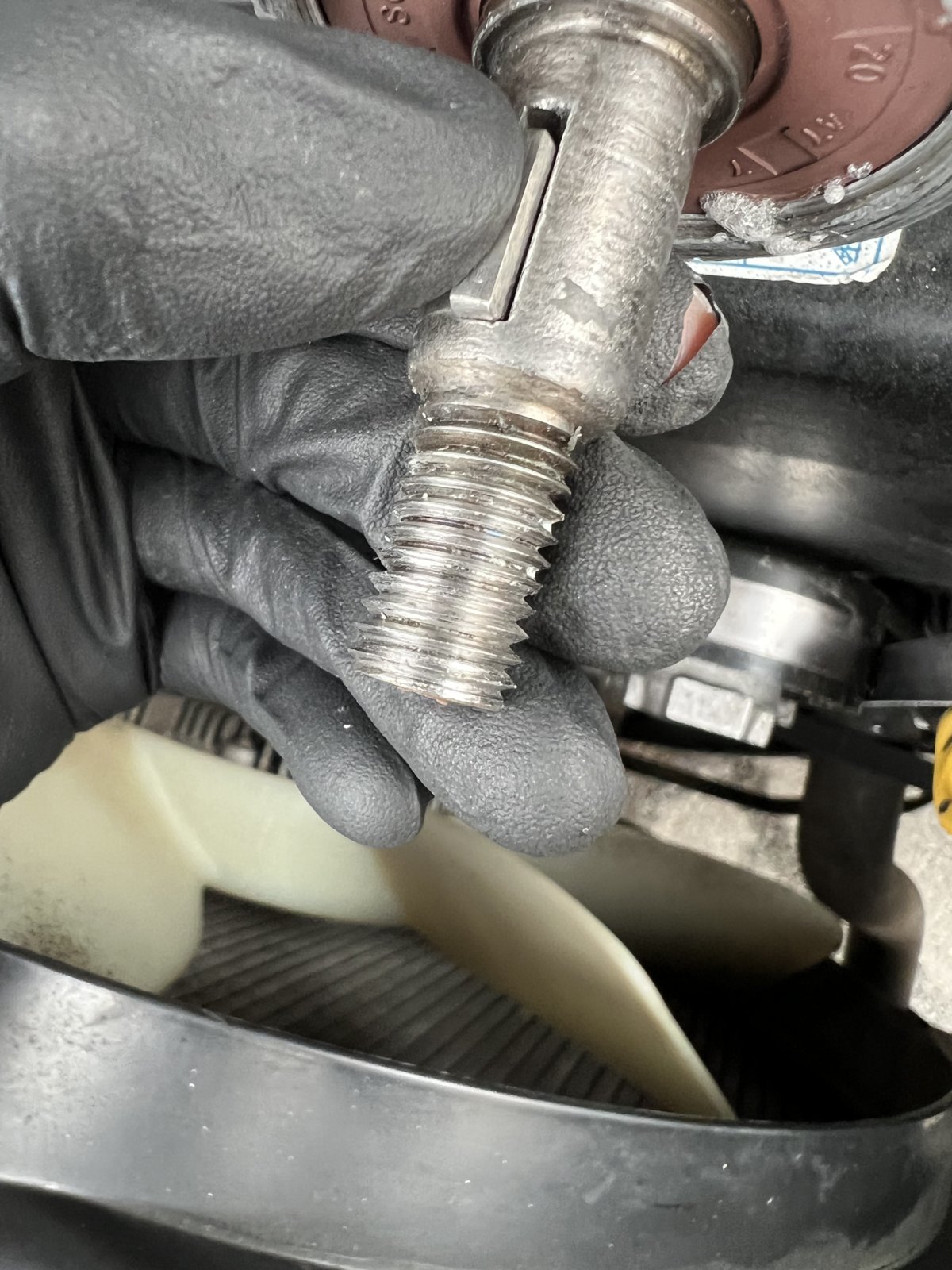

    Ok here is the photo of the pulley on the right way. There is still a gap that the bolt won’t fit over without a spacer of some sort. Also is the woodruff key supposed to fit this loose?

    The key should be the near exact size of the cutout on the shaft.
    You sure your shaft is plumbed all the way in after the rebuilt?

    I mean the pulley doesn’t contact the housing. The pulley makes full contact with the shoulder. Like the pulley thickness looks not right compared to other pics I’ve seen. I’m gonna start with the woodruff first and use a washer to space the shaft nut and see where it goes. The pulley itself is in pretty rough shape so I’ll probably just get a new one. URD is the only one I see selling the stock 2.37. Unless someone here has a decent one to sell.

    Either the pulley is shot, or the shaft isn’t fully pressed in. The shoulder of the shaft should not be visible when the pulley is seated/installed.

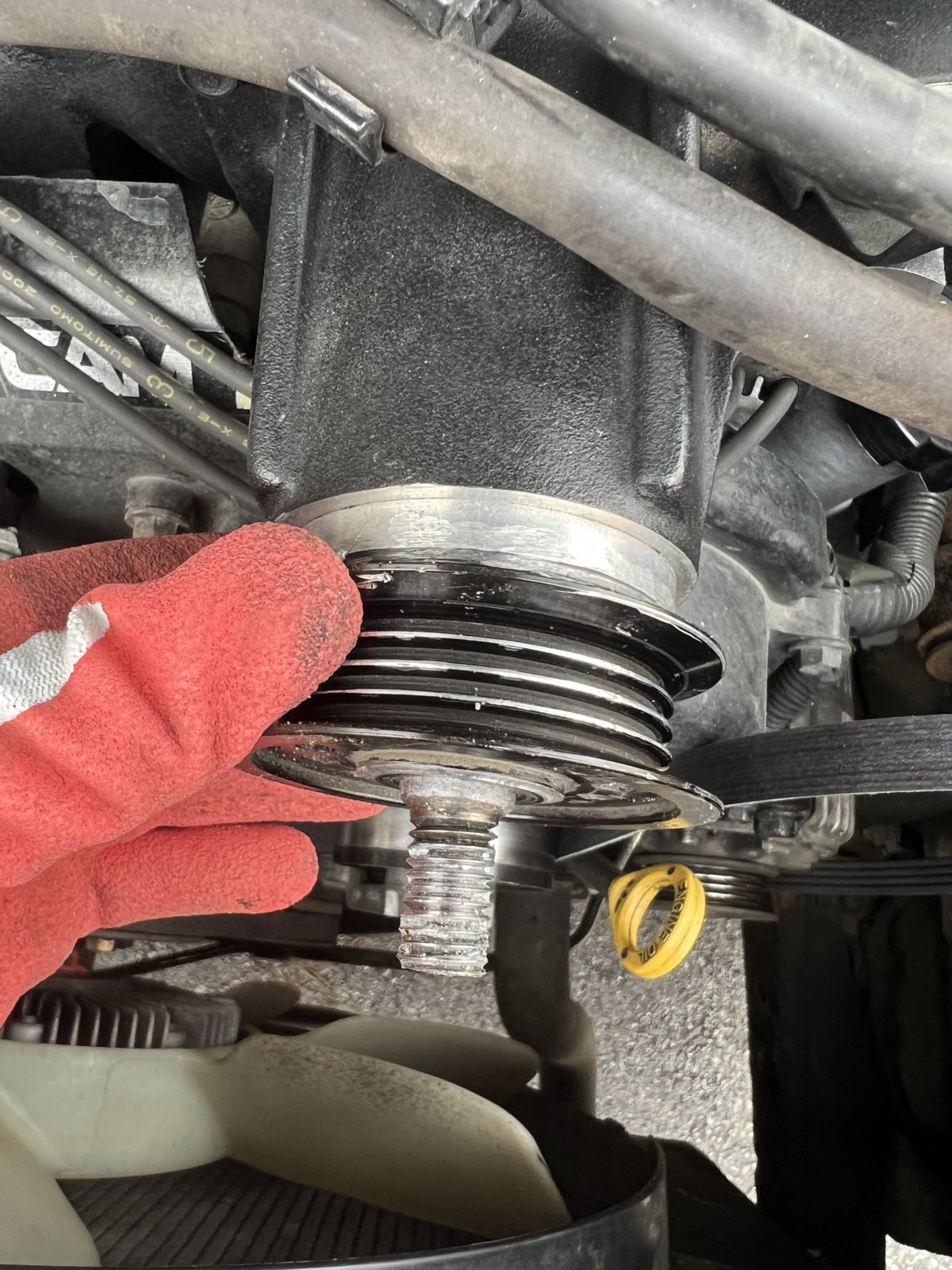

    That pulley is definitely shot, chips and nicks everywhere

    Well got the new pulley on and still making noise. Pulled the charger and there’s clean oil all inside the charger. Guess I need to do the rotor pack. That’s my luck to get a bad S/C. The pulley that came with it must have been wrong and there was a spacer hence the cut woodruff key and a wear line at where the key is. I’m slowly getting there lol.
