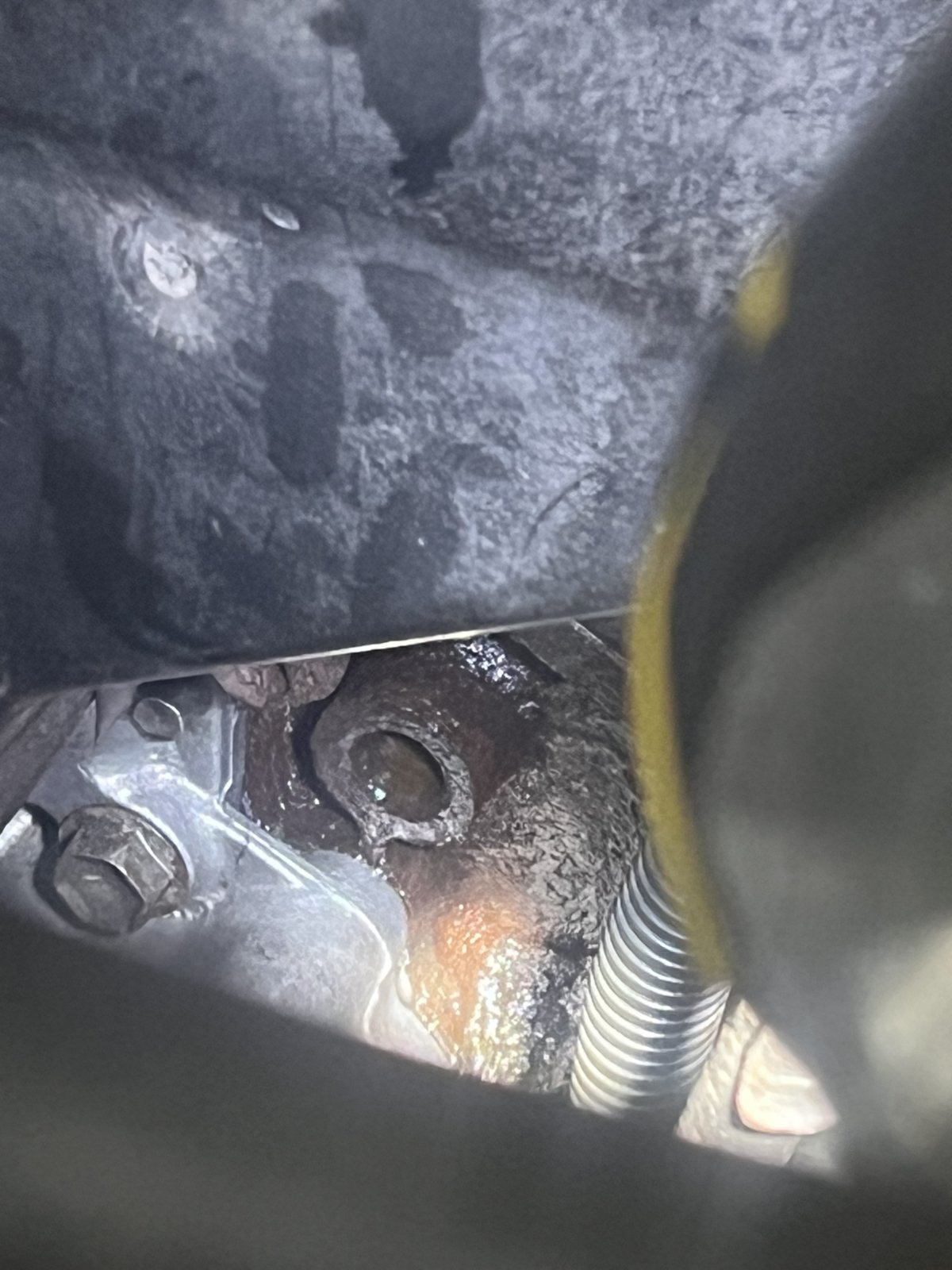

    Ran into a major problem when installing the SC. The long bolt for the dynamic tensioner goes into the tapped hole in the engine block.
    Mine had never been used since 2002 and had been caked in rust/road grime. When cleaning out the hole, the threads came with it.
    Had to drill it out with a 13/32 bit and HeliCoil it back to M10x1.25 to get the dynamic tensioner to work on my block.
    Don’t know if anyone’s done this before, but just wanted to confirm it DOES work for those who never would have thought this would be a problem or who run into it down the road.
    Test drive was successful after the installation was complete. I will update if it affects the dynamic tensioner down the road.

    That would be the proper way. My threads got all messed up and in a pinch I jb welded a stud into the hole and nutted the tensioner onto that.

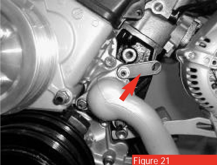

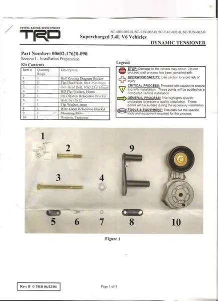

    I'm missing the "Wire loom relocation bracket 00602-17620-077" for my SC swap. Does anyone have the measurements for it? What's the biggest difference between the original one, perhaps the mounting holes are extended a bit or the is it only the edges have been trimmed off? What are some solutions if I can't source/make one and would it be safe to have the wire loom hanging without it?

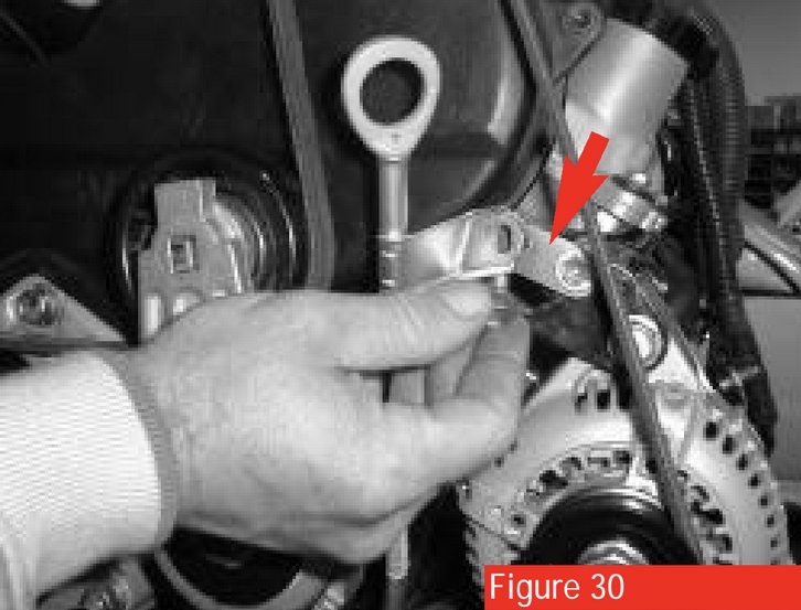

    That bracket is used to relocate the dipstick tube away from the tensioner when the belt is off. You can install the tensioner and measure how far it needs to be relocated. I don’t have my truck with me, but my guess is that the holes are about 2” apart.

    I think you may be referring to the "Dipstick relocation bracket 00602-17620-0078" (#5 on the image below or figure 30 in the TRD installation instructions). I have that piece but I don't have the #8 (figure 21 in the TRD installation instructions) which is for the wire loom, not the oil dipstick.

    Ah yes. That piece holds the wire loom away from the tensioner and pulley. Just zip tie it away and you are good.

    Hm, gotcha. I think the main difference of the wire loom bracket is the trimmed down edges so it would clear the tensioner bottom mounting hole and bolt. I'm just gonna cut my original bracket and hopefully that should be good, if not then zip tie it away as you said!
