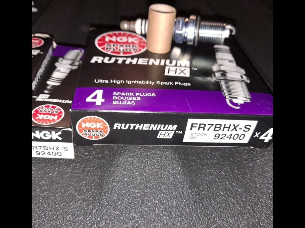

    Working on a new to me ‘01 double cab with a supercharger. Still catching up, reading through the thread to gain knowledge.
    I do have one question before finishing the thread. What are the go to spark plug wires for the SC? Changed the plugs from Denso PK16TR11 (duel electrodes, seem to have been in it for a while) to the Denso IK22 and found one of the spark plug boots was torn and PO siliconed it back. Ugh. Would the NGK be fine or is there something better suited? The ones that are currently on there seem a little short compared to my other 3.4.

    NGK are great quality, been running them for a while, they've been working with my IK22 just fine as well

    I’m coming up on 800,000 miles of supercharged miles on my 3.4. the stock OEM plug wires have always been my go to choice.
    They are actually stamped with a date code on them and never had any issues.Typically I change them every 100k.
    The IK22 work just fine, personal I’ve had better results with the RUTHENION (these are two step cooler) These will last
    longer than the IK22s but either work just fine.
    The stock duel electrodes don’t work with the supercharger and you probably will end up with carbon tracking on the spark cables and plugs in time or a cracked plug.

    Thanks for the info, definitely seems promising. Looks like I'll be shopping around now!
