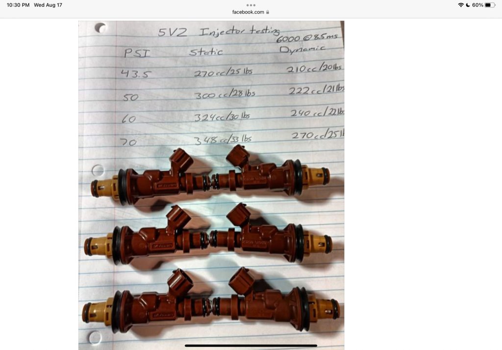

    FMU works only in boost, stock fuel pressure is 43psi, FMU 3:1 will raise that up up to 70 psi as shown here by snpspeed.
    He did a test on the 5vz, so the 270cc injector turns into a 350cc injector and that’s why you need a high output fuel pump.
    It works actually very well. I have probably close to 200k on snpspeed FMU. Before In had the trd FMU before but it was inconsistent
